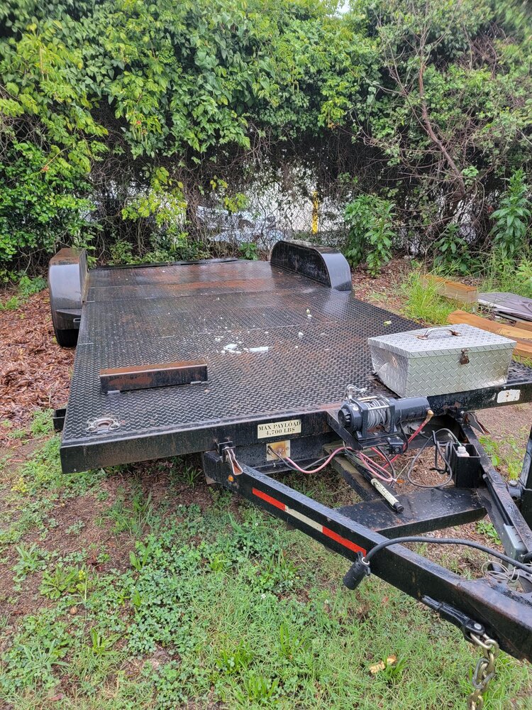

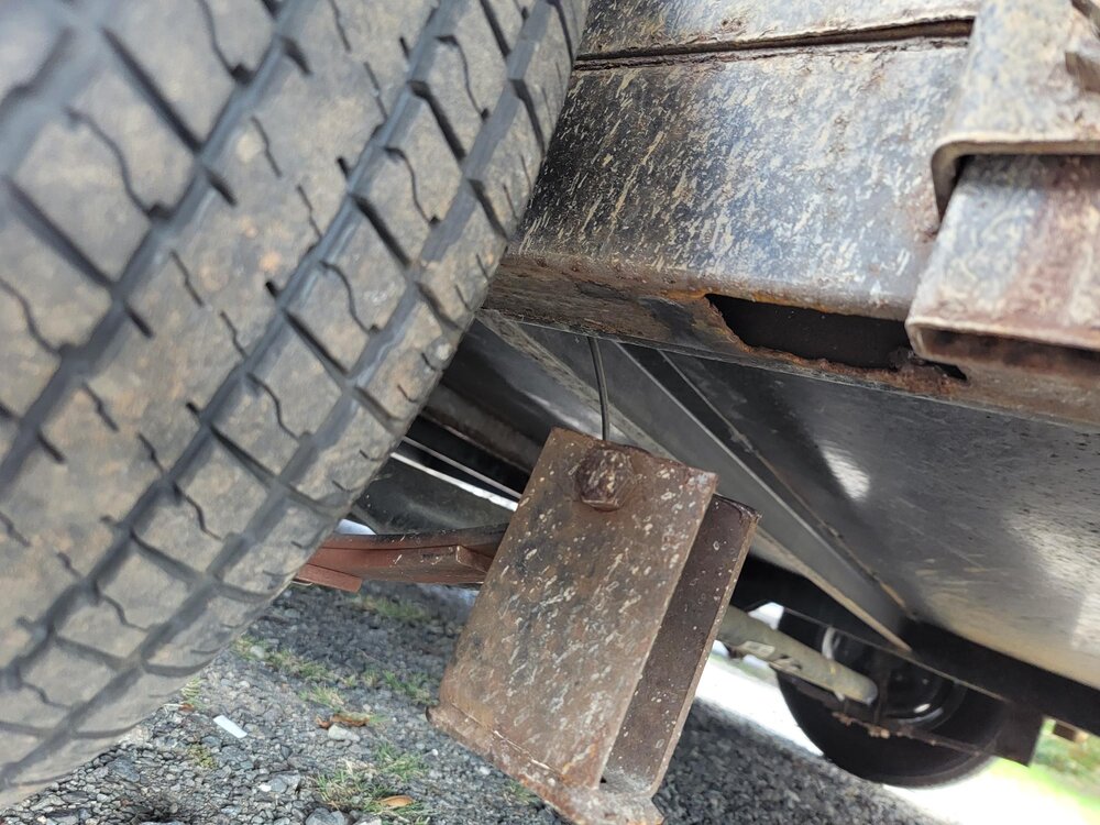

Our company trailer is showing its age, (Due to no one taking care of it, and being overloaded) Last year we put new axles under it fixed all the wiring.
Last month it was overloaded with a metal trash bin and two pallets of screws. Hanger broke off. (fixed that)
We use it primarily to move scissor lifts and material. Occasionally a broke down work truck in Charlotte or van in VA (few of the times it was way beyond its capacity)
It is about 10years old, Tilt metal deck 7,000lb car hauler. I suggest we buy a 10,000lb trailer and tell everyone it is 7K so it only gets overloaded once in awhile.
Any recommendations on manufacturers? we would like something a little overbuilt that will last, but not break the bank. It will live a hard life.

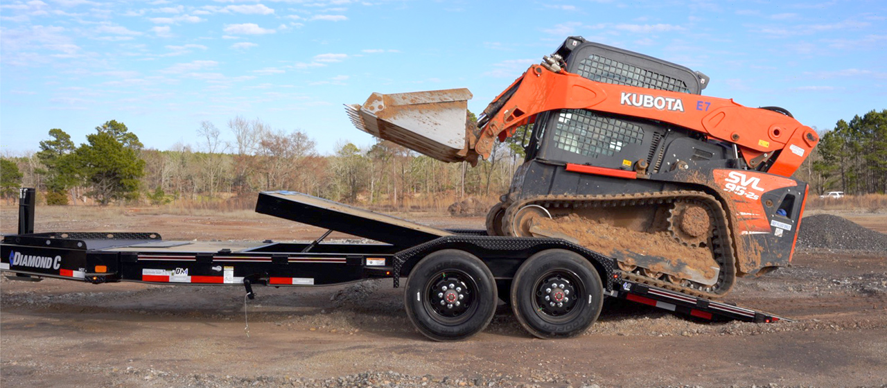

Oh...and if for whatever reason baller budget comes into play. Diamond C ftw

Diamond C is probably the mack daddy.

Diamond C, Load Trail, Corn Pro, MaxxD, and many others make a MUCH better trailer than Kaufman and the other low cost, high volume guys. The PJ and Big Texx trailers seem to be somewhere in the middle. Mass produced and not as heavily built as the top names, but still better built fit and finish and design, and more features than a Kaufman. But you know what...they all use the same axles/bearings/tires, and have enough steel to get the job done. The real difference is in the features and conveniences. I ended up with the Kaufman because I couldn't justify the extra price for things that didn't add to the functionality. If I were in your shoes, I'd be looking at a hydraulic full tilt with torsion axles, to get the deck height and loading angle as low as possible. So for your use case, I would not even consider a Kaufman. Their full tilt is a weird double frame design that makes it ~6" higher than the competitors. And their partial tilt is not powered.

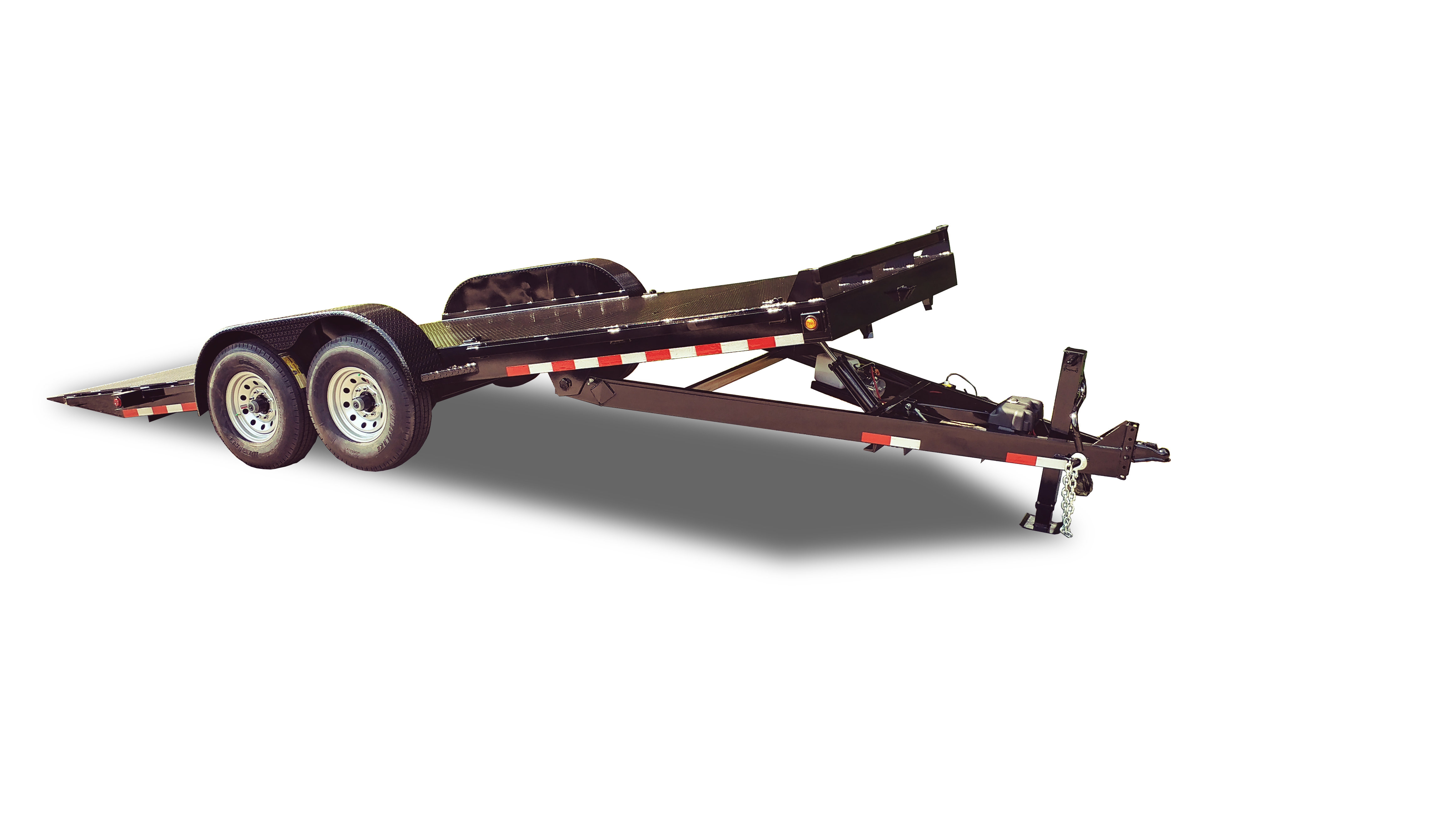

Something like the PJ TS series would probably be ideal since you need the low height, but the wide deck and drive over fenders would still allow you to easily load vehicles when needed:
Or a Load Trail or Diamond C if you're feeling frisky (getting full tilt may be build to order, but a partial tilt would work for your scissor lift and material needs):
