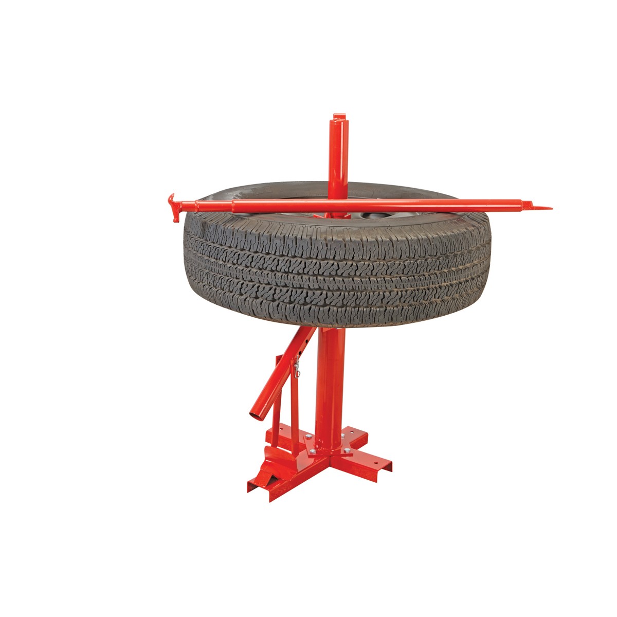

Tire changer from Harbor Freight. I did 12 tires one day using it.
Manual Tire Changer
awww.harborfreight.com_media_catalog_product_cache_1_image_9df68e49300593673c28c567e328982f190.jpg
In doing my research to do this on my own, I found that Harbor freight tool. But I also saw where a lot of guys were having to modify it for it to actually work well.
there tire changer sucks for anything over 35
That's basically what I saw, that and several pieces bend and others have had to weld onto them too for bracing.

I Mounted a 40" swamper using the HF changer with no trouble.
The end of the lever did break off and require me rewelding it on. It never broke again though.

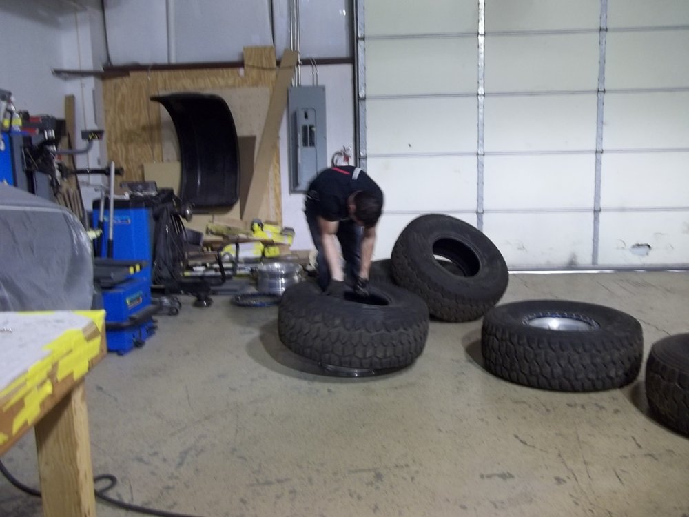

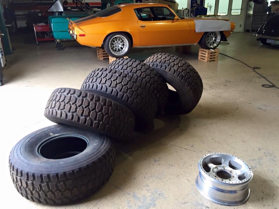

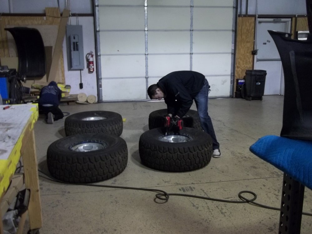

S.L. Customs took time away from building badass resto-mods to let me use their tire machine. Huuuuge thanks to them. Although I do feel like I may have provided some good entertainment trying to work that thing lol.
Just so people don't think I made it too easy for him, Jay did have to get his hands dirty (although the Redlyner Racing Level 9 hair gel held firm through the whole process.) Here are a couple working shots for entertainment purposes. While my tire machine did most of the hard work, it did not have the reach to pull the tire over the last bead so Mr. Handsome Jay #HandsomeJay had to put those guns to work and do some tugging... on the tire.
