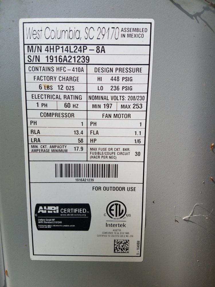

Does this help? Google says its 2 ton.
2 ton lennox 14 seer according to my quick googlefu

2 ton is likely borderline too small for your current house unless you have another unit for upstairs.
either way, I agree it’s likely too small.
