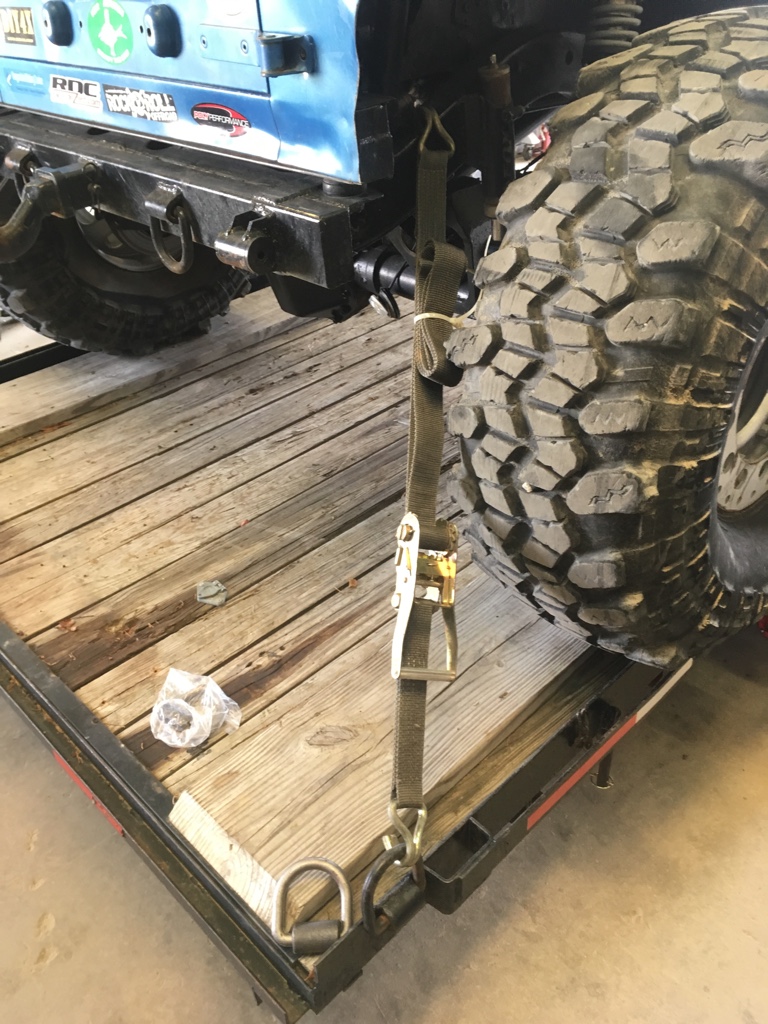

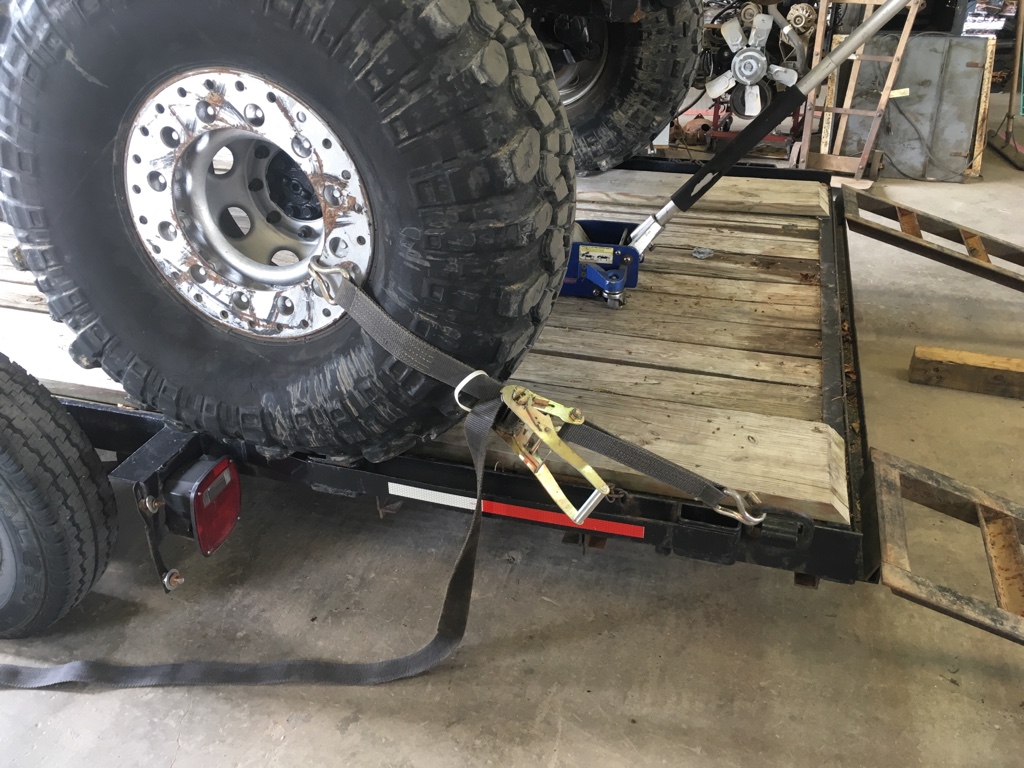

Is this an acceptable way to secure a rig.
Hooked from rock ring on wheel to d ring on trailer.
Obviously it is not tight and all 4 are not on my jeep.
This is not how I currently tie down to tow, but would make it about twice as fast to tie down.
What does nc4x4 say.

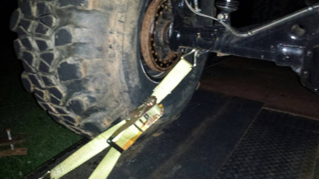

My current setup I use 4 straps and 4 axle straps, one per corner from axle to frame.
I also usually put two more additional straps from the rear bumper to the rear corners of the trailer to keep the jeep from swaying and causing the trailer to sway.
I'm not trying to debate over axles vs suspension,
Just whether or not it is acceptable or good practice to hook to the wheel/Rock ring etc and then to the trailer.
Thanks everyone.

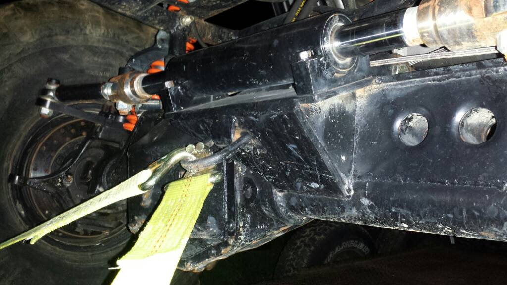

I don't like it. At least with the axle wrap and strap it goes fully around the tube. On top of that most have a safety of some type on the business end. I also get some triangulation under the rig. I see this unloading some at the pressures I like to run. More I just see bad images of a driverless rig running 70 mph side ways on an interstate.
Only way I would use the rim or tire to tie down would be those baskets that go over the whole tire hook on front of it then behind it. That way if it came loose it would still be somewhat contained but if something happens and it comes loose the way it is in the pic it would be too easy to come unhooked and be completely uncontained.
I'm guessing a tire strap won't fit through the holes in the wheels...? If it would, I'd go that route. I wouldn't hook to the rock ring.
If you want to roll the dice with Ballistic Fab, they sell a weld-on axle tab for strapping down. It's cut from 3/8" or 1/2" or something with like a 1.5" hole in the center.

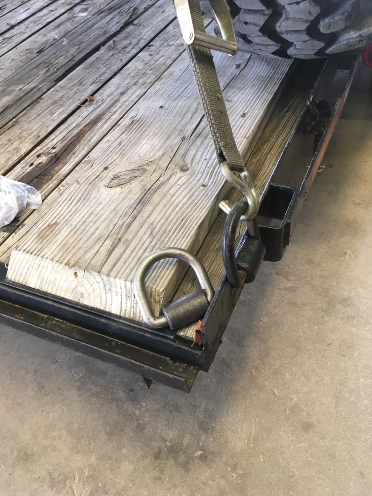

While we're nit picking, you shouldn't be loading that D-ring off-axis like that, either.

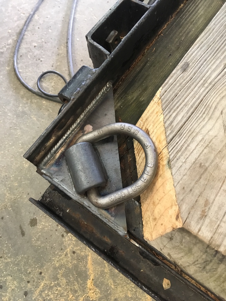

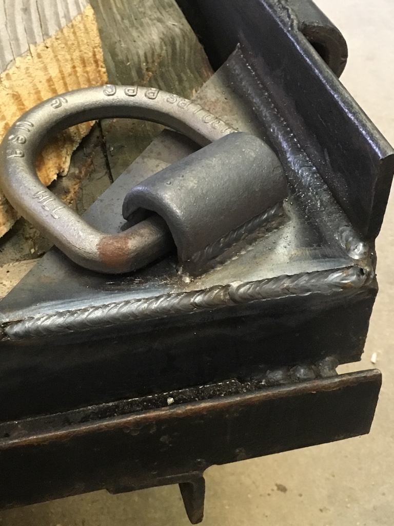

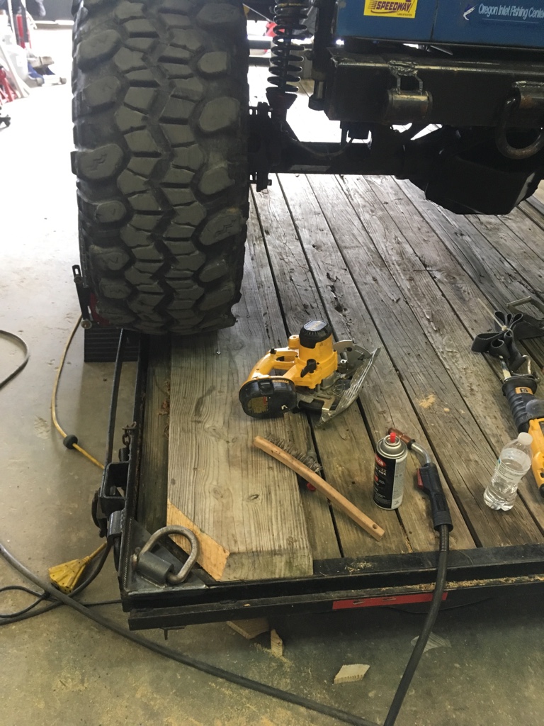

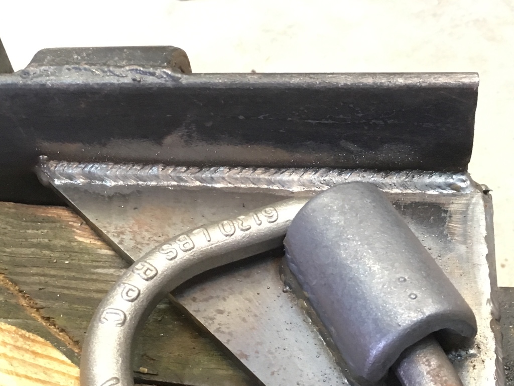

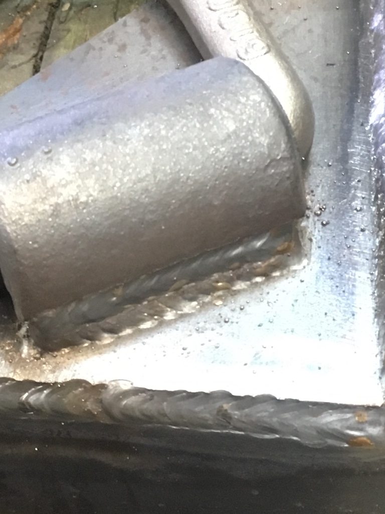

I agree with the pulling on the d ring incorrectly. I'm not saying it's right, I'm just saying I've done it like that for years with no issue. Mainly because there's not a good place else to hook to on the back of the trailer. About to fix that right now.
Going to put a plate across the corner and a new d ring on said plate.
Here is an alternative as well. Straps runs up to factory tow hole in frame. Great for pulling down ward but not much angle to the rear. May use this with the aformentioned axle strap.

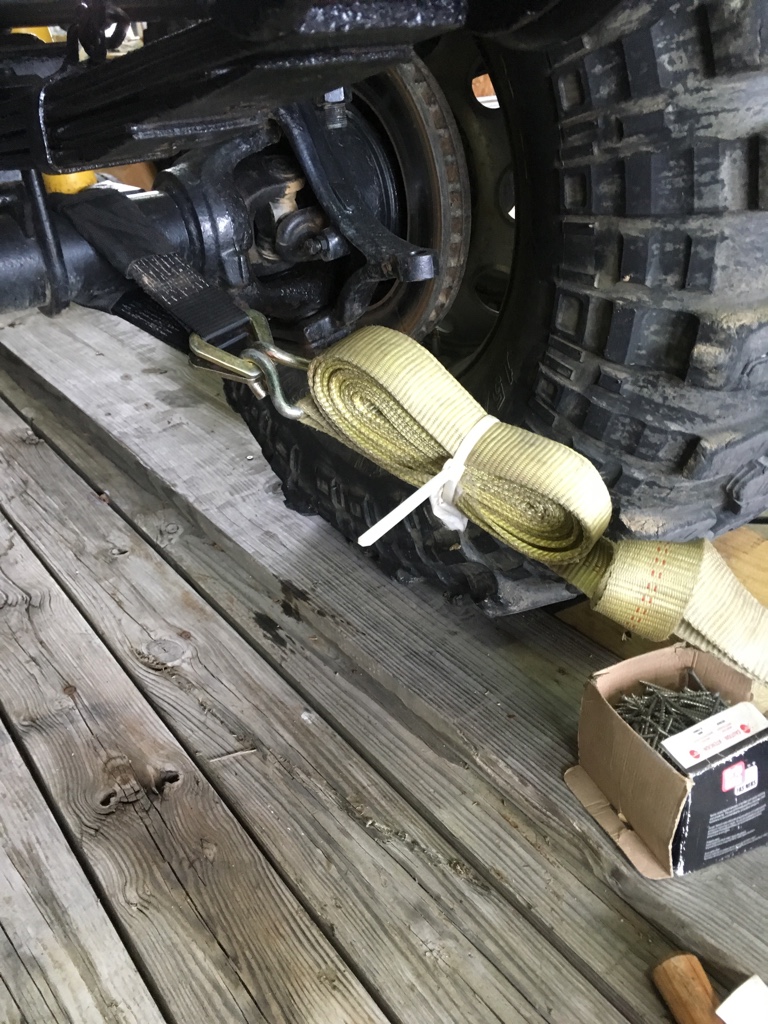

Now I currently use 4 straps, one on each corner from axle to frame, and then another on the rear pulling rear down, to combat sway.
I have the leftover strap material zip tied to the strap so fronts are at set length and rears are set length.

I just did the 4 d rings in correct spot and correct axis on trailer.

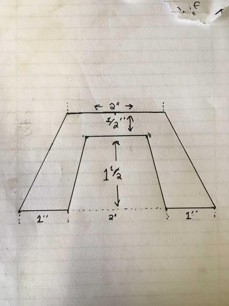

Out of all this. I discovered I need a certain tab to weld to axle, that will allow me to use strap or chain.
Plan to make that out of some 3/8 steel.

If I need to change length, just use a screwdriver to lift the tab in the zip tie and adjust, then re tighten.

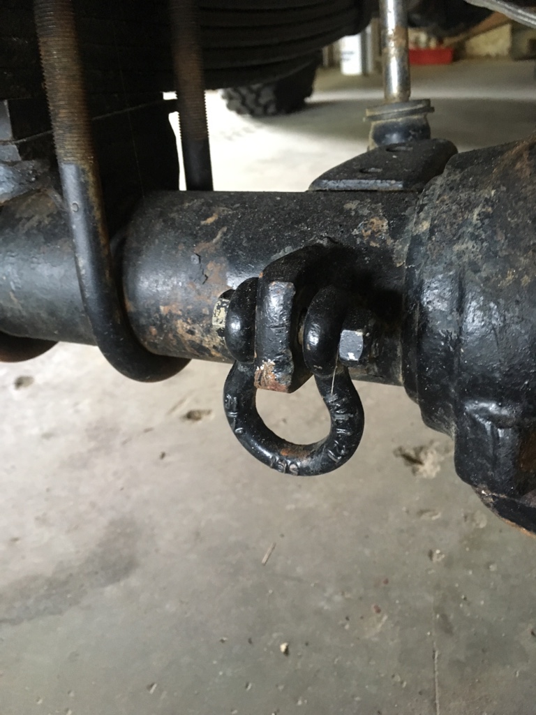

On my dads truck, we have tabs that hold small Clevis on the axles, then we welded d rings on the trailer so that he needs no chains, only binders.

I have a couple friends that have taken a dring mount just like you used on your trailer and welded it to the axle tubes. I've never been a fan of the looks of it but it's damn convienient and they've been strapping the same rigs like that for over 10yrs with zero issues.
I have Mac's axle straps but welded on some axle tabs. Makes it quick and easy. I used to put a chain on the rear without a binder and used the front to pull tension. I like that as, for me, adds peace of mind the buggy isn't coming in the cab of the truck, ever. But, I e picked up some Mac's straps and they seem very well made that add to my peace of mind.
Out of all the BS that Ballistic is to deal with, they have some nice pre made axle tabs that work well with my straps and chains.

not once they flash rust a tad and the clamp tube gets deformed.
They are a PITA to forcibly move, IME, they dont randomly flop around.

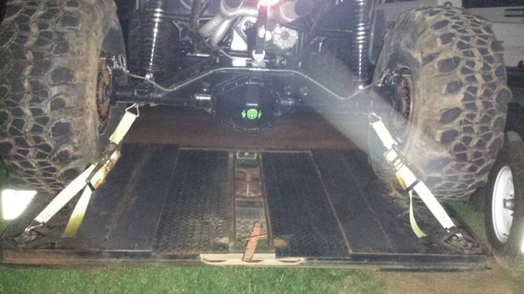

I have rings welded to my axles and after I got my shocks and springs dialed in the buggy does not budge on the trailer.
I have my straps marked and cut for front and rear and then keep longer straps on hand for hauling other stuff. It takes all of 2min for me to load up and be ready to go.
I have my straps marked and cut for front and rear and then keep longer straps on hand for hauling other stuff. It takes all of 2min for me to load up and be ready to go.View attachment 227097View attachment 227098View attachment 227099View attachment 227100
Sent from my SCH-R970 using Tapatalk

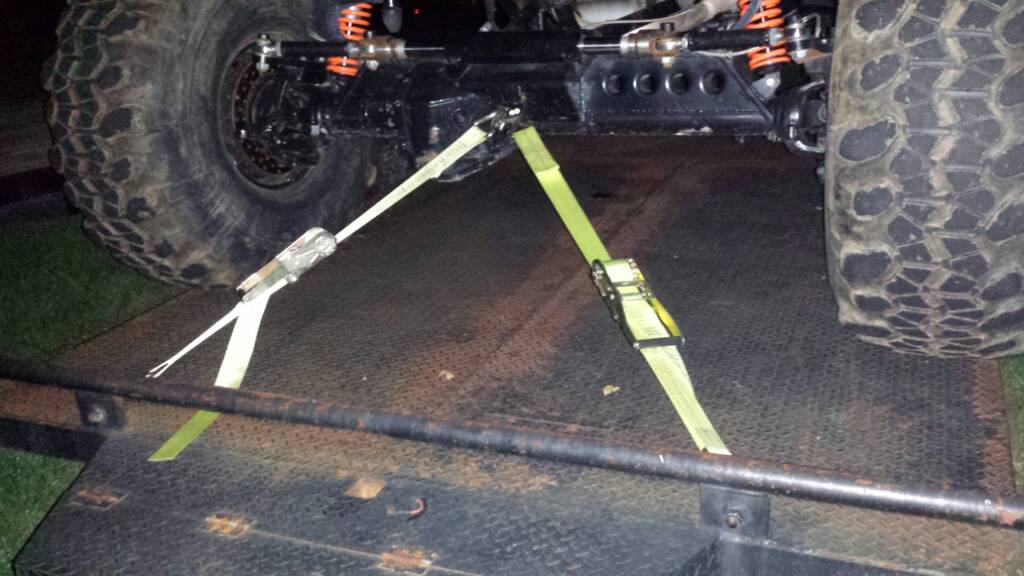

I like the rear, only might question the rating of the rings. I do similar on the front, but run strap around the tube. A DMV guy having a bad day, would probably give us both grief, on Not having a True 4-point tie down, > 2 separate front points.
I'd say the strap will break before the rings.

Right but the concern is, if 1 strap breaks the other strap exacerbates the problem. If the right front strap breaks the left front strap will now pull the center of the vehicle to the left and potentially off the trailer.
