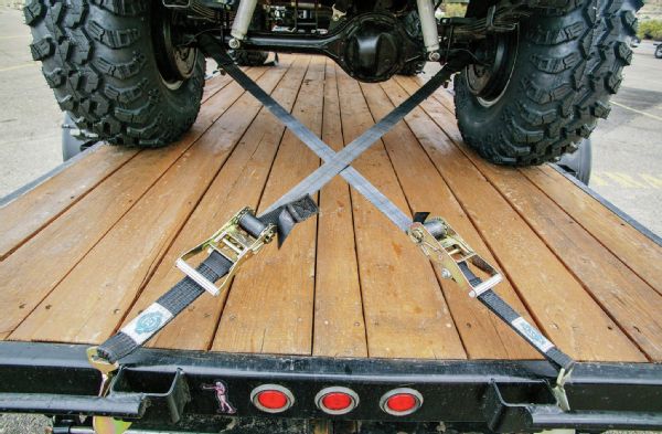

The photo demonstrating chain and binders is nearly as bad.
That article is... uh...
:eek:
Yeah, I remember reading that in print and was appalled.
