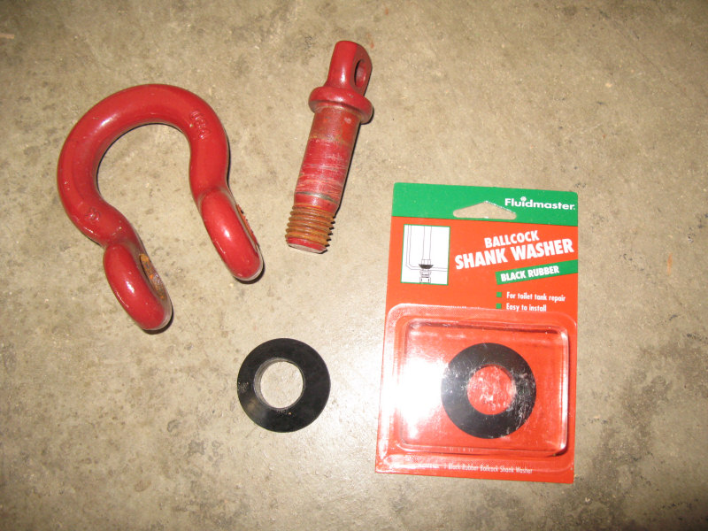

I've seen some people use they daystar shackle isolator kit. Or garden hose/toilet gaskets that fit snug on the pin. That keeps them from rattling. On the trailer mounted style drings you could also wrap the ring with electrical tape to dampen the rattle.

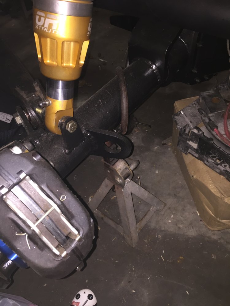

Why not just weld on a couple of heavy tabs like these? Quick and easy and it won't rattle. Use one on each side of the axle and eliminate putting two straps in one mount point and help to resolve the issue Ron just described.
Rons concern was if a strap breaks it's gonna pull the opposite direction . The way to prevent that is to run the straps straight however thats not a proper way to strap a vehicle. Those large tabs are nice but to me they would end up being bent over by a rock. I just stick to stuff rated for the load and replace straps when worn.

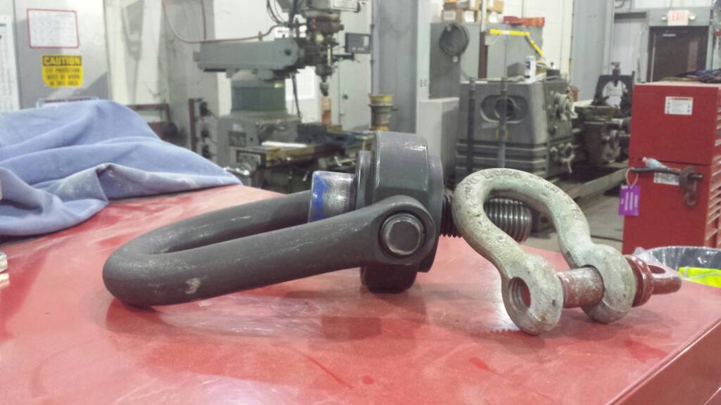

Weld on some thread bungs and use a couple of safety hoist rings. Problem solved. Pockets emptied.
McMaster-Carr
3/4"-10 are rated to lift 5000lbs and are $70 each. Zinc plated is about twice as expensive.

Would these be sufficient?
Looks like a 1"-8 shackle and a 1-1/4"-7 safety hoist ring? The safety hoist ring should be rated for about 15,000lbs, so you could pick the jeep, trailer, and truck up with it. If that's all you wanna do, then it should meet your needs :D

How is hooking to a hole in the rock ring more dangerous or less effective than hooking to a tab welded to the axle ?
From the pictures, it just looked like if one popped loose, that a tire could slide over and drop off the trailer deck. Shit, maybe it could happen the way I run my straps today. I have a nice set of straps from MAC's and have not had any trouble from them in over 12 years. This is what I use with one strap over each axle tube/ corner of the rig. D-rings on all four corners of the trailer. It is a 16' Kaufman steel deck trailer.
I don't trust the rock ring as a tie down because I've seen them bend and fold after hitting rocks, the rim itself is probably much weaker than a 1/4 or 3/8 ring or plate welded directly to the thick axle tube. That's just my opinion though, I'm a mechanic, not an engineer, LOL.
Its not. I personally like the idea. There's a lot more weld to break, and its in a better shear plane. Also, its the widest possible point, which should give you the best control over the load.
That is the setup I have and have used the axle straps. But for convenience, I've added the 3/8" thick tabs on the axle to clip to as wide as I could and not run the tire with the straps. Seems like a win/win/win with convenience, quality, and methodology
It seems that the rock ring could be easier bent out than a tab welded onto the tube, probably would take an extreme case for it to happen but still seems easier to bend the rock ring. For what it's worth I wrap around the tube front and back with axle straps, just what I trust more.
