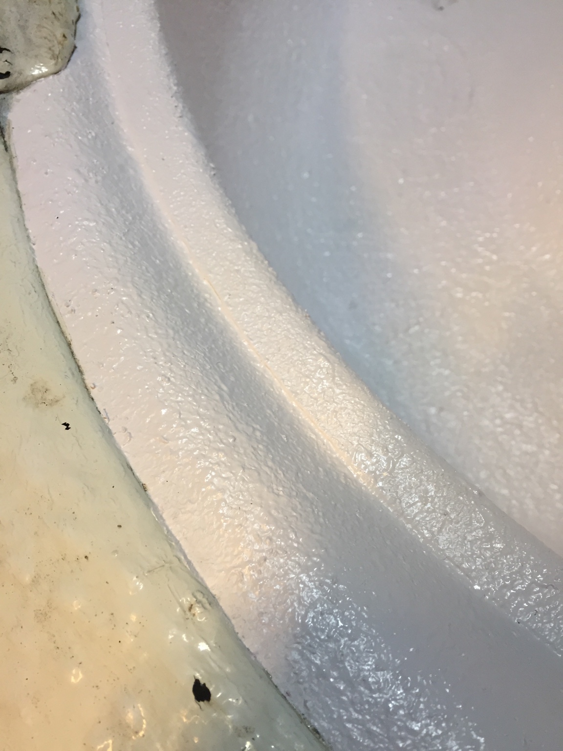

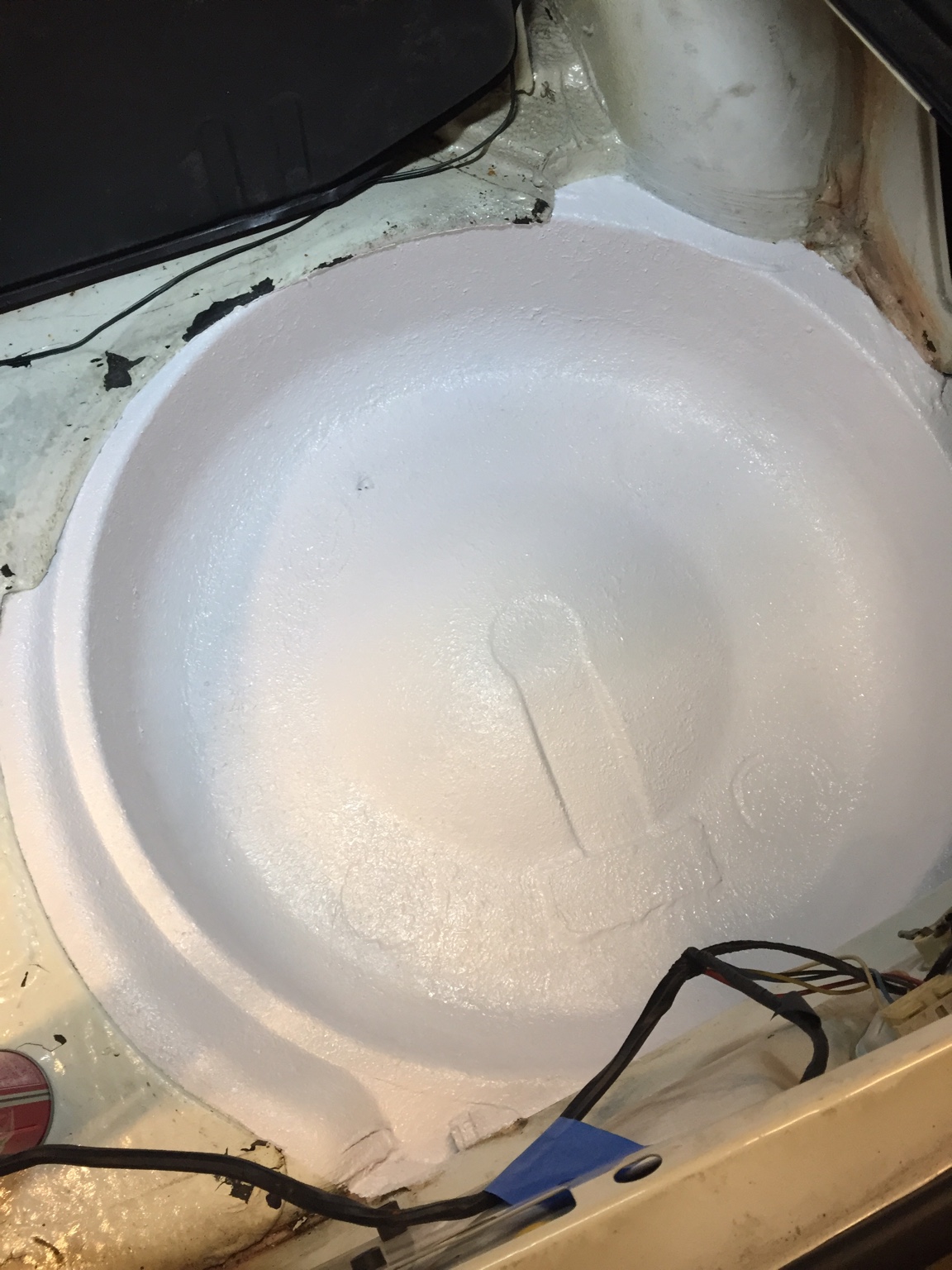

Rock-It Liner™ Kits Products | SEM Products
I applied this to my jeep tub and have used it on customer projects. It's not a abrasive rough texture. It's more like a heavy orange peel texture.
