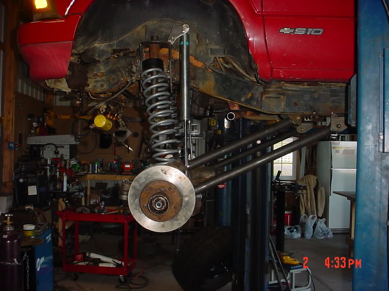

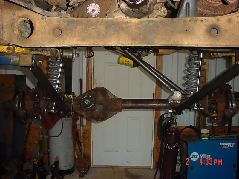

This thread is old as can be, but I'm finally getting the SAS done. It will be a three-link type setup up front. I'll try to get a complete parts list here before long.

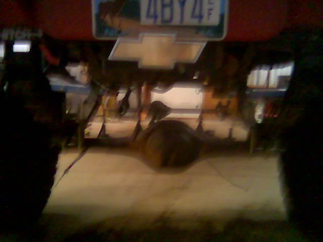

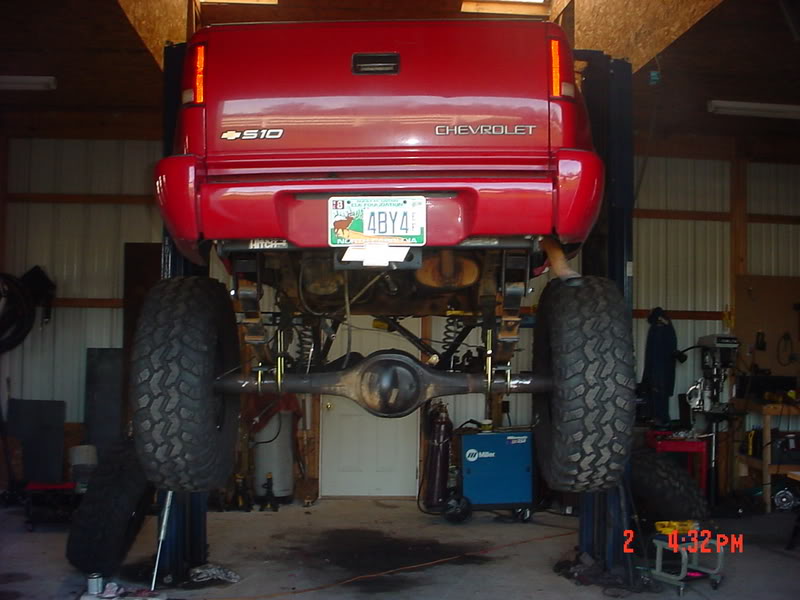

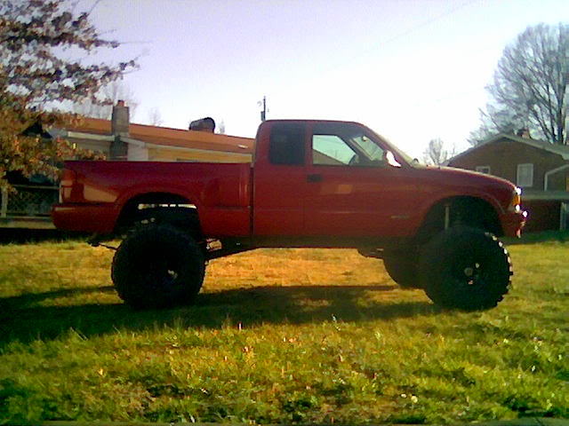

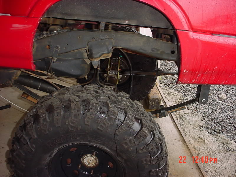

The rear axle is on, and rough measurement so far is the doorhandle is in the 57-58" range and the tailgate closed is in the 65" range.

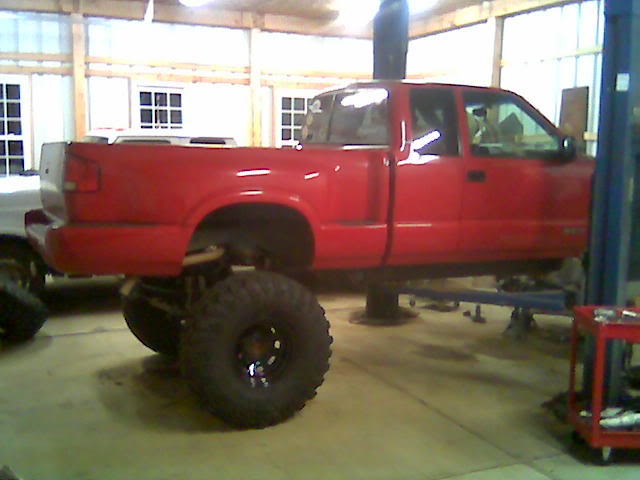

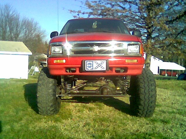

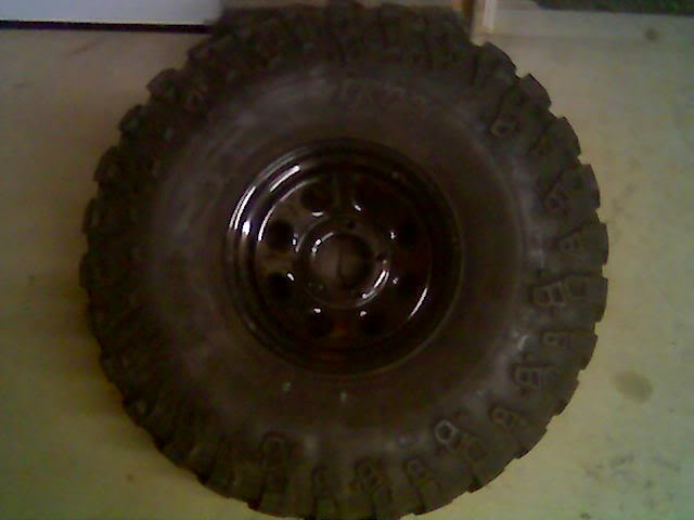

37.1250.15 Irok Radials
Look small on the truck in that picture to me

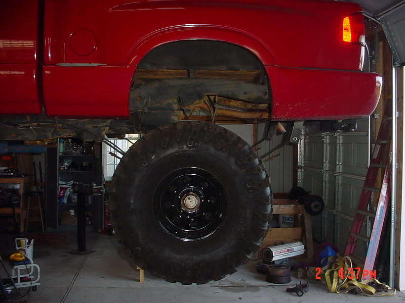

We will probably round off the rear fender and see what we have to do from there. Trying to keep as much of the body as I can, for personal, emotional reasons. Ok, that sounds gay. sorry.

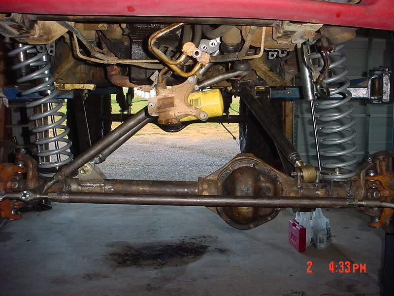

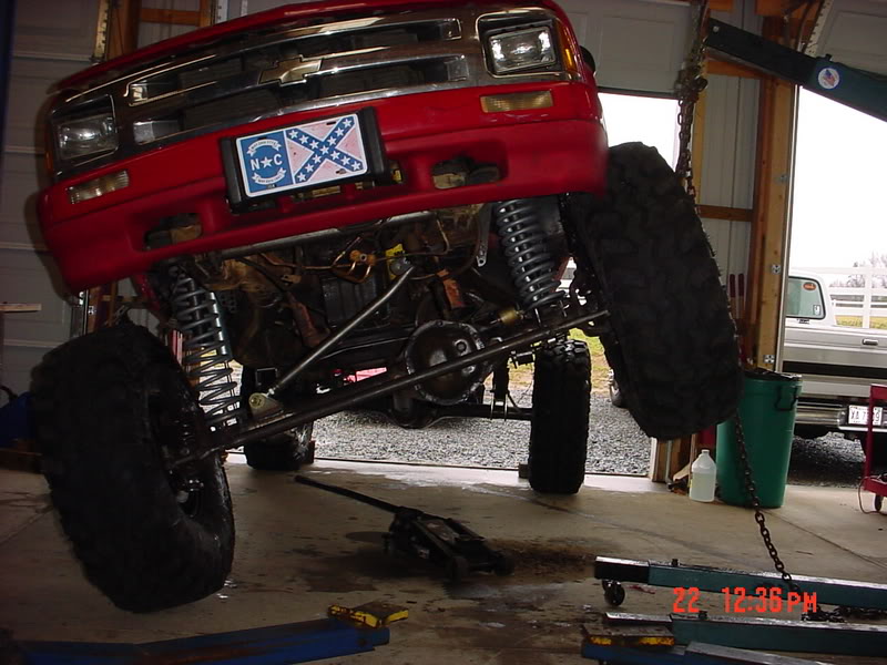

These pictures are not flexed out completely. We just didn't have a whole lot of room to work with between the lift. I'll get better flexed out pics once it gets driven and the coils break in a little better.

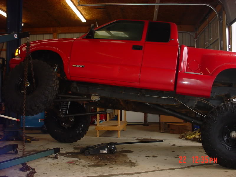

HOLY JESUS look at that draglink and trackbar angle.. I bet it has helacious bumpsteer.. I saw you driving down 158 the other day and it does look good...
I can actually let the wheel go on a straight road and bumps won't really move it. It seems great as of right now, but working out kinks is all part of the process.
Also, one of the reasons that the links look so steep is because they are bent at the top in order to allow a flatter angle to the pitman arm/DLE connection. If the links were straight, it would be easier to max out the DLE upon flex.
