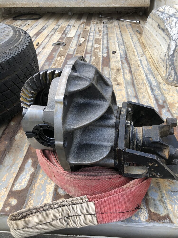

What Jody said. First trip to URE after building mine (many years ago), the center section cracked open. Had to pull the rear driveshaft and drive it home in front wheel drive. Bought a used Strange center section from ECGS, no troubles since.
X2 on the center section. Bought a nodular 3rd from ECGS and it was golden. That, combined with 1541H 31 spline shafts is a solid setup, although I went 35 spline but that was an accident. The 31 spline shafts with a good center section it very strong.
Since mine had an SYE, the rear pinion was pointed up at the transfer case so that helped with clearance but 100% put a pinion guard on it.

Zoom in on the caps, they’re pure beef. I kept blowing the factory ones out.
