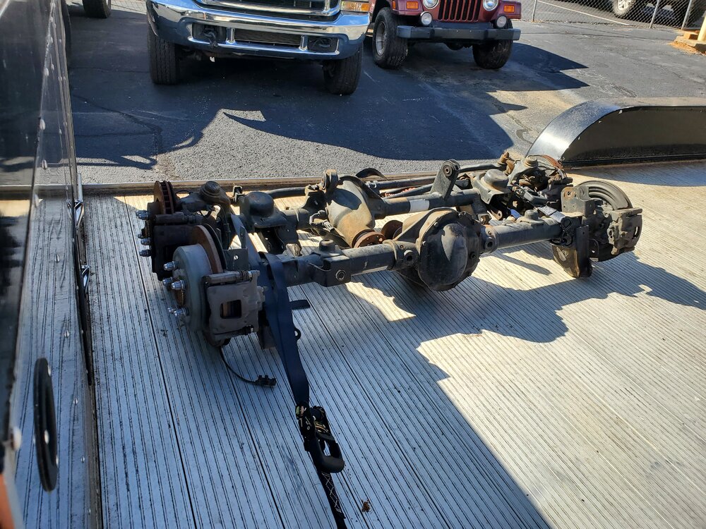

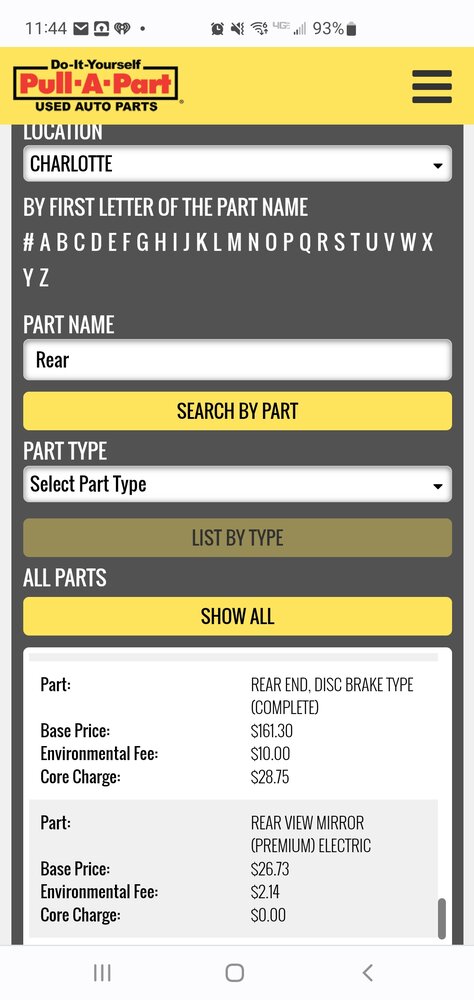

Care to share all these "deals" you've seen, because every JK axles pair or individual I've seen in the recent months have all be 4 digit prices. 8.8s even at their highest are $500.
C-clip eliminator on an 8.8 is ~$200 more than chromos for a JK. So boom no more c clips 🤨
I would have definitely liked to see some of those 8.8 priced Jk44 deals before picking these up a few weeks ago.
