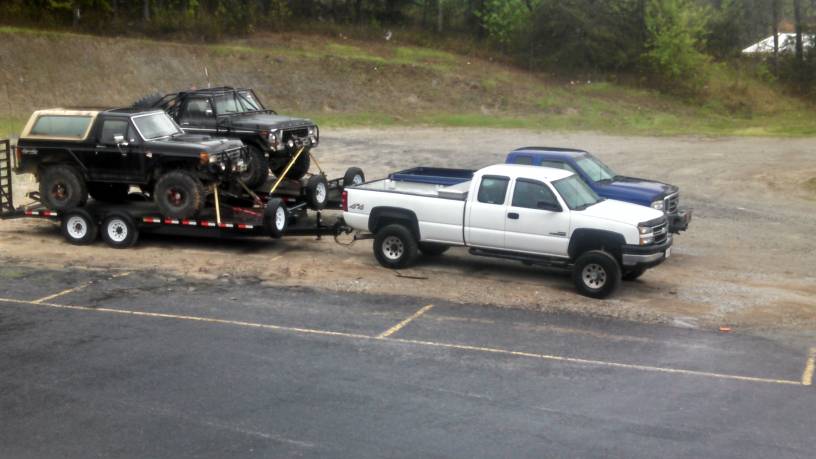

I use chains with axle J hooks like a wrecker to hold my truck on the trailer. I made the rear axles chains the right length to position the load. I pull on the trailer, hook the chains, then pull up til the chains get tight. Then I chain and load bind the front.
Ive found the chains work fine for most everything I've moved, from my 78 f150 to a friends 2000 mustang.
If your trail rig is top heavy or has slinky suspension it helps to tie the suspension down too. I run ratchet straps side to side over my trail rigs front and rear hitch recievers. I don't do this pulling a normal vehicle.

On my jeep and my dads cab truck we couldn’t only secure the axles when towing. His is a 14k tag, my trailer is a 7k tag along.
If we secured with axles only the chassis and spring weight of the rigs leaning on the trailer would make trailer sway worse at highway speeds and cross wind gusts. This is due to somewhat high cog, and long travel suspensions.
His lightweight 3800lbs buggy is secured by axles only and is a non issue with either trailer.
To solve the problem we secure the front axle, secure the rear axle, then use big ratchet straps to suck down the rear suspension ( both of the problem rigs were leaf sprung front and linked rear). Once the rear was sucked down then we made sure the rear axle straps were still tight, as the wheelbase grows in bump.
This one change strapping down the suspension and chassis instead of just the axles completely solved the issue.
We used to tow with chains and ratchet binders but have moved to nice high quality straps.
On his cab truck we welded the tow down points to use the shortest chain and binder combo as possible. His rear was held with binder only from trailer d ring, to d rings on rear axle.
We don’t cross straps any more, each one just has a slight outward angle.
We used to cross, until the thought of one coming apart and the rig falling off the side of the trailer.
