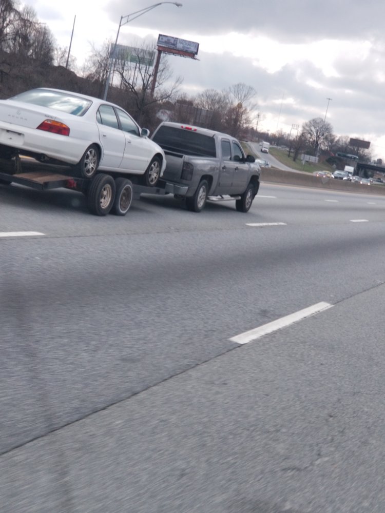

Tongue weight! Tongue weight! Right after brakes this is where most mistakes happen. Not like guy in picture.
There are sooooo many things wrong with that picture...it's funny, and NOT, all at the same time.
EDIT: At least he's got some new-ish looking lumber on the deck going for him...
I own a truck almost exactly like the in one the picture. It takes tongue weight pretty good. 1000lbs Won't squat it like that. So the real question is how is it so improperly loaded with such a small load. You could put that car in the bed and I think it would be loaded more appropriately.
Because that is the way it looks without a load... Bling Bling Yo
