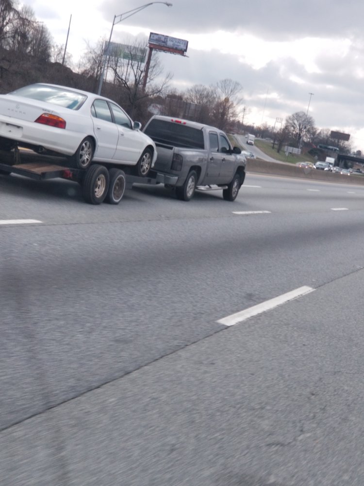

I own a truck almost exactly like the in one the picture. It takes tongue weight pretty good. 1000lbs Won't squat it like that. So the real question is how is it so improperly loaded with such a small load. You could put that car in the bed and I think it would be loaded more appropriately.
I know what you're saying. I've loaded down half tons with some questionably heavy loads in terms of towing capacity. Even used to tow my CJ to the mud races with a V6 Dakota. Obviously not recommending that, since I know I was well over capacity there as well. Never once have I made anything squat like that, especially so bad as to to unload the front suspension. That, coupled with those sketchy-ass tires in the pic...that dudes just looking for trouble
Those sketchy ass tires look like half the problem. They look like different sizes and the smaller one is on the first axle.
I was hoping that wasn't my own eyeballs that was seeing different sizes. Looks like they're car tires, too. At least the ones on the front axle.
Tongue weight! Tongue weight! Right after brakes this is where most mistakes happen. Not like guy in picture. View attachment 263328
Looking at this thing again, it almost looks like the rear tires of the car are almost even with the rear axle of the trailer, or at least within a foot. All that weight on the tongue is putting a massive moment of force on the truck's hitch.
Almost looks like if the car were backed on the trailer, he would have been fine.

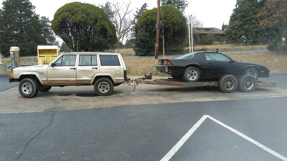

I've towed a variety of things with my xj.. but I've got Dakota leafs and kept the overloads. Just need to watch the weight distribution. (And I won't tow anything over about 5000#, not counting the trailer) it used to have trailer brakes but they got removed when the shoes locked up a wheel sitting. Not going to win any races. Longest trip was from rutherfordton to siler City, towing a xj on a friend's trailer.
Had decent distribution in that pic, though I don't like reverse loads.
