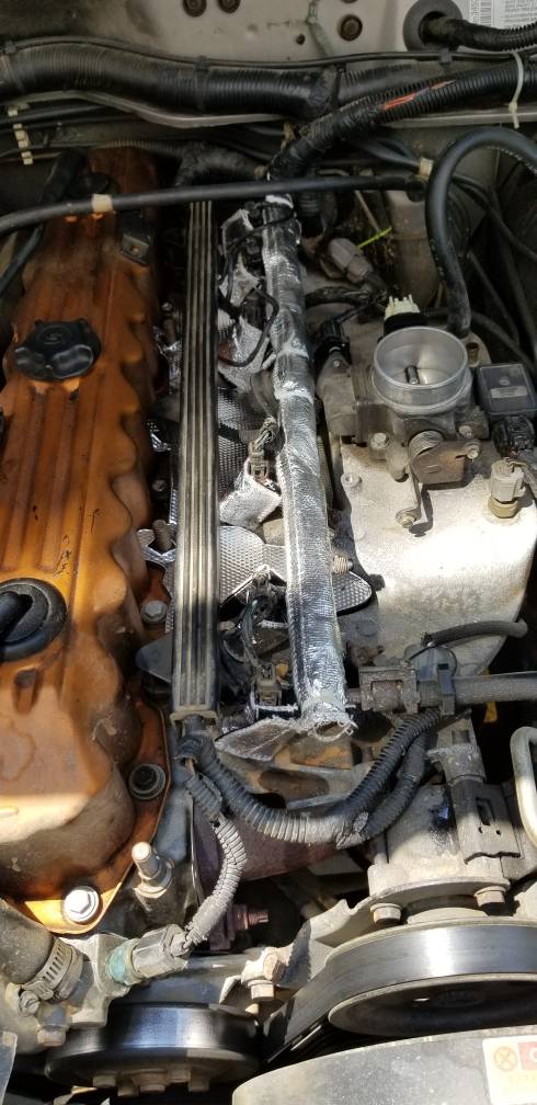

Got the heat shield on about to start on the hood risers. I totally forogt my fuel rail has some round thing on it. My ideas of cutting slits workd great but the ends were loose. So I used zipties to help hold the shield on the ends and around the round thing that I don't know what it is. Also I found I thread bolt hole on my intake that isnt being used.

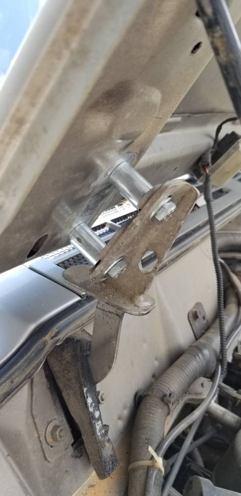

Might take the factory spacer off and lower it about 3/16th of an inch. Hopefully this will help to release the heat after I cut it off. I used all grade five hardware with 1 inch sleeve. I'm not sure what I think about how it looks.
That's what I had to do to my XJ. It was a 2000. The '00 and '01 were a terrible design. I did all the internet remedies except the fan. I started with the easy stuff...new injectors, heat shield, heat tape, then the hood spacer. The hood spacer was the ticket so I quit there.

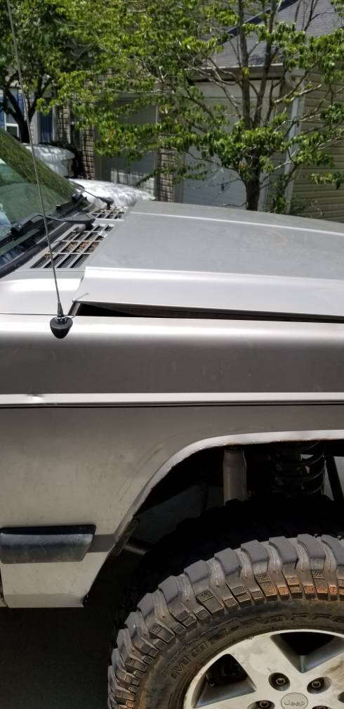

My problem wasnt running hot while moving or sitting still but the problem was once I cut it off the heat just sitting in my engine bay. But this has solved that issue. I stopped at 3 different stores yesterday afternoon and didnt experience heat soak or hard starting once.
Right on. Same here. Engine was always fine at 190ish. I'm referring to the under hood temp right at the fuel rail not the engine temp. It was classic heat sink that affects the '00-'01 years. Glad you got it handled! It looks good.
Yeah come winter time I'll probably take the spacers out to help keep it warm enough and so I'll have heat. I dont understand the design because theres no where for the heat to go as it is cooling down. I'm so happy to finally have the heat sink problem fixed.
