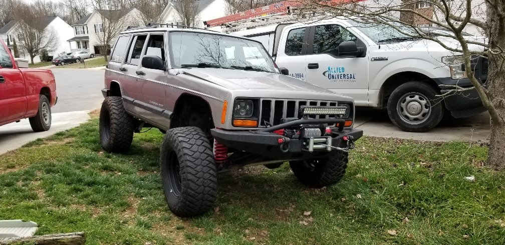

Well she now has new shocks on all four corners. The last shock stud on the rear axel gave way. So I just drilled it out put a grade bolt through it and pressed a sleeve into the bushing of the shock. The bolt fits tightly though the sleeve and the hole.
Of course I played with it in the yard. These new shocks feel alot better than the old quadratecs I did have.
Looks good. What size tires and gears did you go with? I’m sure it’s up there somewhere but didn’t see it.
34s and 4.88 gears. It has a good bit of get up and go off the line. I do not know what the top speed is yet.

Rpm at 65 was about 2400. 70 was a little more but that was all she had. I do have an exhuast leak. I wonder if that is effecting anything.
The ride quality was amazing even over the bridges. I still have a slight pop sound in the front end when turning. I know for sure it isnt the u joints. Would tierod ends cause this?
All it had at 70? How many miles does that thing have? It should be pretty peppy at those RPMs and be able roll on.
25k on the engine that's why im wondering if the exhaust leak could be affecting it.
I could have given it more gas but I didnt really want to push it too hard. I need to drive it some more at that speed and get a better feel for it I think.
My old xj had the normal broken exhaust manifold leak when I bought it. After replacing the manifold I didnt notice any gain in power.
Where is yours leaking?
Where the headers connect to the y pipe with the cats.
