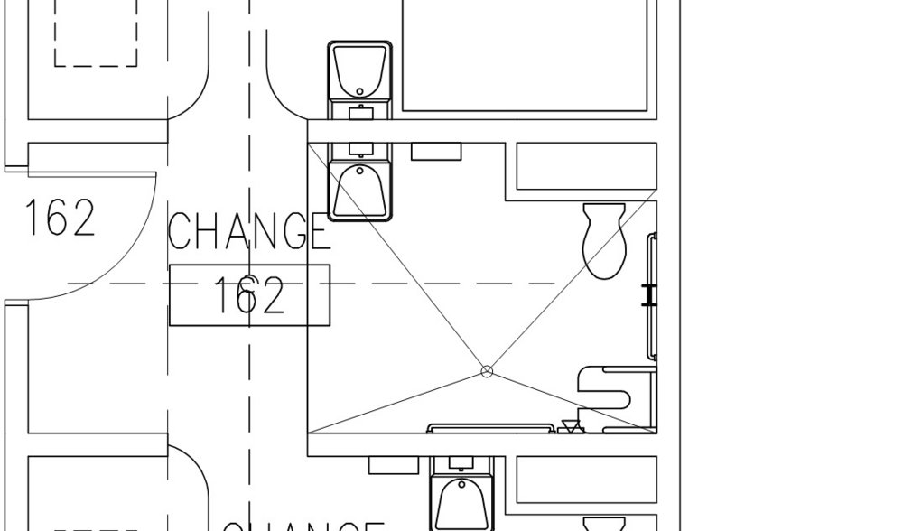

I know this is common in campers, but I have an architect that wants to take this concept into a permanent structure and is asking me the legality/legitimacy of it. I've done loads of assisted living, nursing, dialysis, cancer, treatment facilities, and never once had a toilet IN the shower stall.
My concerns are:
Toilet paper: do you use the wand as a bidet now? How do you keep the paper dry? 3 shells?
Hardware: everything will rust associated with the toilet unless it's SS
Why?: I mean, we ALL pee in the shower...and at camp shower facilities you're wearing shower shoes, so you just smash the turd down the drain hole and roll on....sheesh!
ICC/NCSBC nor commentary address this. And before I call in a favor to an inspector, I wondered if any of you ever ran into this

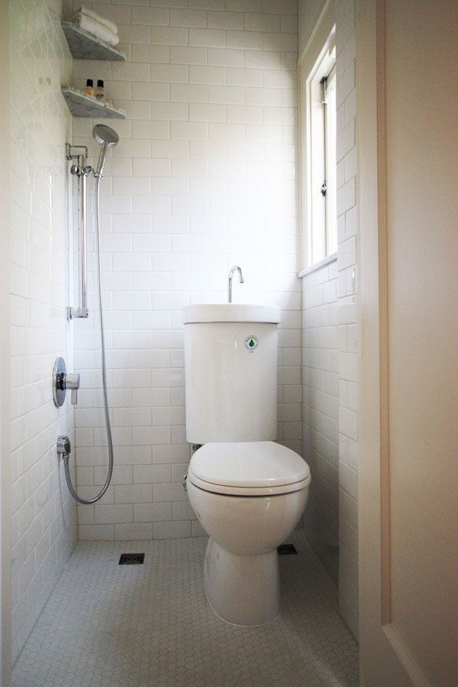

You could keep the TP dry by having it in a box enclosure that is only open on the bottom, e.g. imagine a cube where only the bottom plane is open. If that is out of the spray line of the shower it should be ok.

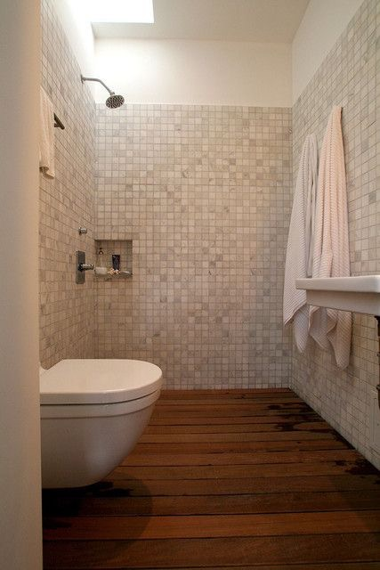

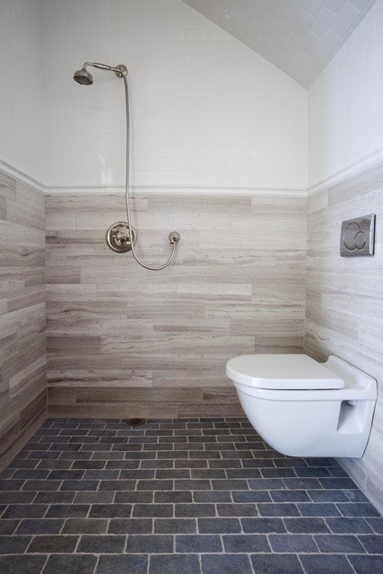

All those pics seem fine to me. We Americans are used to showers being a little box w/ confined walls, but in a lot of countries it isn't that way, and it's just kind of out in the open like that.
I can't see any reason why code would be relevant at all. There's no issue here affecting flow or throughput.

It COULD be for special needs kids. When I did Carter HS in WS we had a huge room where you could take a kid out of a hospital bed, put him in an elevated "tub" and there was a toilet in the same area (see below....similar, but ADA shr combo) but I'm fearful of THIS one, as she's a Hysterical society architect. The way she is talking I'm thinking it's one of the buildings downtown they're converting to condos, or retail.

That's the conclusion I've reached. But just making sure no one in here has crossed that bridge and found out inspections dept had some lunch and learn about this and burned someone in the past (i.e. any and all changes in the field require a sealed bulletin dwg before inspector will even sign off on underground :rolleyes: )
UPDATE: Turns out is IS a space issue. Architect is renovating a hysterical dorm and has to bring it up to current ADA and number of fixture/student requirements.

The more I think about it....the more I want to build a shop at my next house with a bathroom similar to CHANGE 162 above....where I can just take off my clothes, shit/shower in one motion, then bidet/flush and be done. Only needs a wall TV and a beer fridge for ultimate mancave
