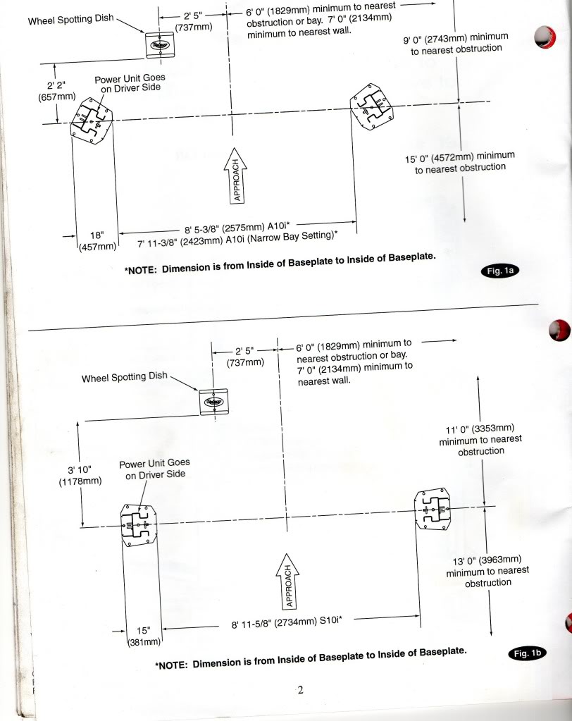

25 ft is not deep enough if you put a lift in, they suggest at least 11 feet from center of lift forward, and 13 feet behind
psst 11+13 is 24. Technically big enough.:huggy:
