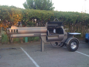

like this??

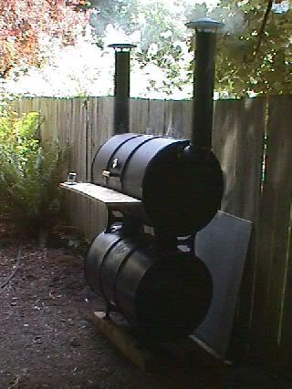

Here is mine.
Homebuilt and cooks well. I just need to find a source of hickory to run straight hickory for it, with charcoal it takes more work to keep the fire going.
