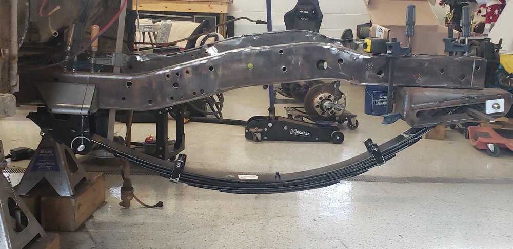

Seems the only difference between mounting shackle hanger vs sliders is the longer footprint = packaging + more welding, so a wash on "more simple"?
FWIW, these are LII (pretty sure @snappy won these at an ECORS event and gifted them to me 10 years ago)... time will tell if any improvement over the shackles?
NOTE: before the keyboard "engineers" show in force to armchair, this was NOT the final position :flipoff2:
While there are a couple pros to shackle reverse, from several recent threads here/JCCA, it appears to bring handfuls of cons...
Sadly, No. This wasn't the final position. There was still hours of arguing and mm sized movements to come before it could all be welded in...

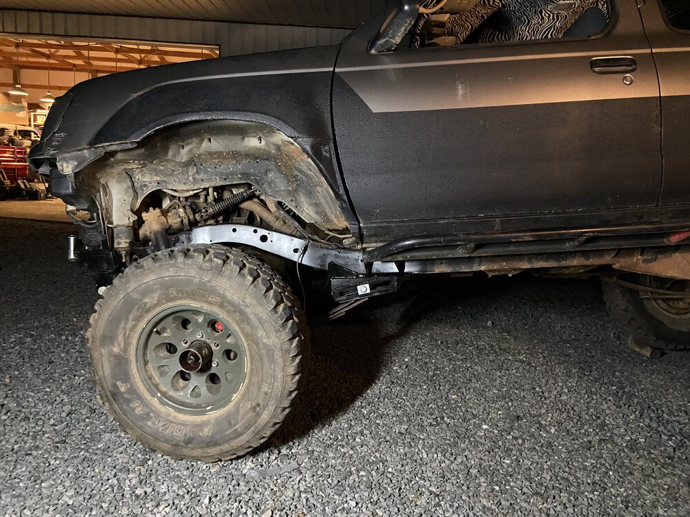

I have these on the front of my xterra. I really like them.
