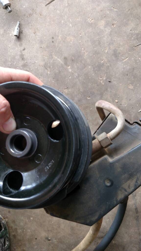

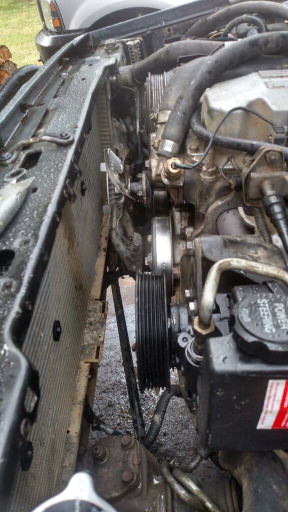

Swing and a miss
This pulley has to much offset compared to stock so it threw the belt
Is it possible to flip it around? That would be lucky, but worth a quick measurement.
Or some offset pump brackets. Spacers on the pump to move it rearward on the existing brackets?
I could flip it and it probably work but if it didn't I couldn't get it back off. Pump is bolted on both sides so that's a no go
Looked at it again think I figured out how to flip it over and install it and be able to get it back off if it doesn't work.

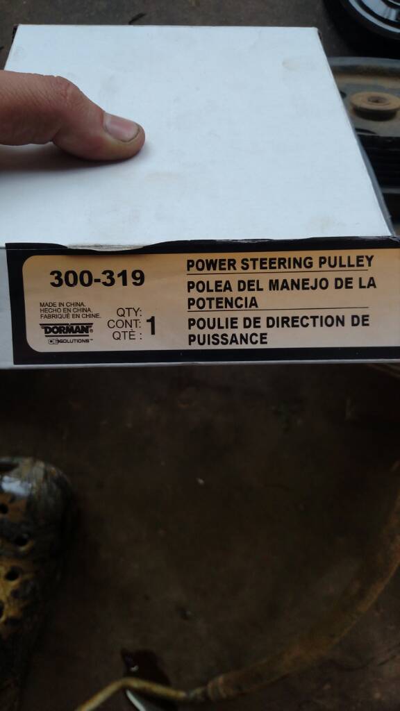

new pulley compared to stock and the part number.
