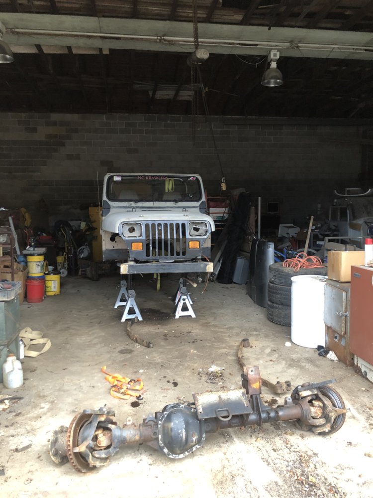

We all hear those stories of "yeah I'm gonna finish it someday" well here is one slowly getting finished. At least at this point all of the big parts are together and its going to start getting glued together in the next couple of months. No groundbreaking tech here, just another platform for people to heckle me on so I actually finish this someday project.
Back story cliff notes:

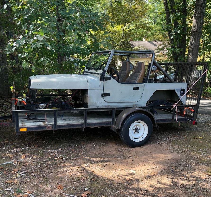

Summer of '17 my father in law to be calls and asks if I want a CJ7 project the neighbor is giving him. An abandoned restoration project he thought he would get around to someday. I just say yeah of course rather than ask what I'm in for. It ends up being a 79 CJ7 in boxes and pieces. Bought originally from another old farmer who used to haul fertilizer and farm stuff around in it, the tub had rotted out and the frame was ok but thinning in the back around some mounts. Not much was really useable, and not one to look a gift horse in the mouth, I put it on the back burner until I have the time to really put it together and minimize my hack rather than just booger it together. My father in law has always wanted an old CJ to bomb around the farm in, but wont ever do anything for himself. Enter the future son in law and the Someday CYJ.
Fast forward 2 years:
Wedding, life, work all get in the way and I finally am getting around to putting this thing together. Like my father in law, who is "frugal" , the idea is to get it going using what we have laying around. Luckily hes an old farmer with all kinds of old stuff laying around we can trade, sell, swap, scrap or whatever to get what we need.
The biggest hurdle I had was finding a tub/frame that was workable. Rot free CJ7 tubs are rare and/or pricey and being a beat around old farm jeep, there was no reason to spend a pile of money on a fiberglass tub.
Thanks to@YJKrawlin who was parting out his rig, I was able to scoop up a donor. Gotta say thanks for a pretty darn complete tub/frame that came with a ton of cool little goodies that work out well for what the project entails. There were more upsides to working off the YJ platform and just dropping the CJ drivetrain and clip onto it than negatives.

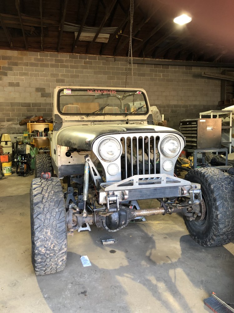

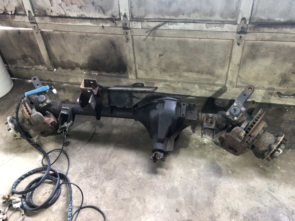

Nothing exciting but a long time coming to get it to this point. Still have a lot of organizing and cleaning to do in the shop, but managed to get the chassis and axles in today. Going to get things straightened up enough to move my tools in next time I come back and get the axles cleaned up over Thanksgiving. Going to SEMA and Fabtech so I’m sure I’ll have all kinds of ideas to not make this a simple leaf sprung Jeep when I come back :lol:

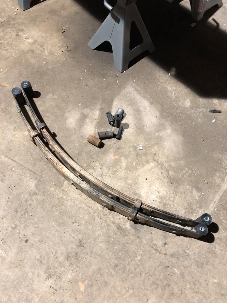

Started off by pressing the old bushings and rusted bolts out of the YJ front springs and replacing with fresh urethane ones so I can start mocking up everything in the front end. Soaked the old bushings in PB Blaster while I did stuff around the farm all day. Came back at night and lit them all on fire with the propane torch to soften them up then pressed them out. Only had to take the air hammer to one sleeve. The others pushed right out on a 50 ton press.

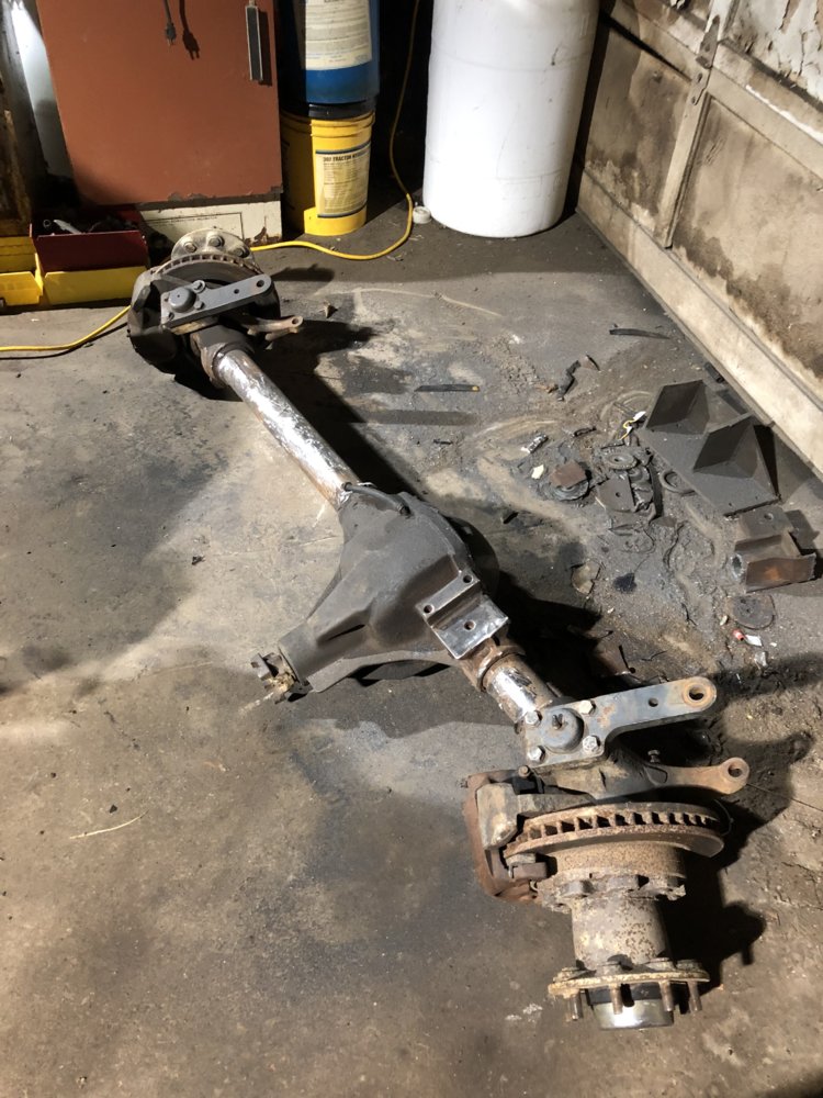

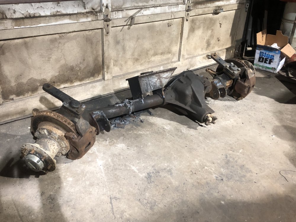

Started cleaning all the brackets off the 60 front. It has some pretty beefy stuff left on it from a previous link setup. I despise this part of every project, but the chingling cutting machine plasma off amazon is speeding things up. I still have probably half a day of cutting and grinding left to get the blank canvas.
Since I forgot my extra plasma consumables at home, I moved on to some front end mock up this morning instead of hunting before getting to work moving cattle in the pouring rain. Got the front shackle hangers burned together and tacked into place along with some D ring mounts. Be easy on the poor stack of dimes, it was the first pass with a brand new machine. For anyone needing a new welder, keep an eye on www.hobartweldshop.com for factory refurb units that looks and work brand new with their full factory warranty. Biggest reason for going with the 190 and a Hobart in particular is the availability of consumables 10 min up the road at TSC if needed.

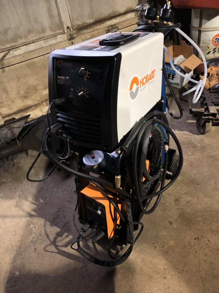

If you don't mind me asking what plasma did you buy? Something with easy to get consumables?I need a inexpensive one since I ran over my old one with my trailer. It was a mac and it sucked.
Zeny Cut 50. Consumables are easy to get as well online. The machine will run on 110 or 220 and so far running on 110 it cuts 1/4” pretty well. Another member on here turned me onto it and is running his on 220. I’ll be switching mine over as soon as I get a chance to put another 220 plug in the shop since our compressor uses the only one I have right now. For the price, it was worth a shot to not have to fill our oxy/ace tanks. Pleased so far now that I’m getting the voltage and air pressure settings dialed in.
I got pretty much the same unit, cut 50. Amazon has them, consumables, and new leads for when you melt it with a cut piece. I run mine on 220, and air wide open. No issues so far. It'll cut 3/8 on 220 pretty easily just have to move according to how it's cutting.

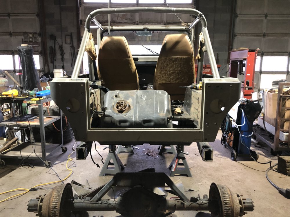

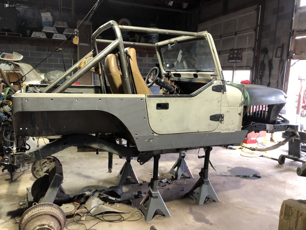

MotoBilt’s comp corners and rockers are on. Just need to bring the Rivnut tool back with me next time since 4 holes on each comp corner require it. The rockers just secure through two body mounts and then drilling thru the rocker just below the door. I initially put them on the wrong sides and drilled the holes because I’m a dumbass and fawk some directions.

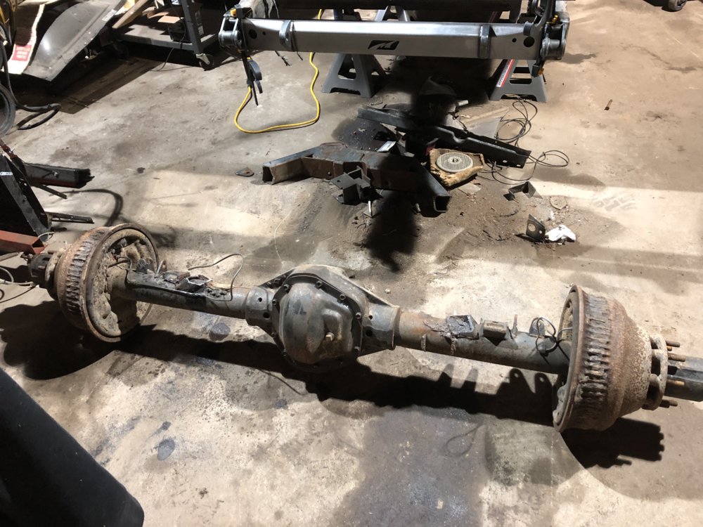

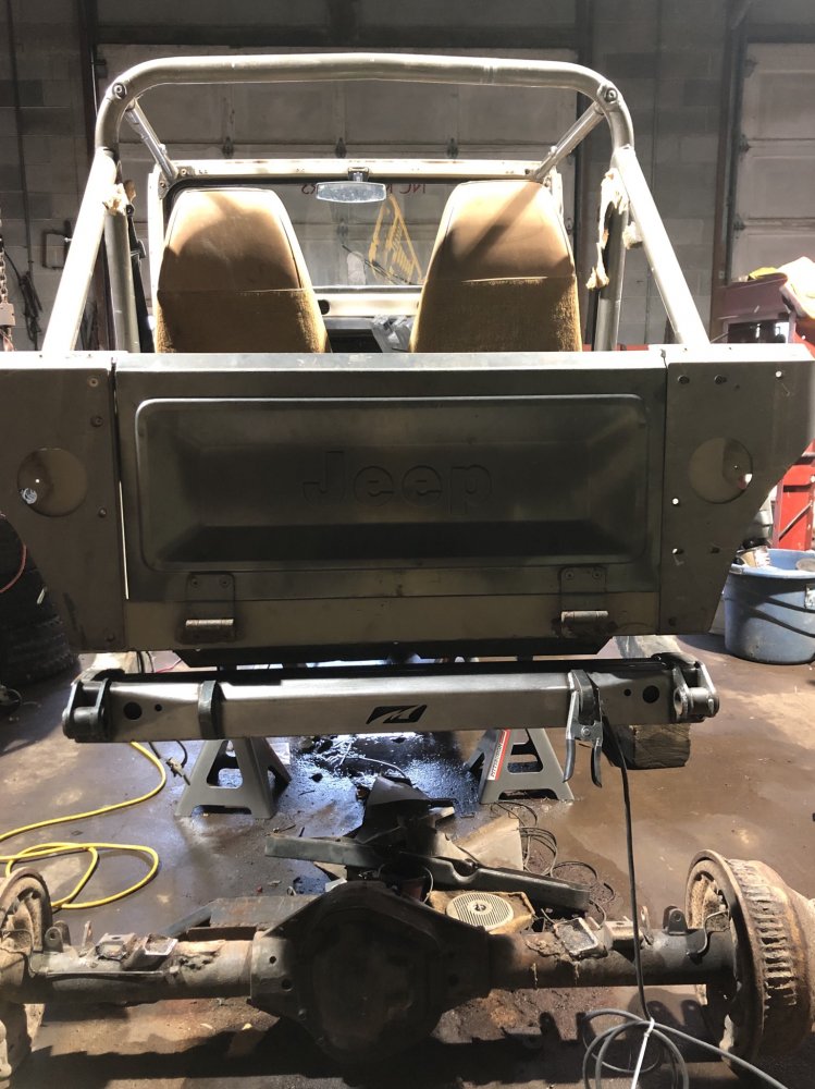

Next up, I cut the rear crossmember out for the stretch kit. You don’t have to do this with the Motobilt kit, but this one was rough so I’ll go back with a 2x4 .120 wall crossmember before welding the spring hanger/ rear bumper on.

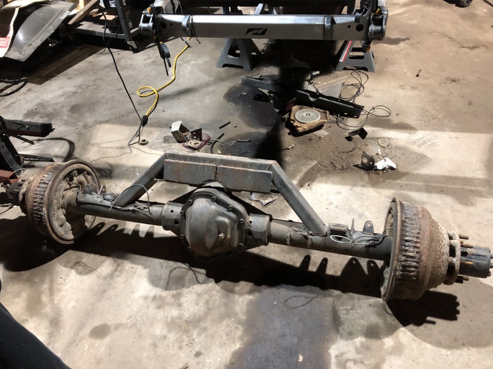

Finished cleaning up the front axle tonight then chopped the truss off the rear before calling it quits tonight.

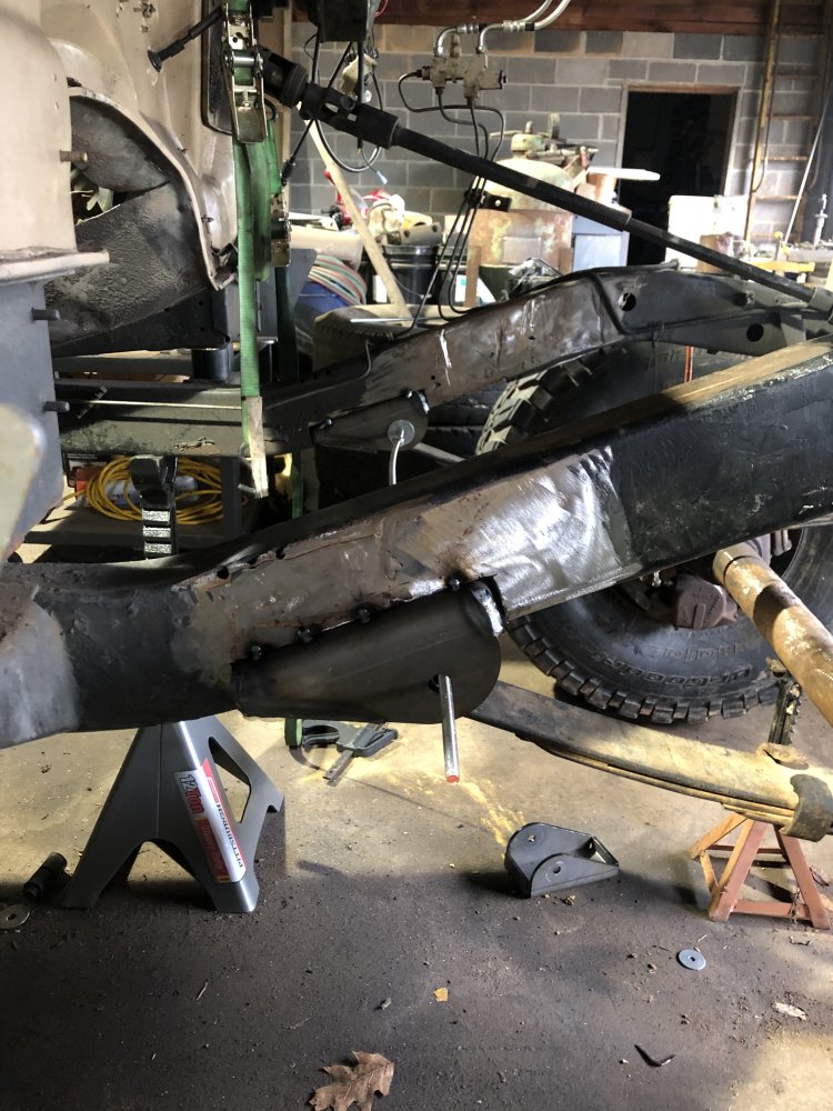

Really I’m just finding stuff to do while I overthink the frame side spring hanger locations and whether or not to French them in.

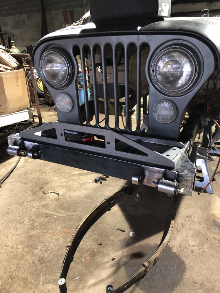

Managed to get an hour or so in the shop this weekend in between rain and other projects. Got the 2x4 rear crossmember cut and burned in, then the MotoBilt stretch Kit tacked into place. Not much progress but chipping away an hour at a time.
No pictures, but the 37’s and H1’s are on the front axle and rolled underneath. Just need to set the drivers side perch and burn it in.

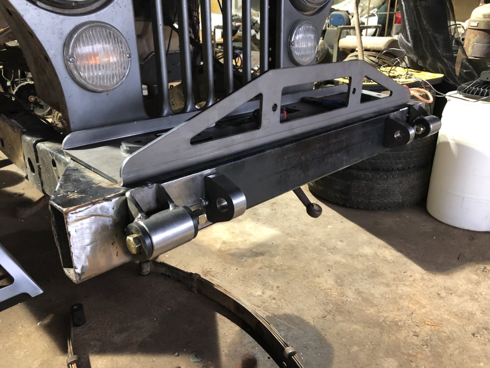

I suck at taking photos when working but the front end is all burned in and frenched.

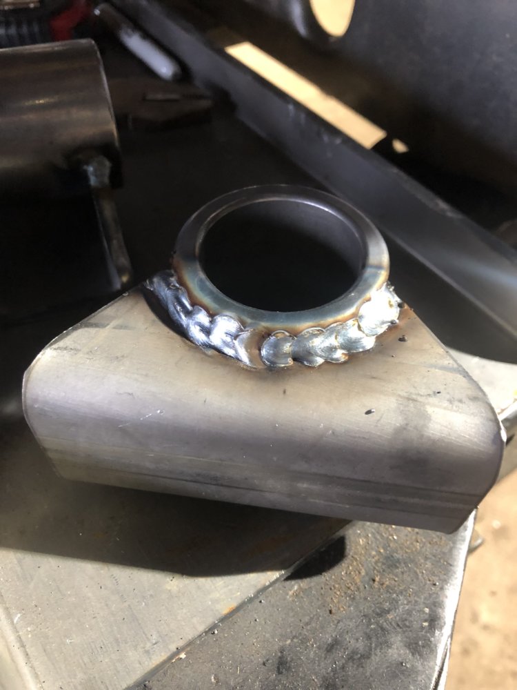

Front spring perch is heavy tacked and ready to set the front end down on the axle. Rear bumper/spring hanger is finish welded as well with the frame marked to be cut next time I’m in.
Ignore the giant bend in the allthread. It was just slid through there to hold the springs in place at this point. Some washers and nuts on each side made a nice jig to get the spring hangers square and evenly spaced.
