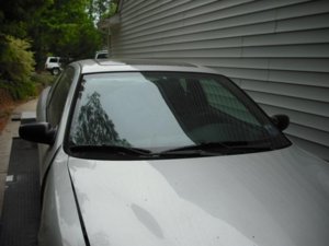

No idea what to call it yet, not even sure at what its gonna look like at this point..
But I picked up a 2000 cavalier for the engine and am planning to do a low budget transaxle type buggy. Plans are to gut the car for usable items, rad, brakes, pedals, and sell off the rest.
Plans, 2.2 Engine, 5 speed, 35-36" tires, light weight <3000#
toyota axles, hydro steering, linked, byond that no real plan.
Timeline = NONE so don't ask for daily/weekly updates, maybe monthly progress at best..

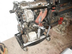

motor is out... (though it needs a little work) along with radiator, mounts and many other items I will reuse to keep the costs down on the project.
How are you planning the transfer case set up?
no tcase will be using 5speed transaxle. It has ~4.1 spur gear type r/p in there. Plan to find/make a spool or last resort weld it. Carrier is around 7.5-8" best guess so I should be able to make something fit.
That's the same drivetrain that's in my GF's DD. Finally something a Sunfire is good for.
no that's just the engine its sitting in a stand I whipped up and thats sitting on a small dolly thing, engine is roughly 20" wide x 24" tall x 22" deep
its really not a high HP engine, 120hp/140# but I like it. This one needs a little work :) Granted its a cast iron block but there really isn't much block there, and the head is alum. The intake is plastic and all the accessories are about as small as they could make them.

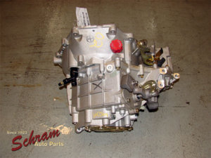

I'm still looking for the 5 speed I want to use. Needs to be from a 2000-2002 w/ 2.2 (not ecotec) I've seen some really cheep on ebay. The transaxle weighs ~107# so its just light enough to be shipped... I may go that route vs spending time/$ at junk yard...
... I thought you sold this thing already??
I'm planning to use a F23 transaxle. It is short 3 axis/shaft 5 speed, and has good weight to torque capacity and considering it will be used as a t-case and not the final drive as in a FWD car it should be pretty solid... and compact which is why I want to use it.

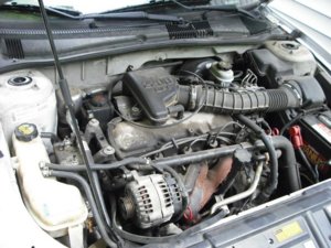

ok.... some better pics....
Transmission shifted by cables? If so, thats good, you don't want to fool w/ solid shifter linkages... My new transmission is cable shifted and I've about got the cables shortened and modified enough to fit, wasn't bad to do at all.
Whats the gear ratio? Hope you don't plan for it to hve a great top speed, OR a really low crawl gear. I've figured on mine w/ the 6 speed manual it will top out @ 5 mph in SL (super low), and 30 mph in 5th gear (around 5K rpm's). 5mph seems fast to me for a crawl gear, and I doubt the chevy transmission would be geared very low. Just guessing I would bet you might be able to hit 10-15 MPH in 1st gear.
Good luck w/ the build, I'll definetly keep watch on it, maybe we will finish at the same time :)
yes cable shifted. ill reuse a factory shifter setup. no plans for top speed.. (I figured out how to multiply the numbers together :) )
