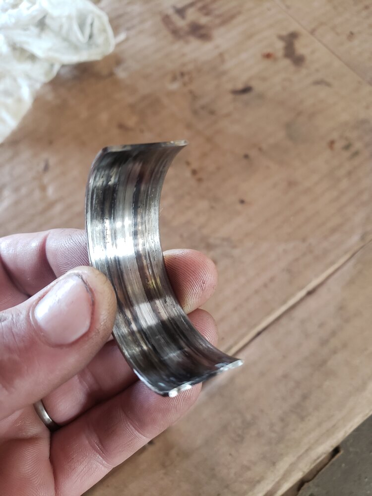

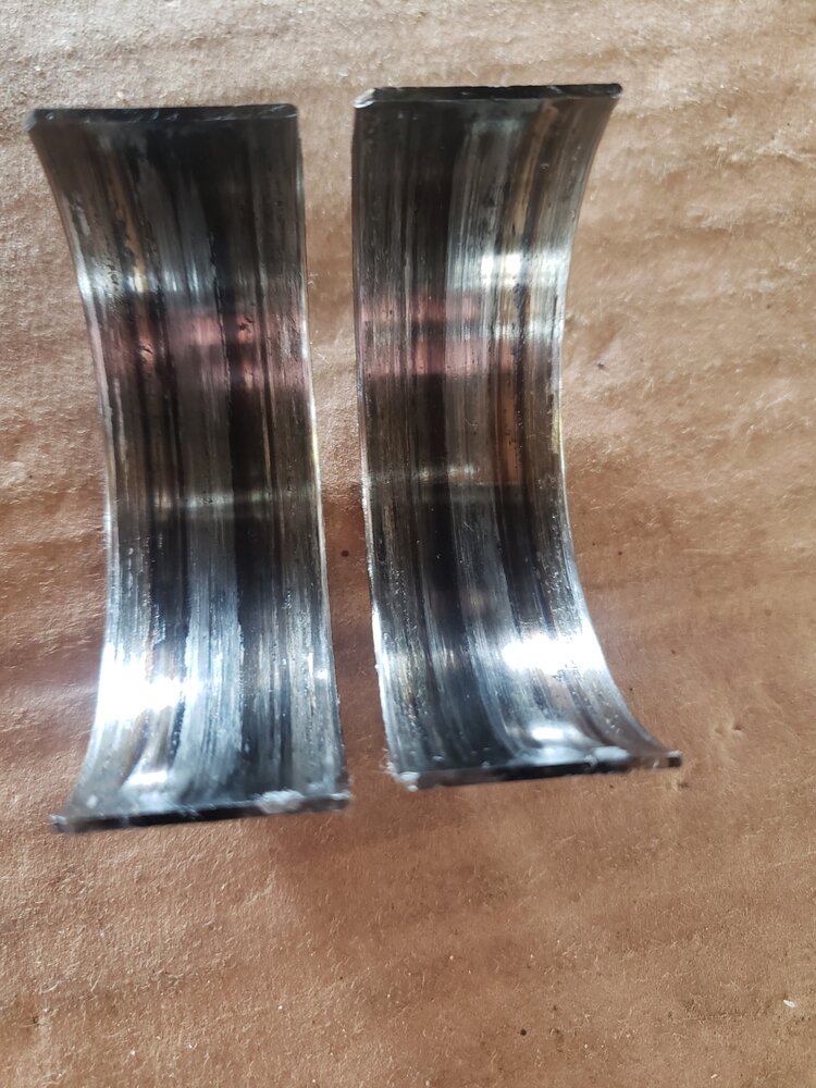

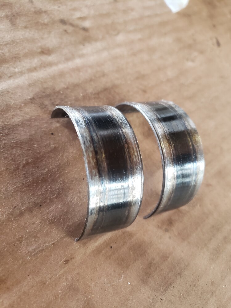

Ok it spun for sure. Crank journal is perfect shape, rod is smooth also with black markings like underside of these bearings. I'm assuming I'm lucky enough to put new bearings in and send it for my uses?
Thanks guys
