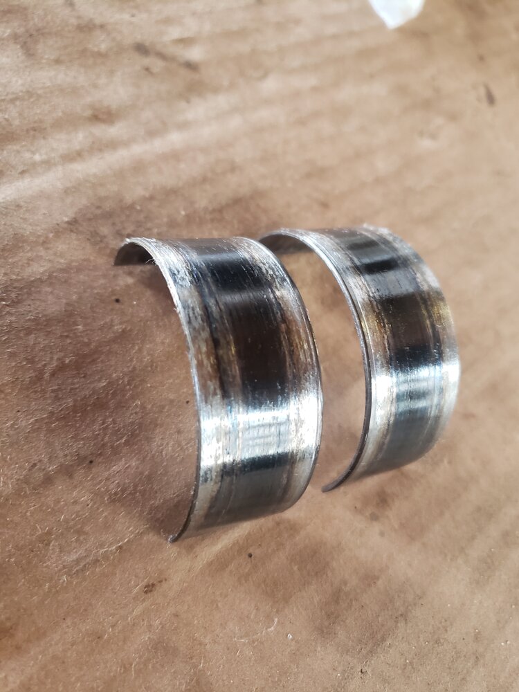

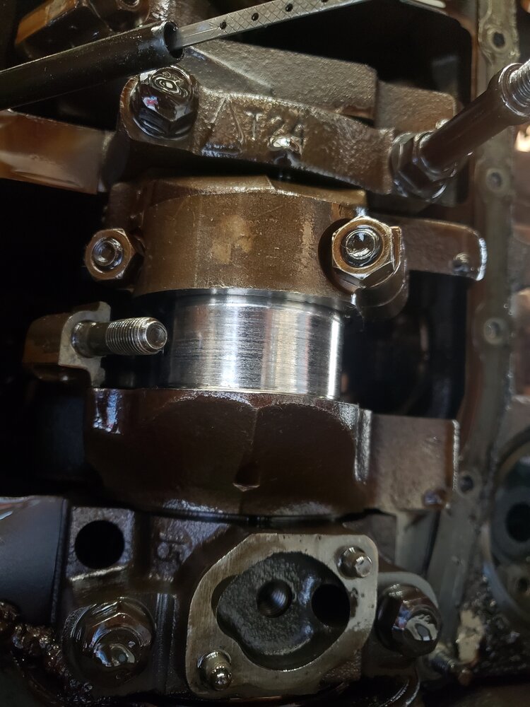

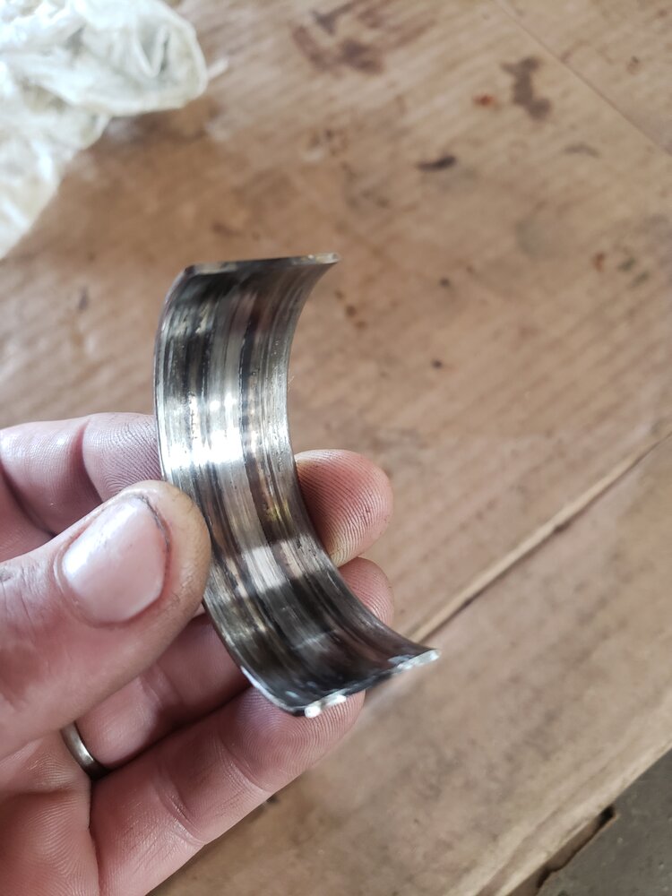

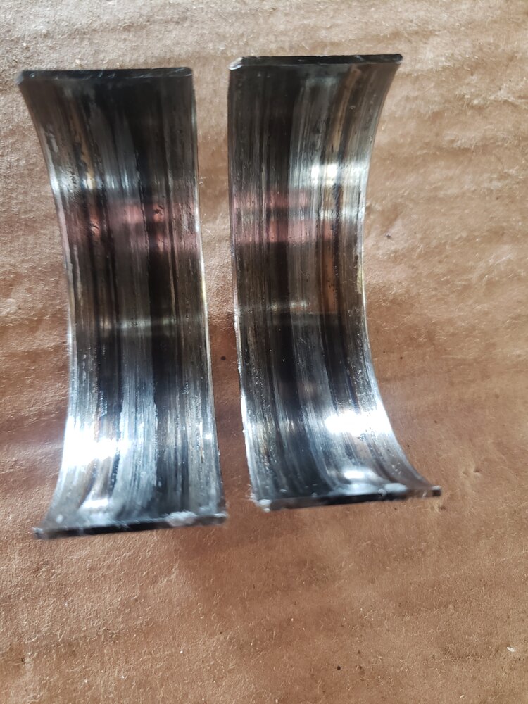

spun bearing? I think, little play SBC 5.7
Also, rod side doesn't really matter because it should be stationary.
Its Smooth with fingernail trick lol
When a bearing spins, it eats into the rod, so it wouldn't take long before it spins again. The rod needs to come out and replaced or (and this is what they do to most rods when doing a rebuild using the original rods) take it to a machine shop and have them to clip both the rod and the cap, and then hone it back to"round" and correct size. Not the right way but the crank needs at the very least polished like what was mentioned earlier in this thread.
Polish it up, buy a stock bearing, and send it.

I'm wanting to understand what causes this? Like how can cylinder 8 spin a bearing and all the others, especially 7 right next to it on the same crank journal, still be perfectly fine? For that matter, how come usually only one rod spins and the others usually from what I'm reading/gathering will not? Now I'm just wanting to learn what causes this since apparently it's a pretty common issue among these SBC motors. thank you
The fastest way is to just focus on the crank, slap a bearing on it run 15w40 and send it to the moon. Either way that motor is living on borrowed time.
I'm very well aware this isn't the "right" way to fix it...I'm still gonna get that other motor from a friend but I want to put it on a stand, go through it completely before going through all the work of swapping so I'm just trying to get this one to allow me to play on sundays couple times a month for a while until I get the other motor ready to drop in.

High revving would cause other issues like bent connecting or push rods. Spun bearing is almost always trash in the oil causing extra frictional wear causing gaps = spun bearing.
well I guess trash in the oil it is.

Bearing problems are always an oil problem. Only related to rpm if you don’t have 10psi per 1000rpms. So at 6k rpm’s need at minimum 60psi.
But if using cheap oil/filters or dirty oil etc this can wipe a bearing quickly.
The oil pressure keeps the bearings from actually touching the crank journal itself.
Bearings spin when they touch and gall onto the crank and then spin with the crank.
