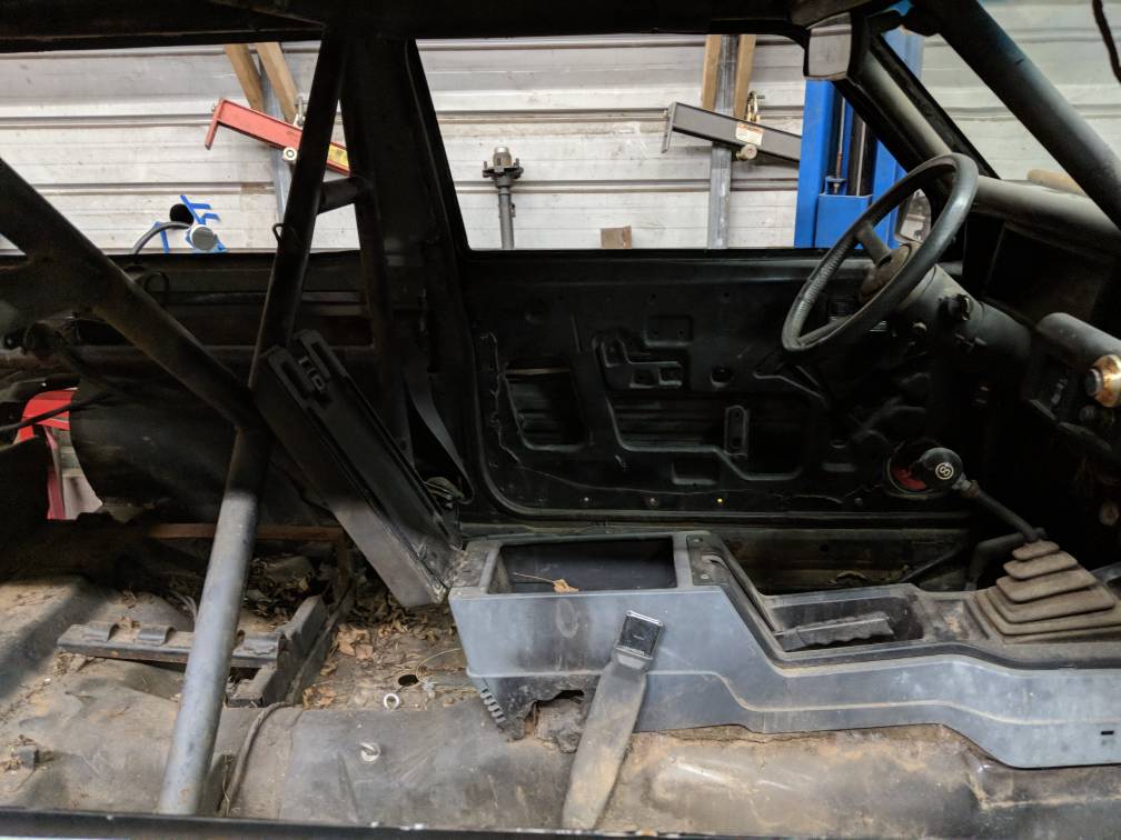

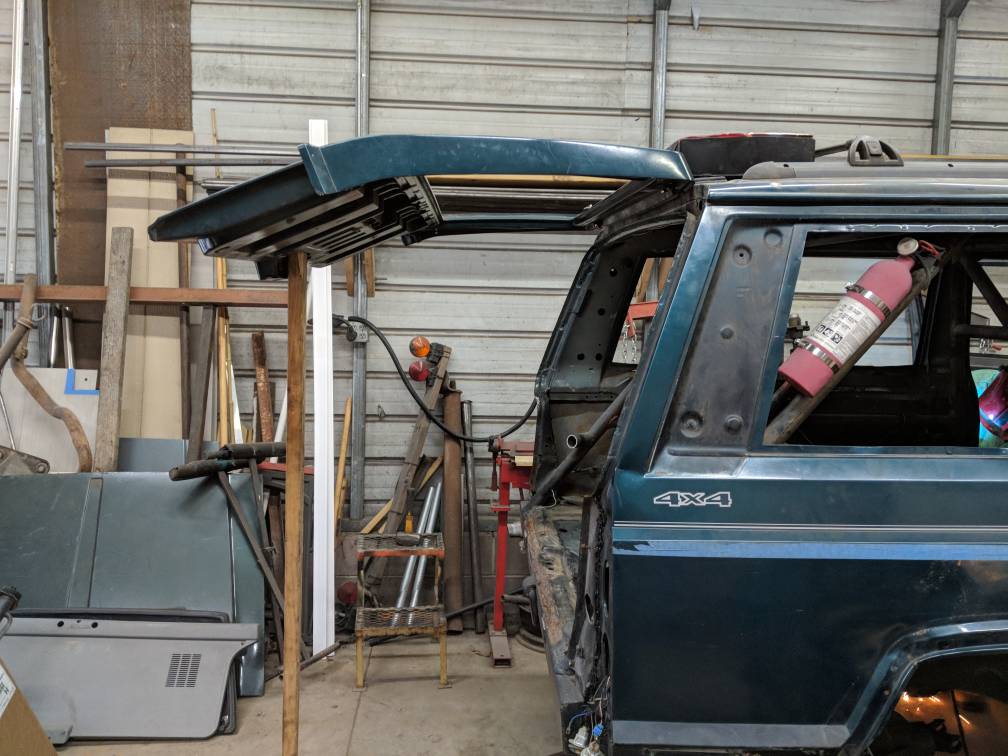

I picked up a xj that was built in my shop a few years back for ecors and I am trying to get it ready for KOH in one month.
First part was to make it legal for stock class which means it needs to look 100% stock.

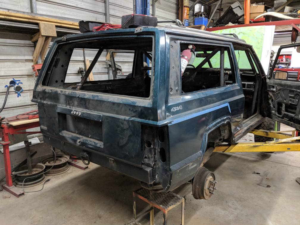

Well as you can see in pics it was cut up so it needed a roof. So i.picked up another xj and cut the roof off it and graphed it on today.
Took about 7 hrs.
No guarantee this build will be done for race day but I am gonna try. I am going to KOH no matter what so this should be fun

Looks awesome
Wow, where’d ya dig up the 88? Roof grafting to get an XJ stock-looking...yeah this could get crazy. I guess that would easier/cheaper than doing another cage in a stock XJ

I knew the guy that bought the 88 from the guys. Reached out to him and he was ready to sell.

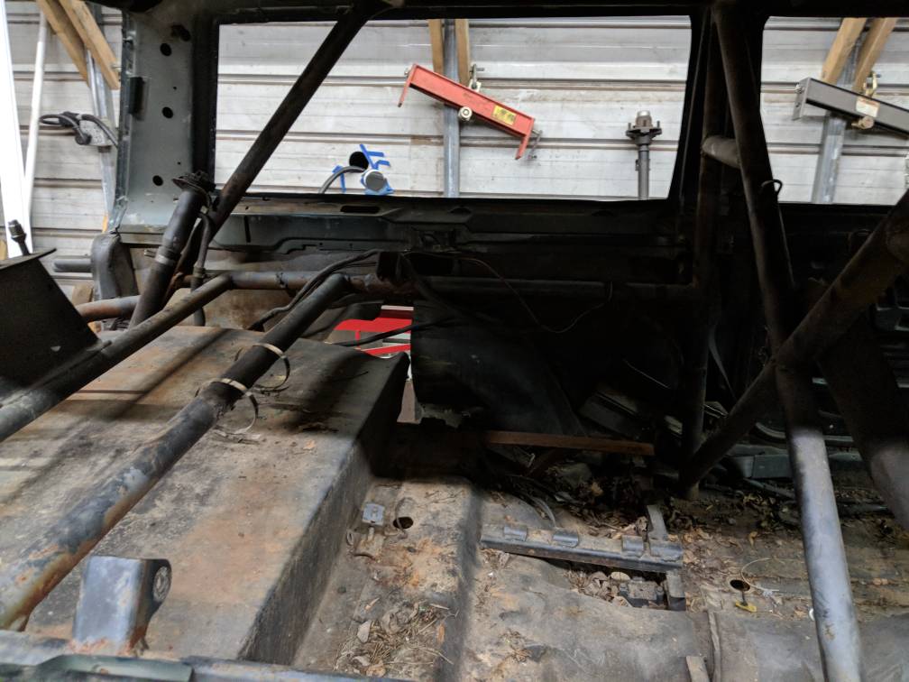

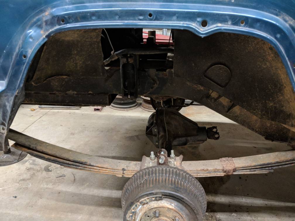

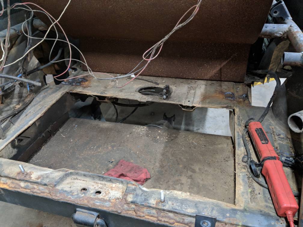

Making progress

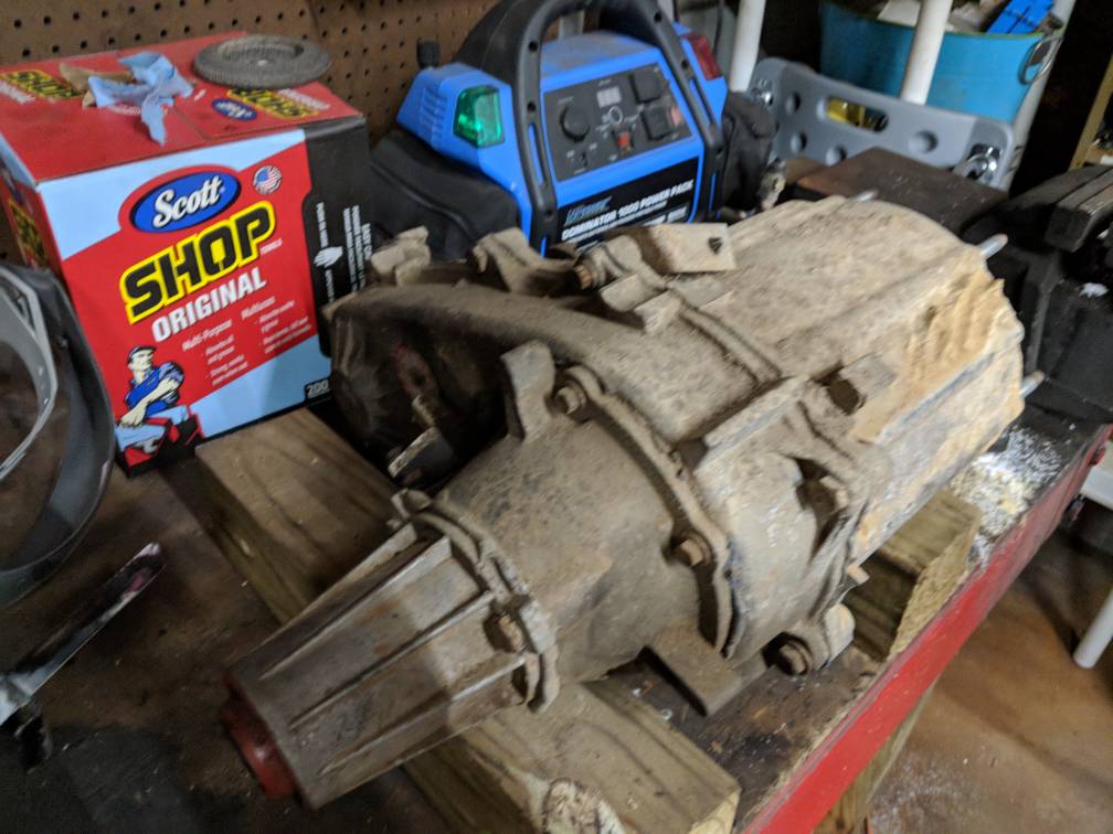

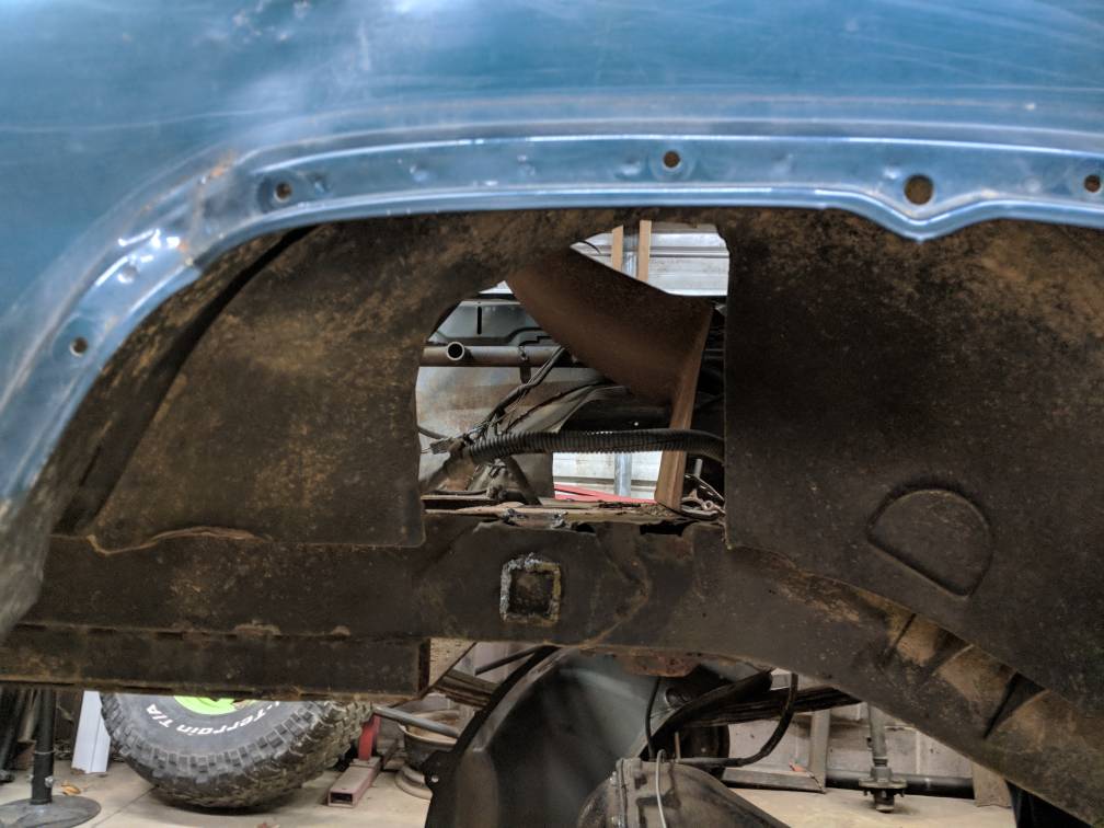

Seats are out. Rear shocks and bumps are out so I can close in rear inner fenders. Transfer case is also out.
Sent from my Pixel 2 XL using Tapatalk

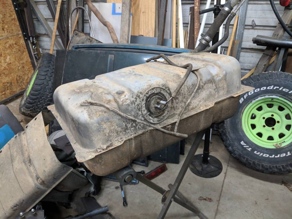

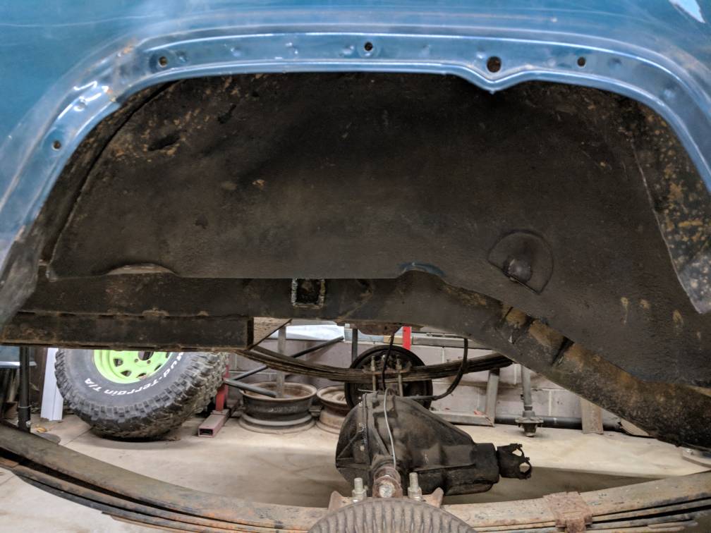

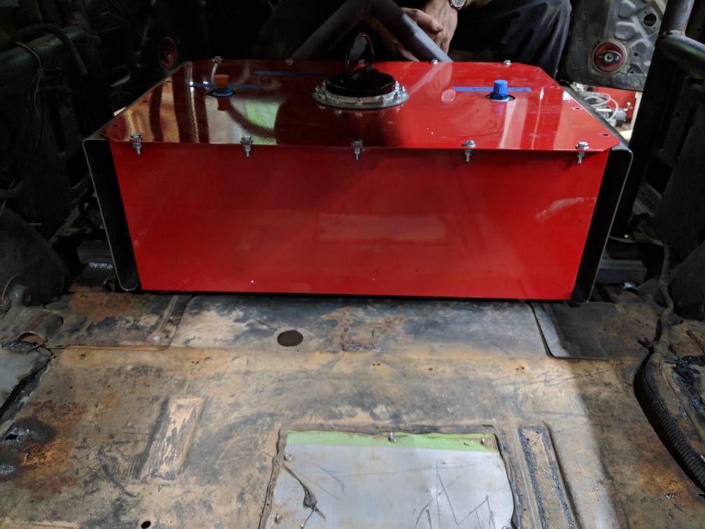

Gas tank is out. Measured for new fuel cell and ordered.
Inner fenders fixed.

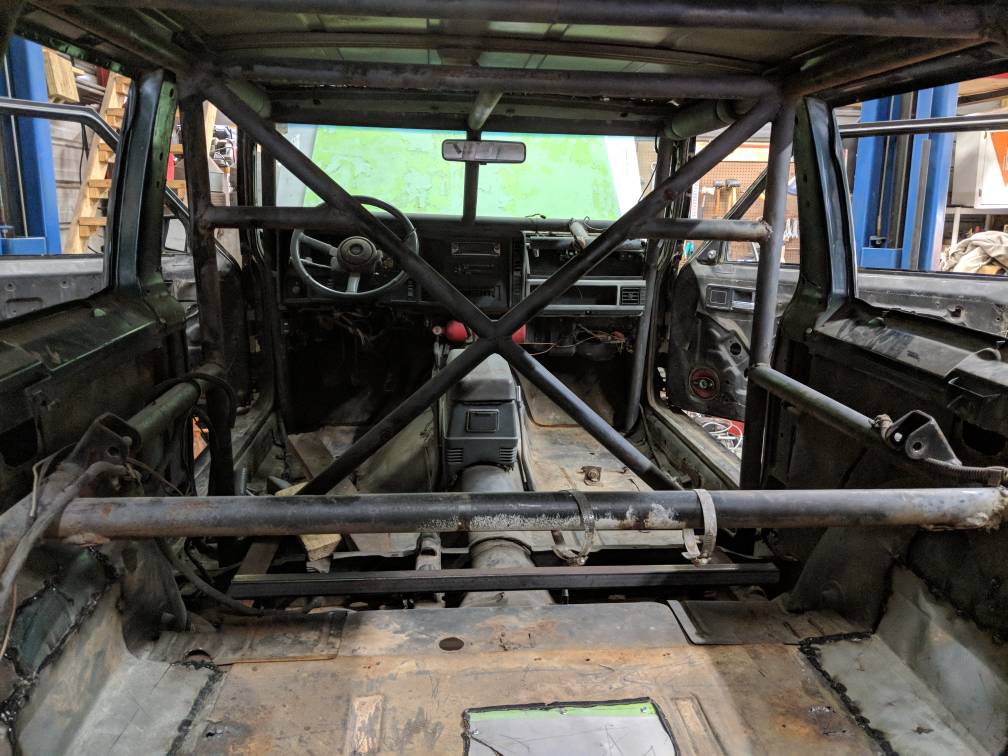

Making more progress

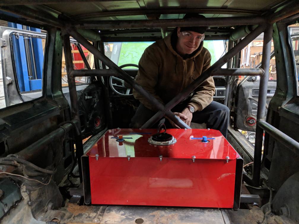

Staying at it
Window nets in
Fuel cell in place

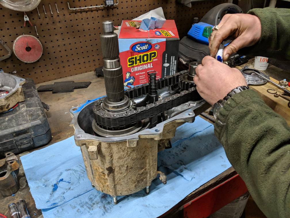

Transfer case rebuilt with sye
Body is fully welded.
