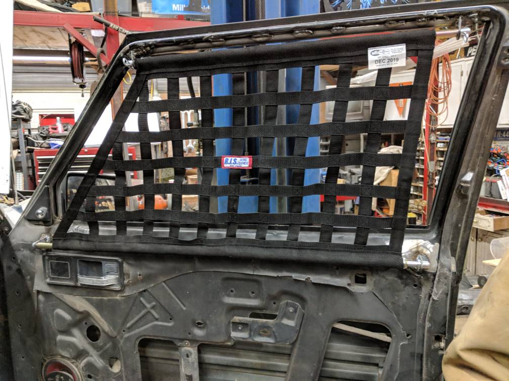

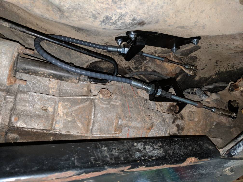

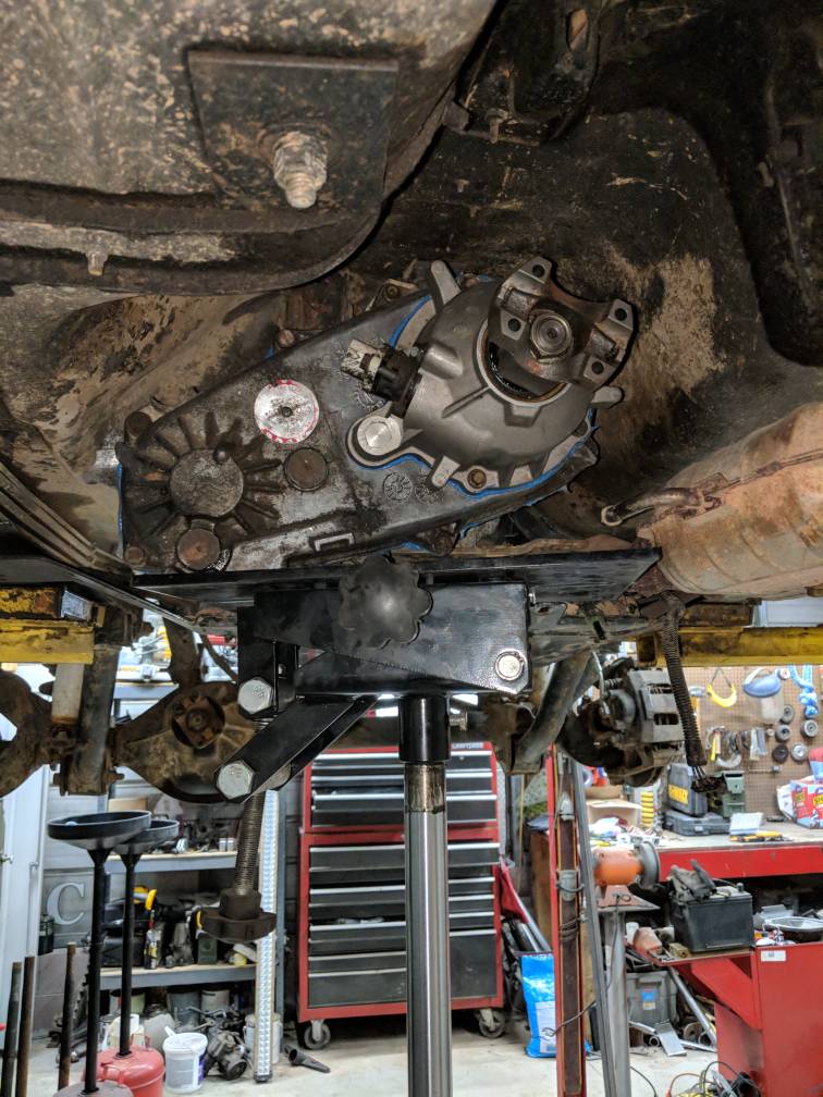

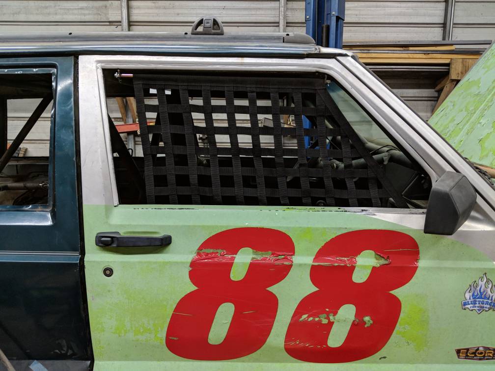

Window nets, transfer case in, cable shifter in, fuel cell mounting done. Now i do other small stuff until parts arrive Friday
Sent from my Pixel 2 XL using Tapatalk
Nice! What Cable shifter is that?

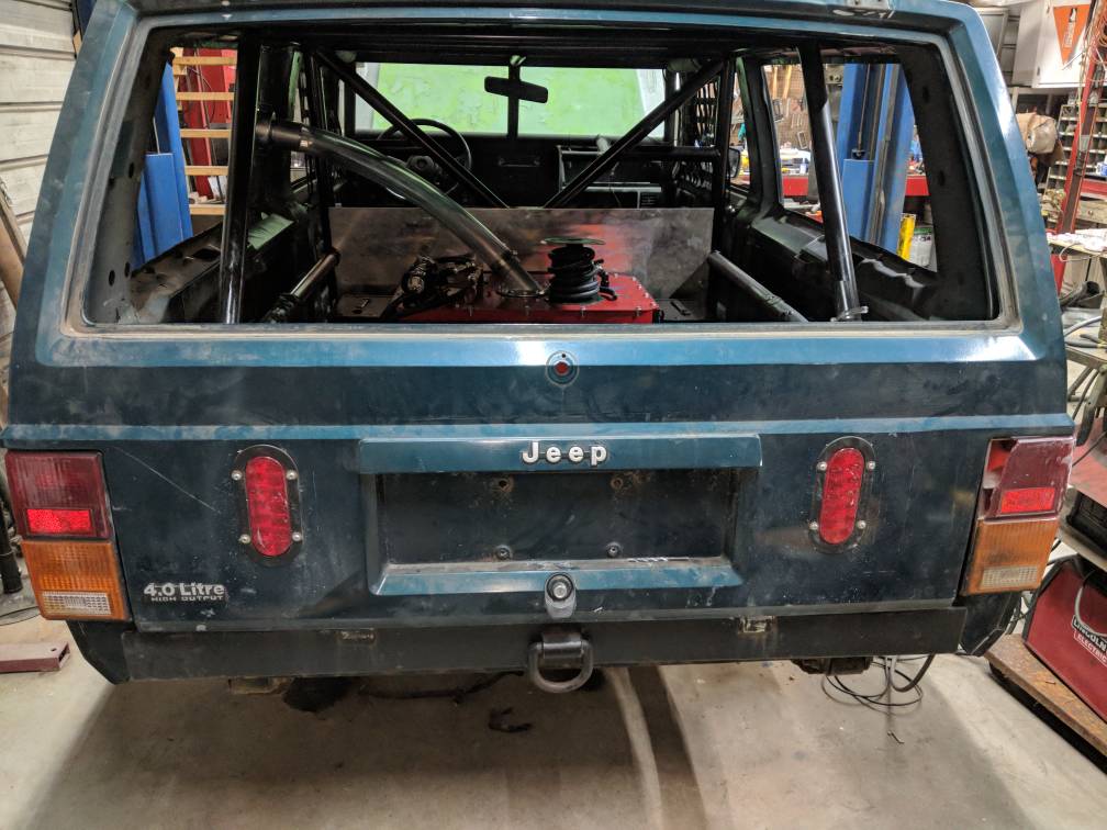

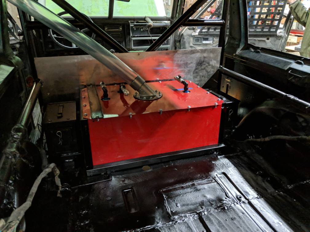

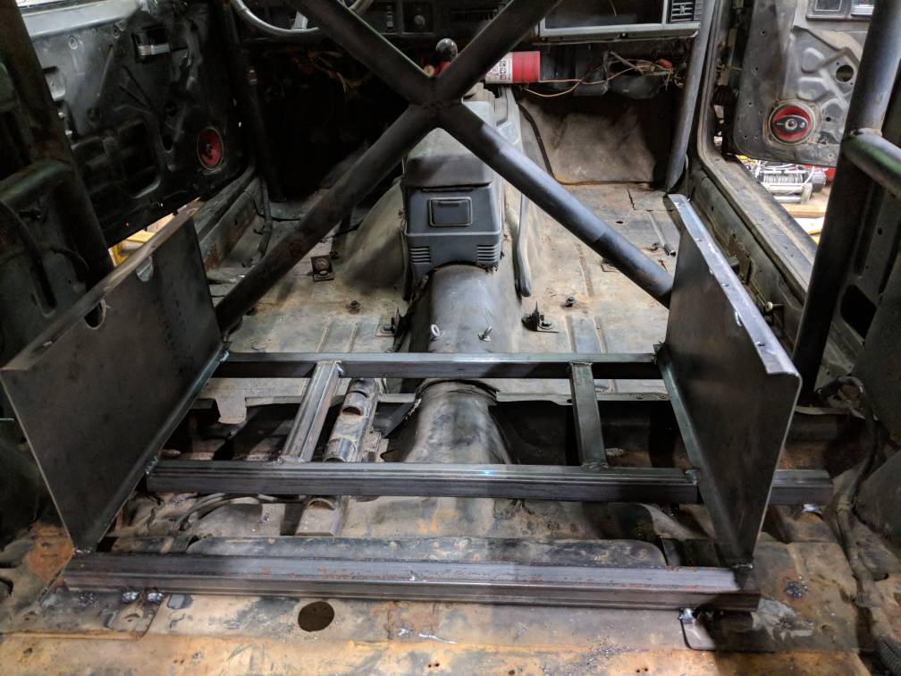

Long day in the garage. We added tube to bottom of cage x for seats to mount. Finished entire fuel cell mount and installed fuel cell. Added storage cans next to fuel cell. Cut front bumper to correct length. Made master kill switch plate. Mounted new battery holder. Firewall between seats and fuel cell. Hopefully we can get it running again.

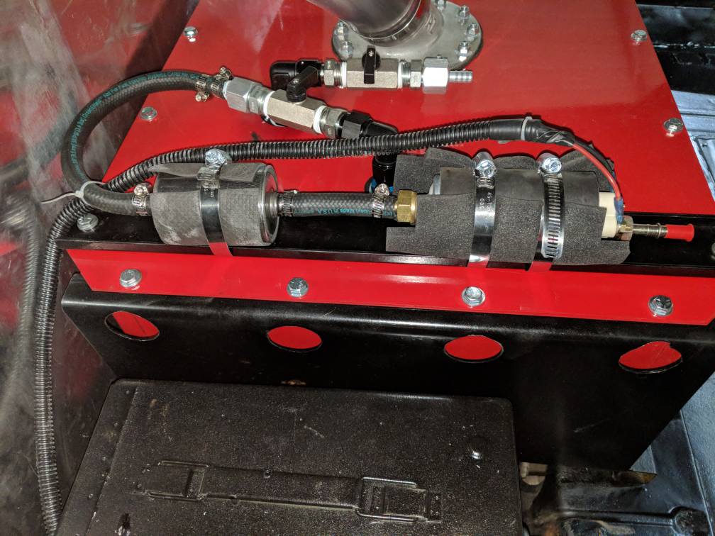

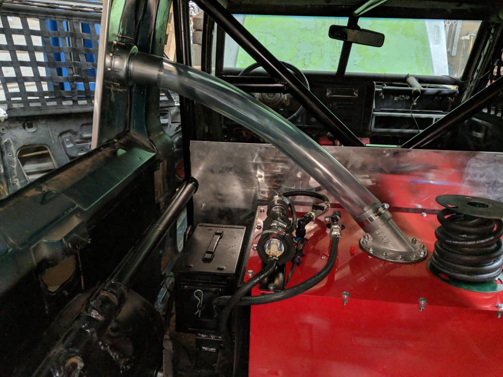

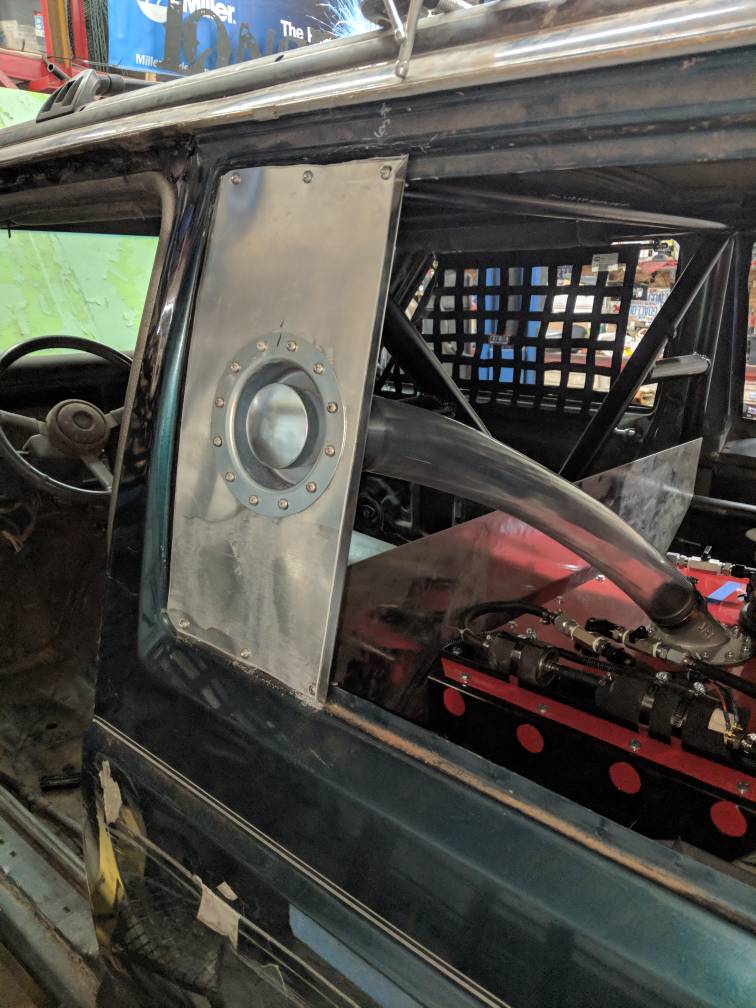

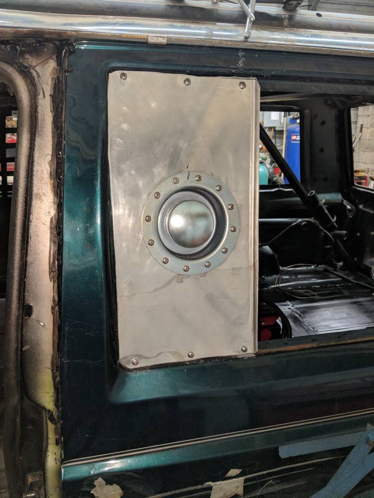

Short day I'm the garage. But making good progress. Fuel system plumbed and wired. Fill tube in place and rear extra lights installed.
