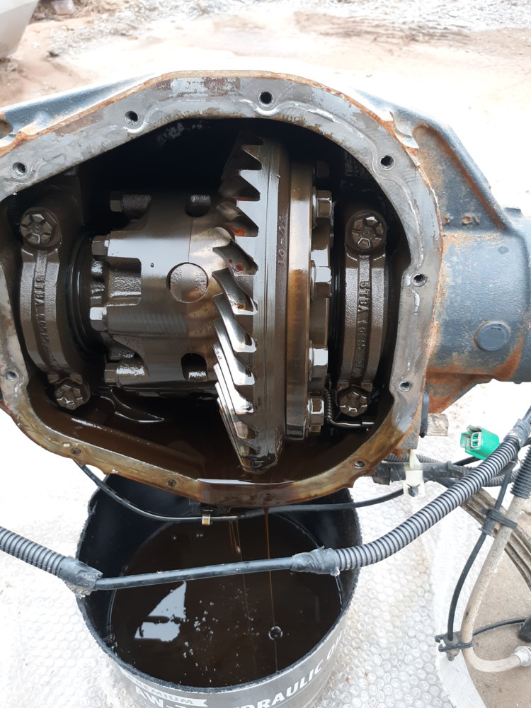

also...the 2012 and up offered an e locker in the f250s. I just scored one to put in my 07 axle. Green plug fancyness
No uggaa or duggas, just snugged them up until the shanks didn't spin and then torqued them to whatever the specs were.
