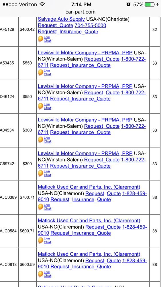

I was looking at the yards yest. Fronts were ranging from $300-1000 around the charlotte area. Those were 99-04, but 05+ are typically the same price.
Typically of you see an individual selling (not a yard) they are higher.
I got about 4-5 pages within 200 miles of Salisbury...some more expensive than others...

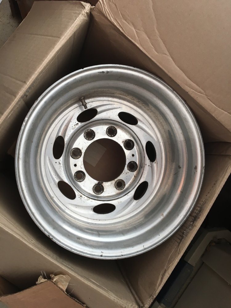

What about the different bolt pattern,8 X170mm versus 8-6.5?? Wheel spacers??
Or a template to redrill the unit bearing/rotor assembly and press in some new studs.
I personally just don't get the typical rush to 8x6.5 as the must have lug pattern. Just use a Sterling rear, they'll take a hell of a beating and if someone is concerned about breaking one, they are doing more than just a budget build. Any number of companies now make 8x170 beadlocks now or get 17" Ford steelies and do a weld on kit.
X2. These days 8x170 wheels are as easy or easier to get than 8x6.5.
Also, alot of ppl look to switch to smaller brakes up front. redrilling the pattern then is even easier. Spidertrax and others sell different pattern hubs for the 99-04 axles. IIRC 05+ cant be converted to anything smaller than 8x6.5 either, if that is a concern.
Yeah, I wouldn't be too worried about the bolt pattern. Honestly, the only perk for the 8 on 6.5 to me is H1 wheels in their stock form. And I can handle the redrilling of the BP if necessary.
8x6.5 lug pattern is becoming the new 16.5" rim...obsolete. And I agree, anyone looking to swap in stock axles, the sterling will be more than enough for them. I bought these weld 8x170's for $150 long before I even had my first SD axle.
Yup. Nobody wants to buy that shit anymore. I'm redrilling all my trailers and trucks to 8 on 170mm.
Won't be an immediate transition, obviously...but give it 10 years. A decade ago you could still get a tire with 16.5" rims damn near everywhere in any size with any brand. Today you basically have interco and scant few others over 35's.
