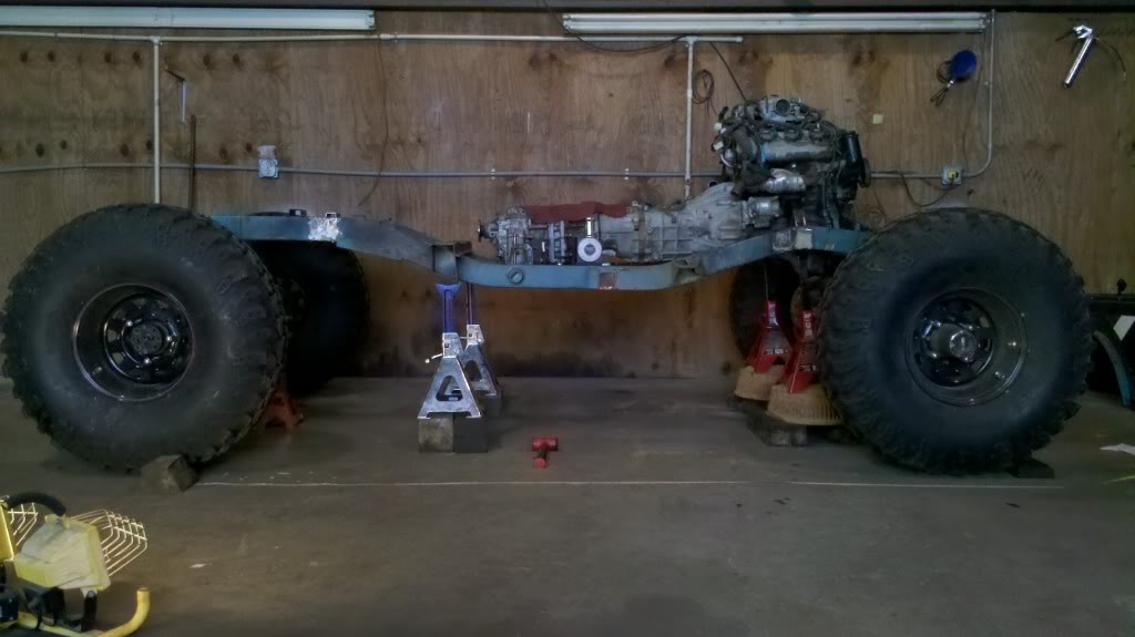

Now both sides
ai878.photobucket.com_albums_ab350_StuntmanAutoworks_My_20Samurai_1047142621_photobucket_38717_.jpg

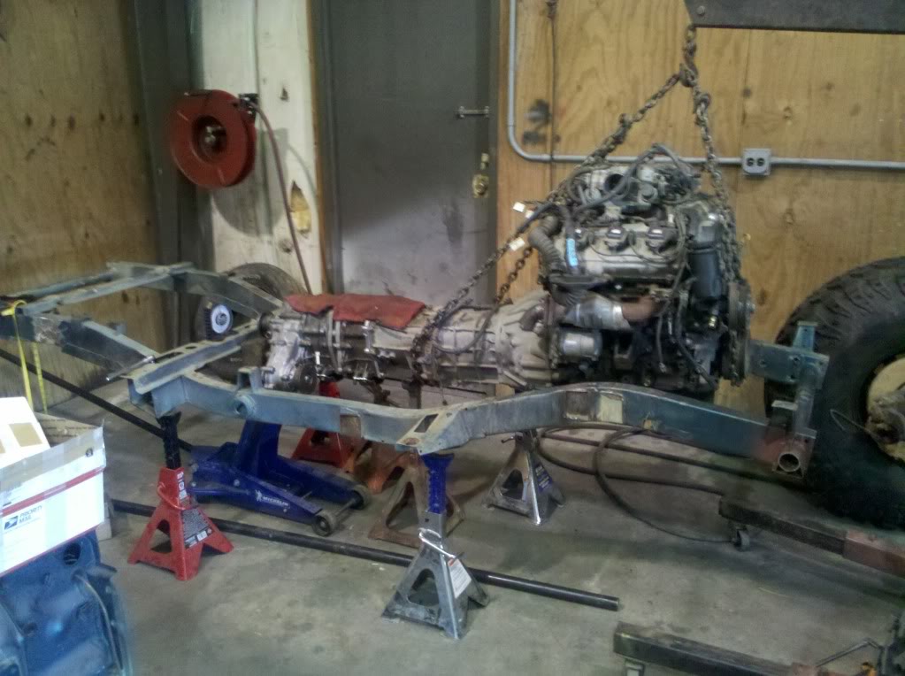

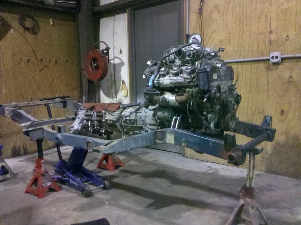

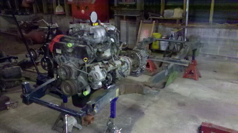

My engine and trans with no mounts
ai878.photobucket.com_albums_ab350_StuntmanAutoworks_My_20Samurai_2011_04_07_13_47_44_95.jpg

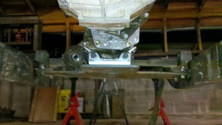

What I came up with for the motor mounts
ai878.photobucket.com_albums_ab350_StuntmanAutoworks_My_20Samurai_2011_04_07_19_46_39_674.jpg
Trans mounts still not done but engine mounts are
ai878.photobucket.com_albums_ab350_StuntmanAutoworks_My_20Samurai_2011_04_07_20_02_21_539.jpg

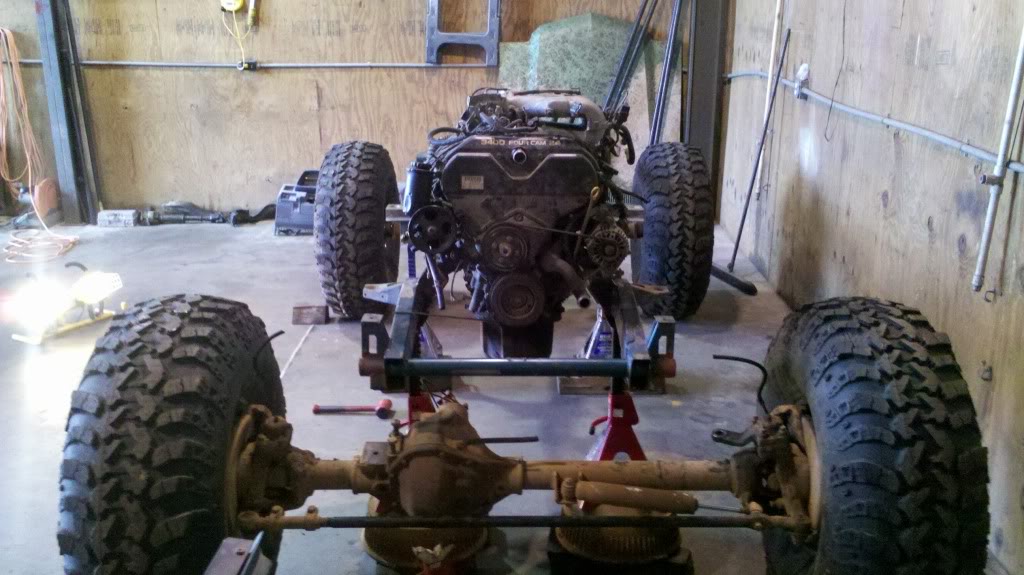

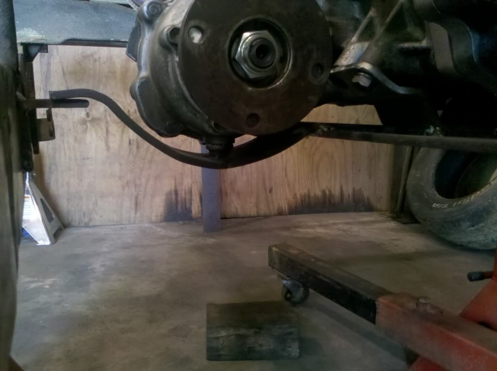

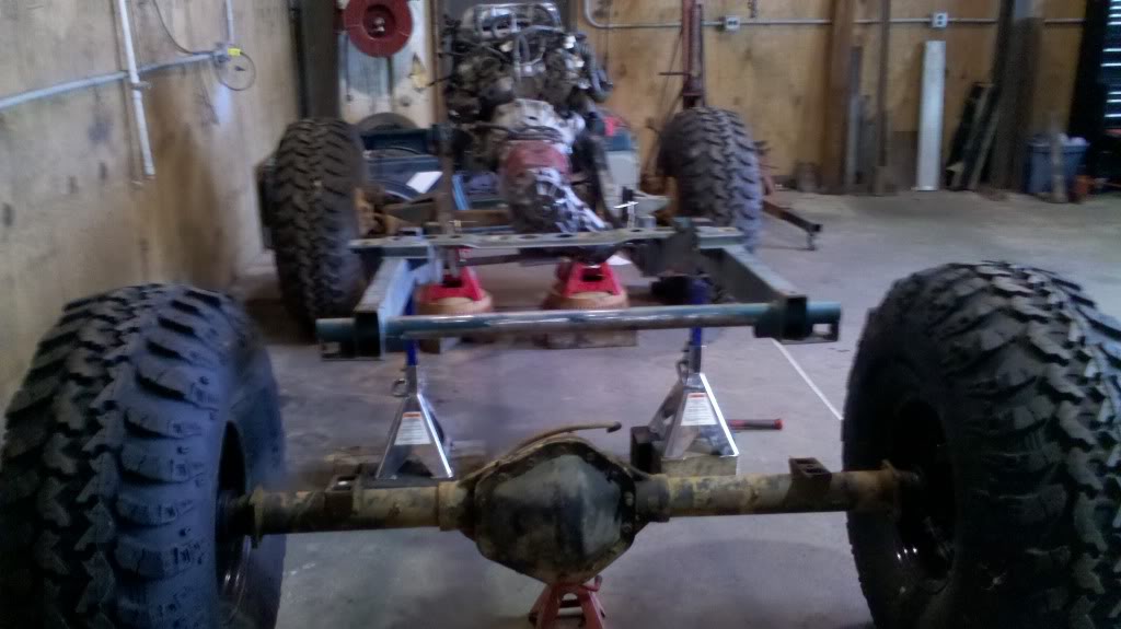

Got the frame and everything moved from the corner it was in so I could get my axles underneath it so i can start on getting my suspension links worked out It's going to be 115" wheelbase 4 link in the rear and radius arm setup in the front and in these pics it's 26 inches to the bottom of the frame rail which is a little higher than I wanted but once I change the frame up front over the diff and get some links made I can set the final ride height but this is pretty close for setting it up all by myself yesterday.

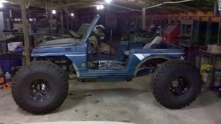

Ok its been awhile I've been working on this and been changing my mind to wanting a full tube chassis buggy then I realized 2 things: 1 why have a samurai all torn apart and not use anything except maybe the hood on a buggy, and 2 why build a full tube buggy with tons and only run a v6? So I decided to build 2 rigs I'm going to use my 3.4L 5spd and dual cases and yota axles I have and I'm going to put my samurai back together with some yj springs maybe a 4 link in either the front or rear to stretch it some, then once I find a good deal on a chassis I'm going to build an all out high horsepower V8 BUGGY with my tons. This way I can go ahead and get on the trail again with the samurai then later on have a buggy which of course will take some time, but any ideas, suggestions, or comments are appreciated.
Thanks

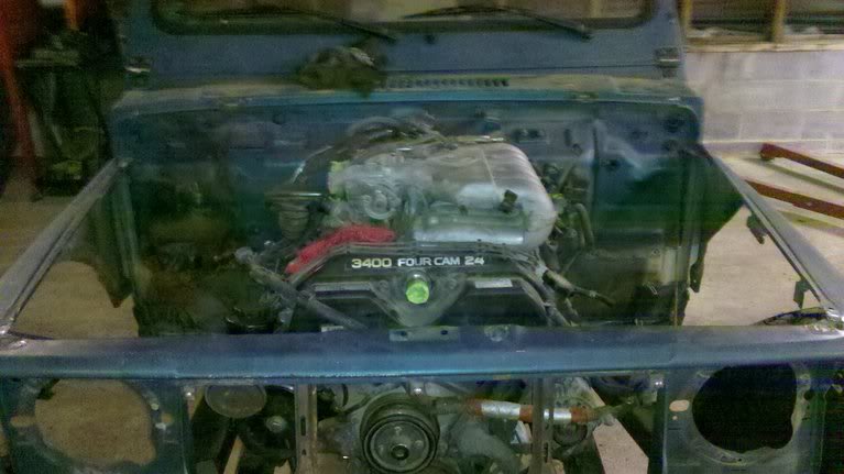

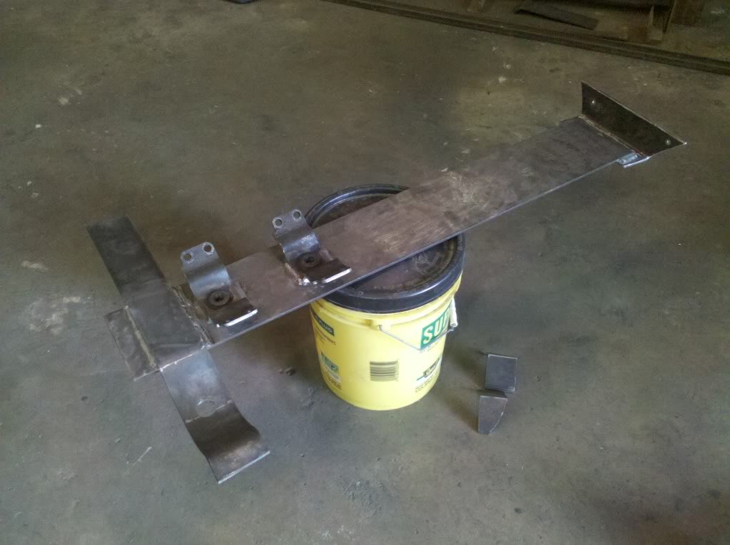

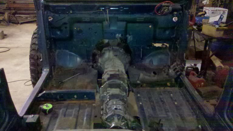

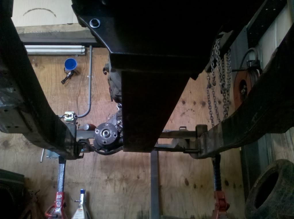

Well heres a few pics of my recent progress, I'm now using toyota axles 4 link rear and a radius arm setup in the front and probably use some xj coils. I'm not picking up the brackets until monday so I worked on the body some and got the new xmember made and mounted up.

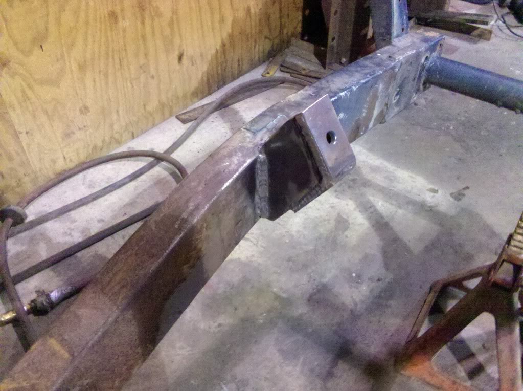

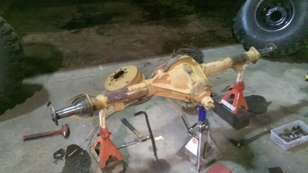

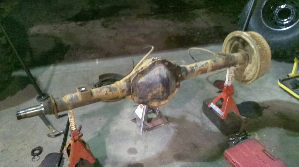

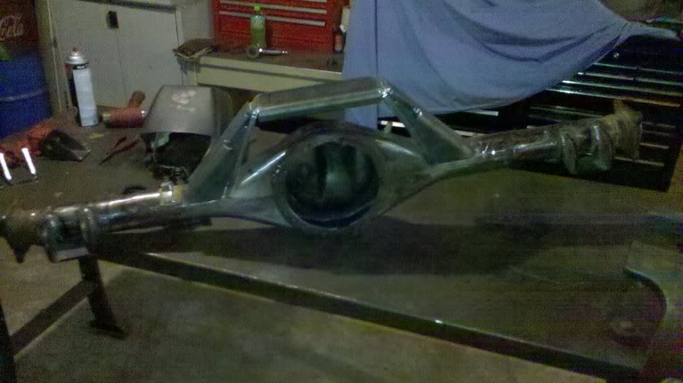

Trussed the rear axle and got the lower link brackets welded on
ai878.photobucket.com_albums_ab350_StuntmanAutoworks_My_20Samurai_photobucket_5695_1330827558478.jpg
