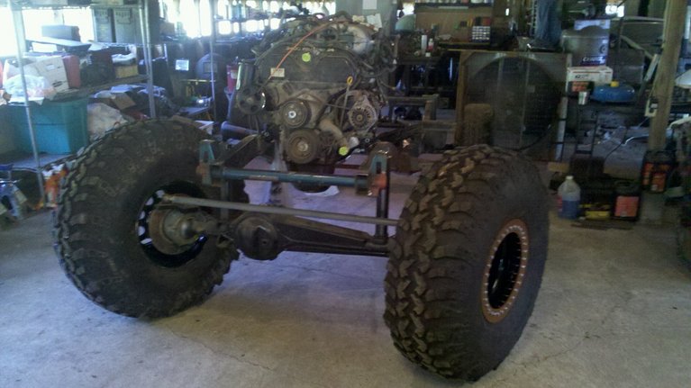

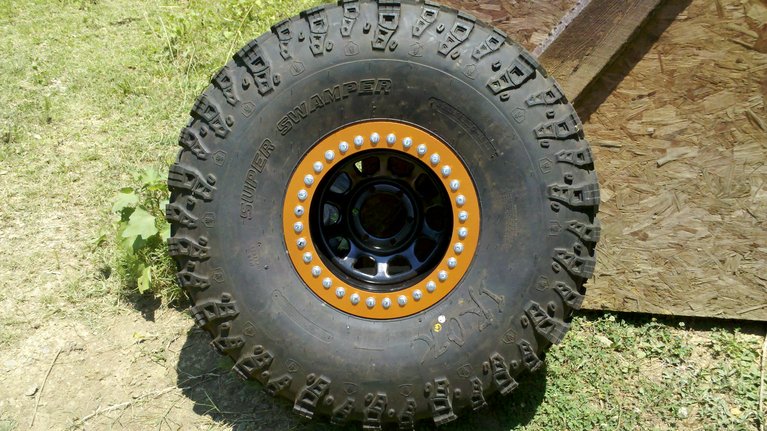

Its been awhile since I worked on my sami, I've been busy with work and been helping some friends on their stuff but this weekend I was able to get a little bit done. I got my lock rings painted and I mounted 2 tires on the beadlocks so now I will be able to fab up my front suspension. Here's a few pics and hopefully next weekend I will be able to work on it again.

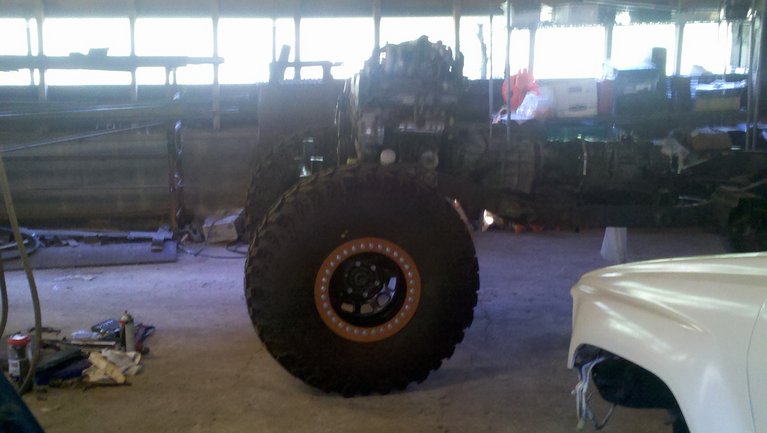

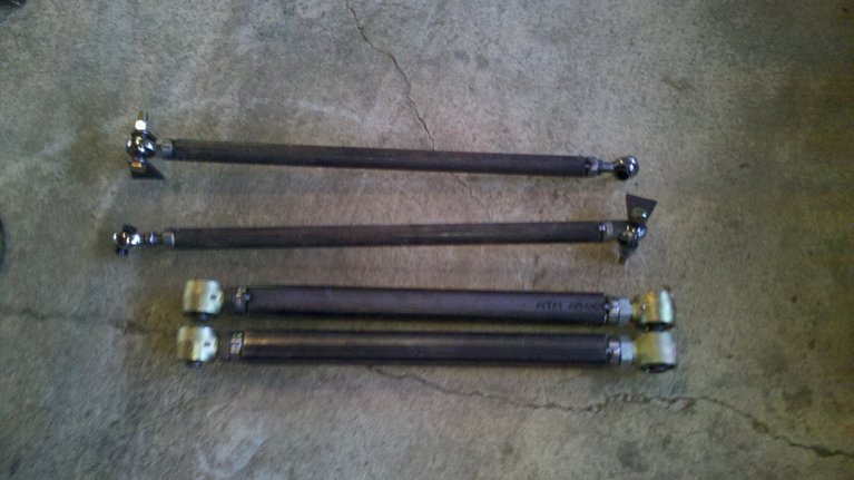

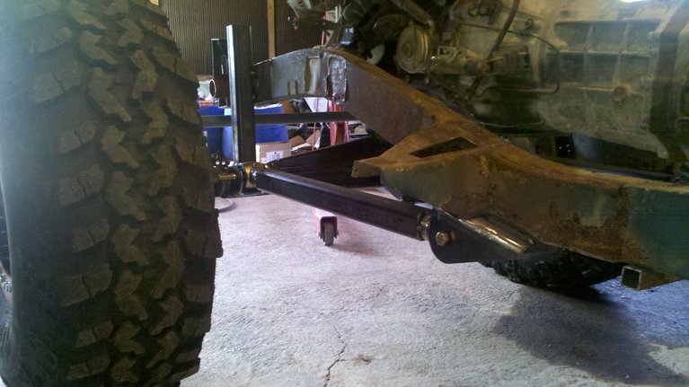

Been working on this a little at a time been getting a little done. Got my front links tacked up they are the same length as my rear links so I can make 1 spare of each upper and lower and they can go on either front or rear.

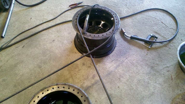

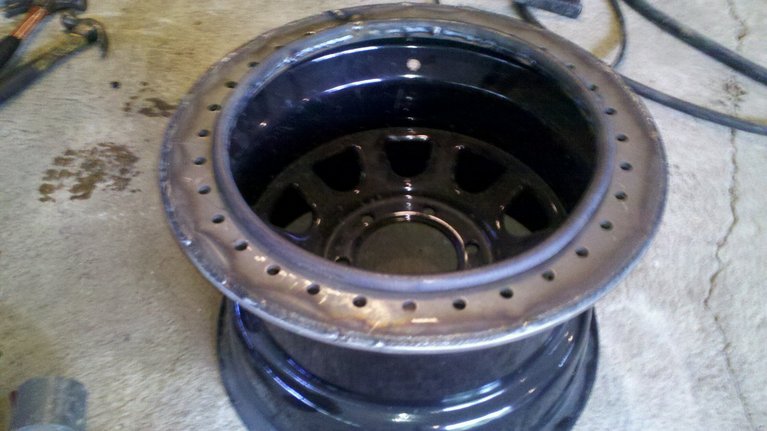

After putting my front 2 beadlocks together I decided to make an anti coning ring for the rear 2 rims I didn't have any way to bend up the rod, so I had to weld it and bend it around a little at a time.

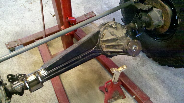

Also got my lower link mounts on the axle today.

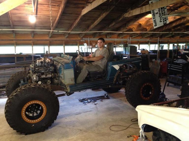

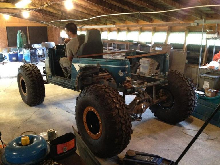

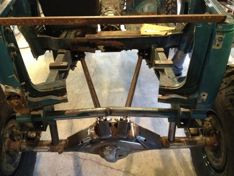

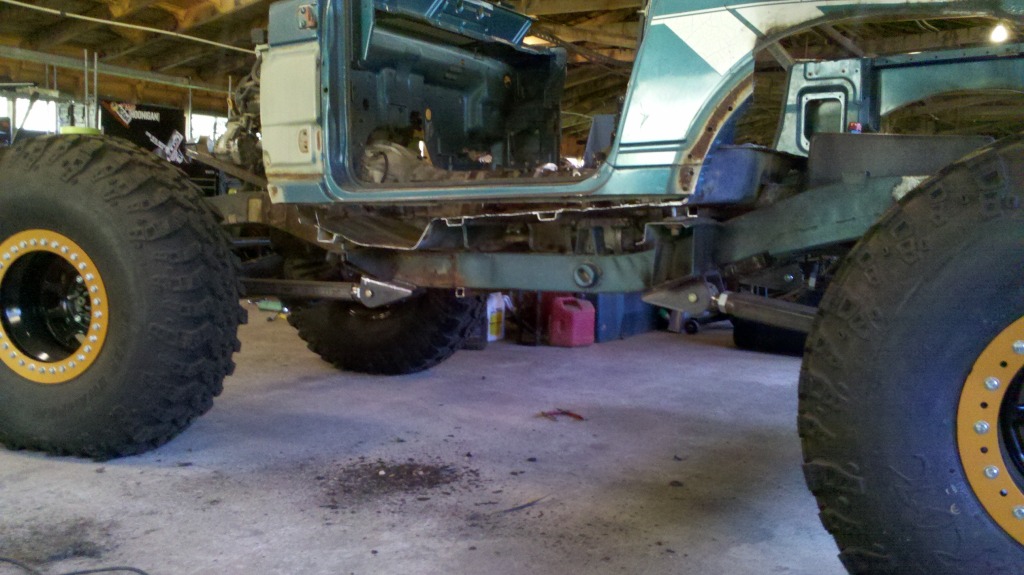

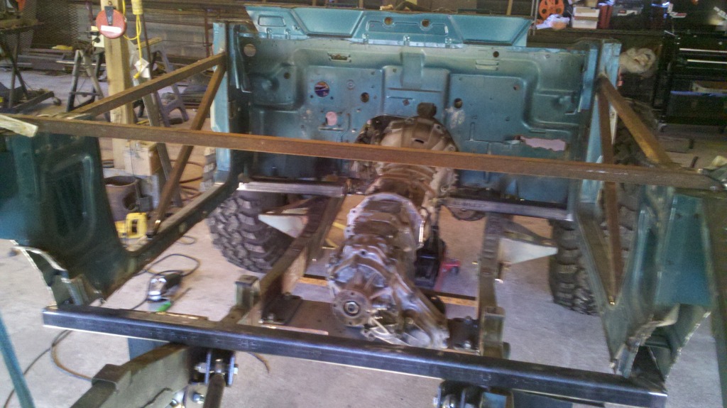

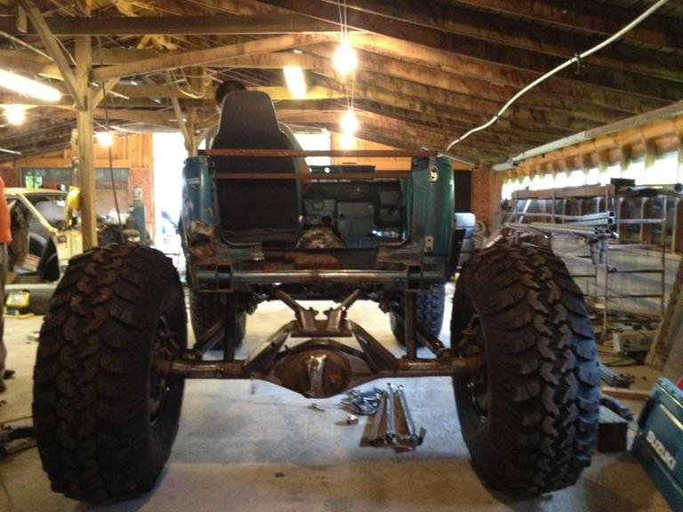

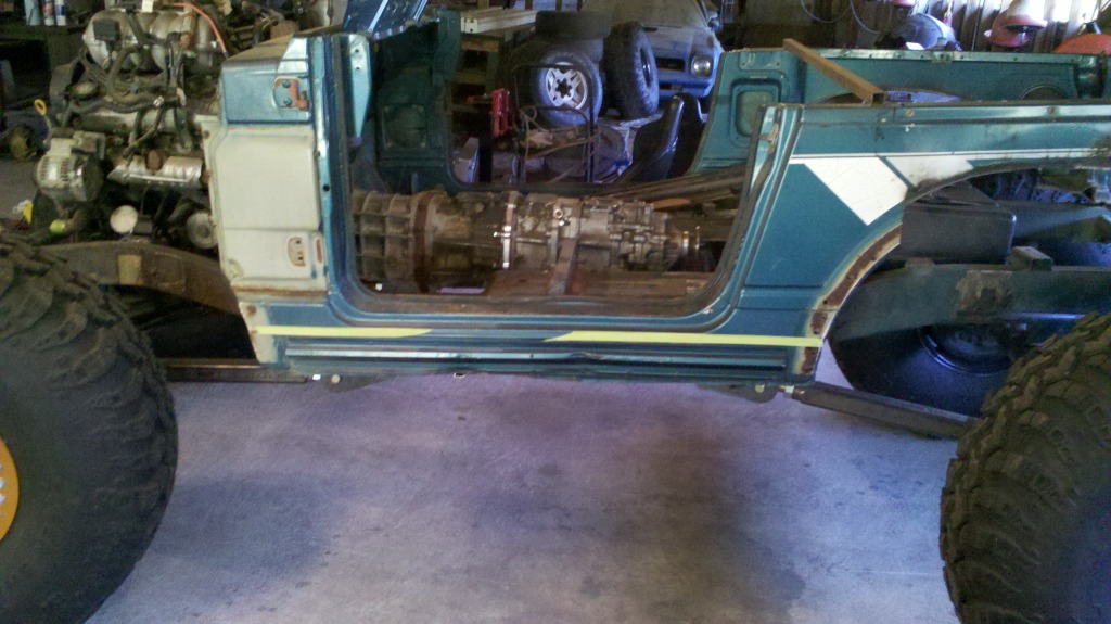

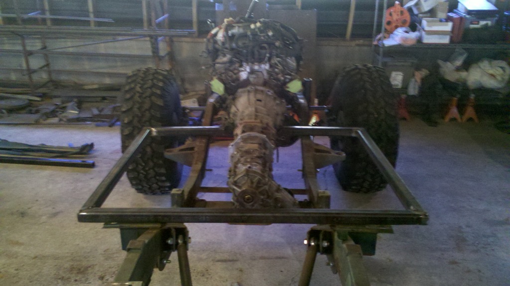

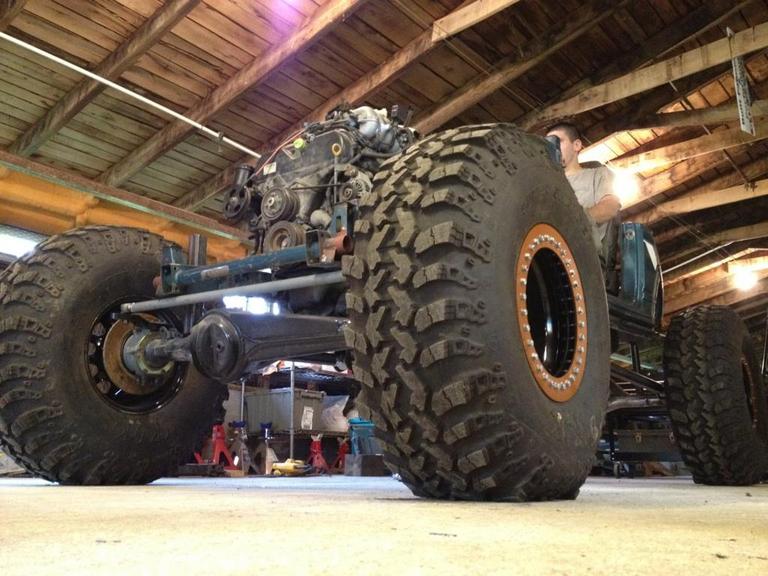

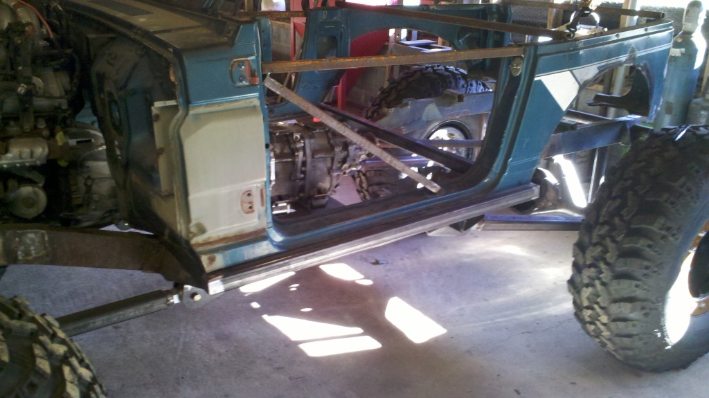

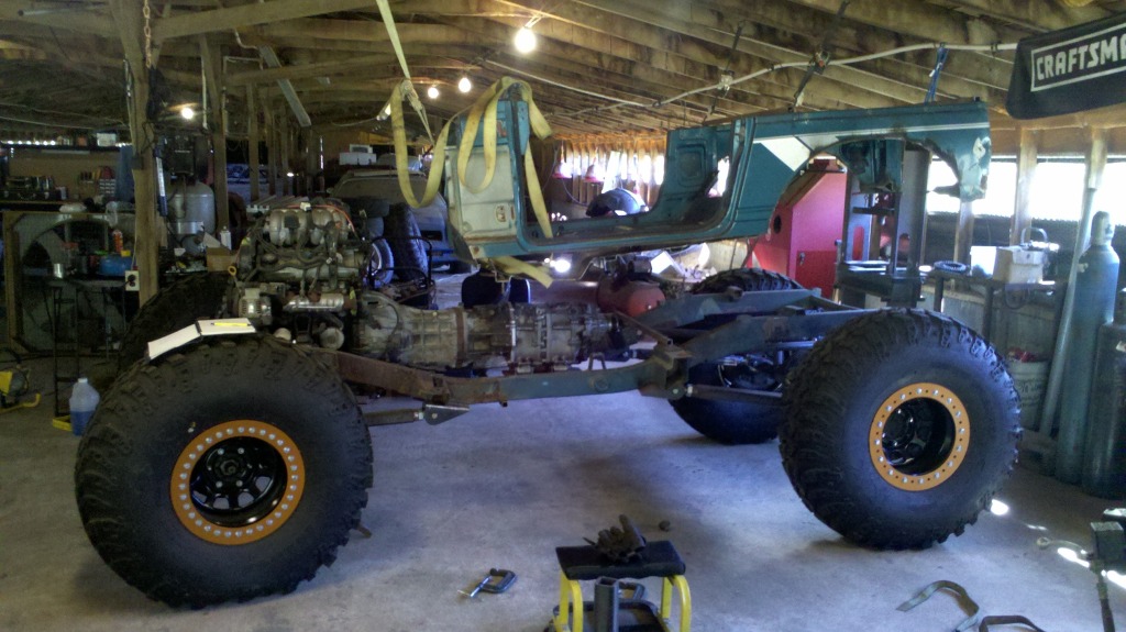

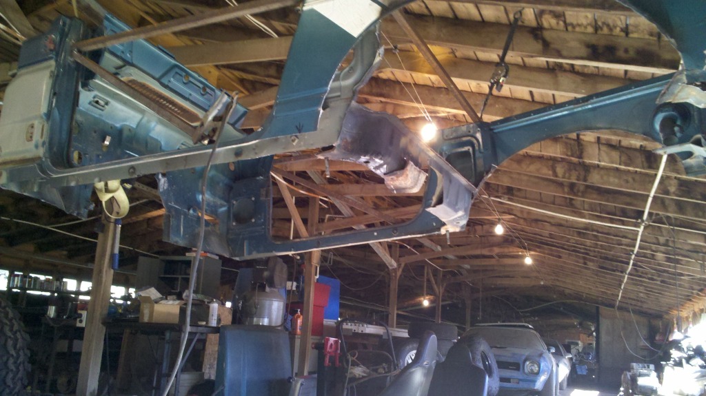

Got a little more done this week thanks to John (untchble) for the help on saturday. Got the lower front links and mounts done and halfway welded on and I lowered the trans mount to get a better rear driveline angle. Then with some help we got the other 2 tires mounted up and put the body onto the frame for the last time and started the dovetail to get enough clearance for the rear tires. Here's plenty of pics for your viewing pleasure.:lol:

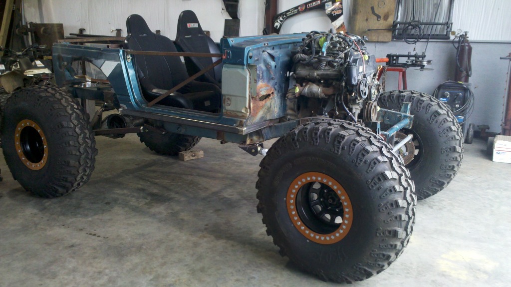

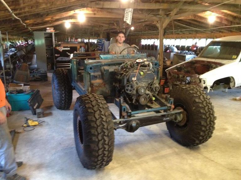

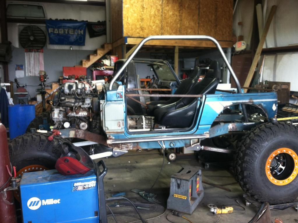

Got some updated pictures I took the samurai to Chris at Marsfab to get the cage and some other work done this is what it looks like so far.
This is when I dropped it off
ai878.photobucket.com_albums_ab350_StuntmanAutoworks_My_20Samurai_2012_12_05_14_12_56_837.jpg

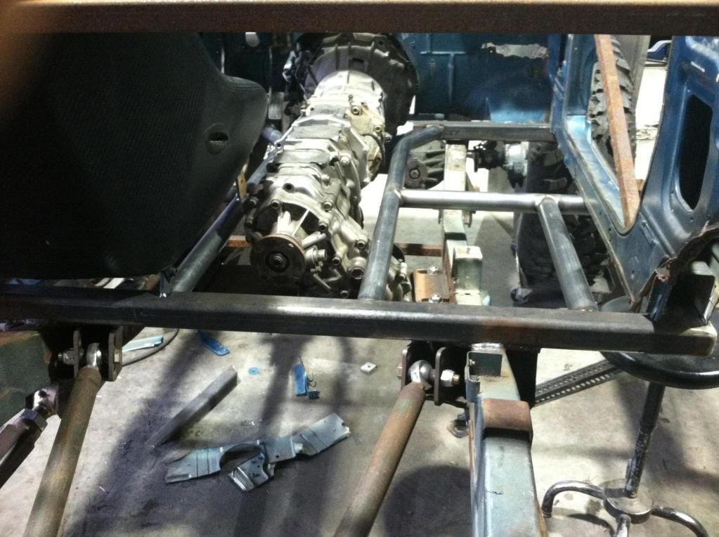

Here hes got the frame for the seat mounts done

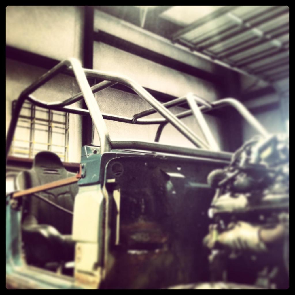

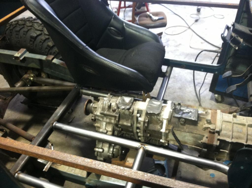

Heres the start of the cage
That cage is awsome. I dont think I have ever seen anything quite like it before. That is going to be a bad ass sami.
