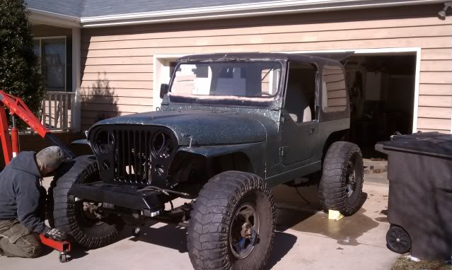

Holidays are over and I have been tinkering with it a little bit. Csudman and I worked on the reaxle perches the past couple of nights. Got that pretty much done. Just need to figure out the angle and finish welding them in. Not much to really show but here are a few pictures. The rear perches are using a handful of different things to make the bottome of the axle as smooth as possible for a spring under set up.

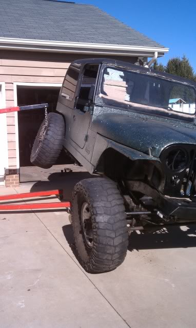

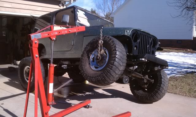

Got some more progress done today. Put in the new front springs. Stock waggys and bolted it all together. Flexed it out and checked for front drive shaft clearances between the drive shaft and the transmission. It is tight but everything clears. Will end up putting in a driveshaft hoop in the event of a u-joint letting go it would get into the trans then.
Also notched the frame a little on both sides of the front for a little more up travel. Nothing to extreme but this should help it out.
Ended up with a wheel base of 100 inches.
Some more bad cell phone pictures:
The front and the back will have to be bump stopped with almost the same amount of up travel. The tires both front and back came off the ground 2 feet before they would have to be bumped. Down travel however seems to be really good.
So far I am really happy with the springs set up as they are.
