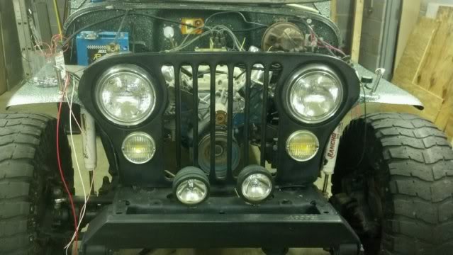

Well the jeep got loaded up one more time to another garage. This time it is a little closer and indoors. Seems to be working out pretty well. The wriring to the back of the jeep is done. The head lights are also done. I need to pick up a coil and a a few other things and then I can start on the motor and what not. Slow going but with the helpers of csudman and my dog roxie, it is moving along. Also another friend is helpign with the wiring. I am learning a ton, but still making mistakes. THese are just a few pics of the things happening and the help. Hoping to get more done in the next month. I have knee surgery the first week of april so that will slow things down greatly.

Don't forget a circuit for the Depth Finder! And where are the rod holders??
Can't wait to here that thing fire...good work men
