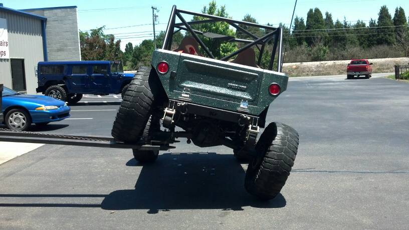

Got the trans back. Installed last night and drove it.
This morning drove it out for a little flexing.

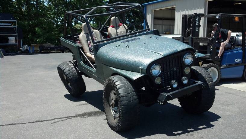

I am over the brakes on this stupid thing. I am going to replace the calipers again. I replaced the master and bench bled it. It got super firm. Installed the new master. Once I figured out the spacer for the pedal I started bleeding. I put a soft line in and by passed the cutting brake. With the vacuum booster hooked up the pedal has not feel. Just falls to the floor.
I am going to load it on the trailer and take it back to the trans shop as it has a leak and they are going to take care of it. I have installed the rear drive shaft and moved it around. Still only in low range. It doesn't take long for it to get hot. That is with the fan on. I am probably going to have to build a shroud for it.
It is so close.... If I could get brakes I would have it inspected and take it out to do sme testing.
