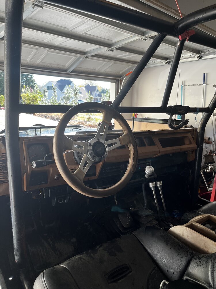

While waiting for the correct input for the Atlas, I started by ripping out the dash pad and lowering the tube for better visibility.

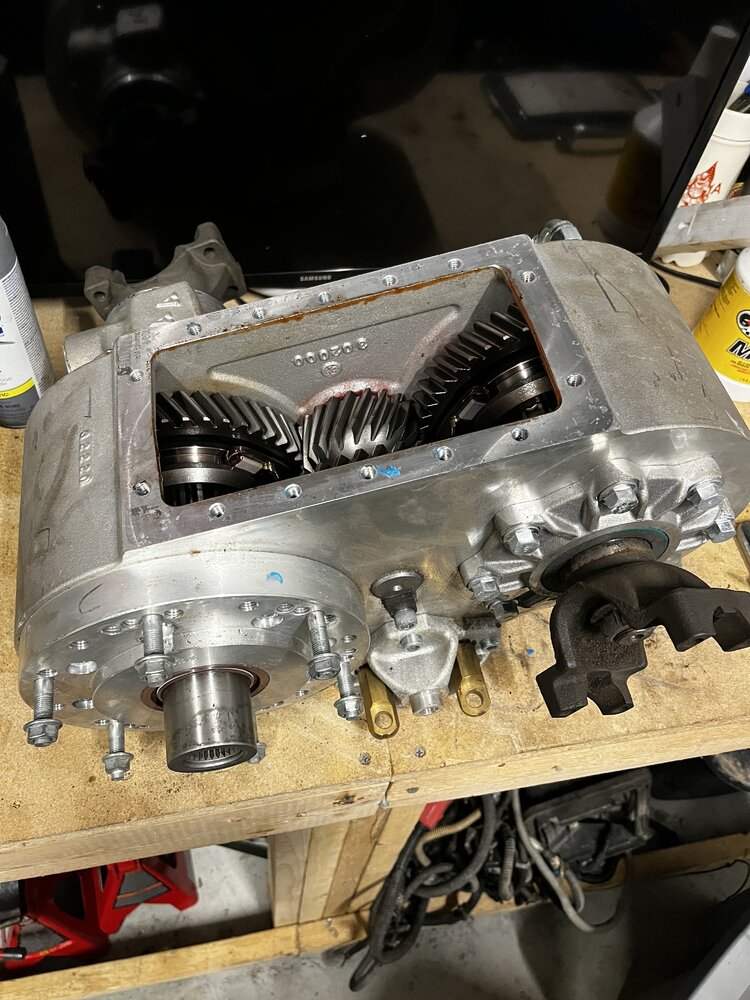

Once the parts came in for the transfer case, I pulled the D300 that had left the chat and got to work.

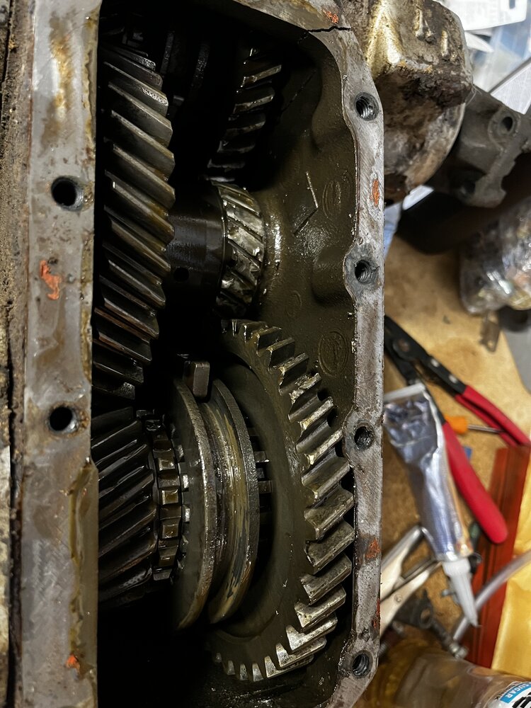

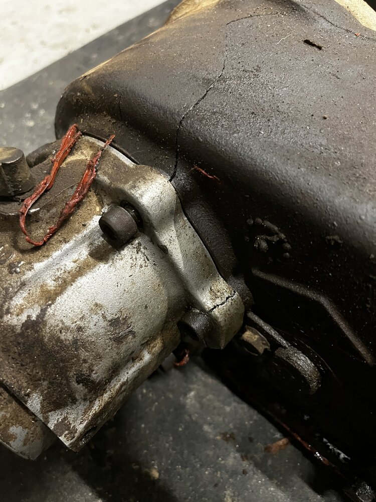

In typical D300 fashion it looks like the gears pushed apart under load, split the case and got a case of summer teeth.

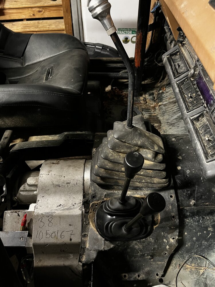

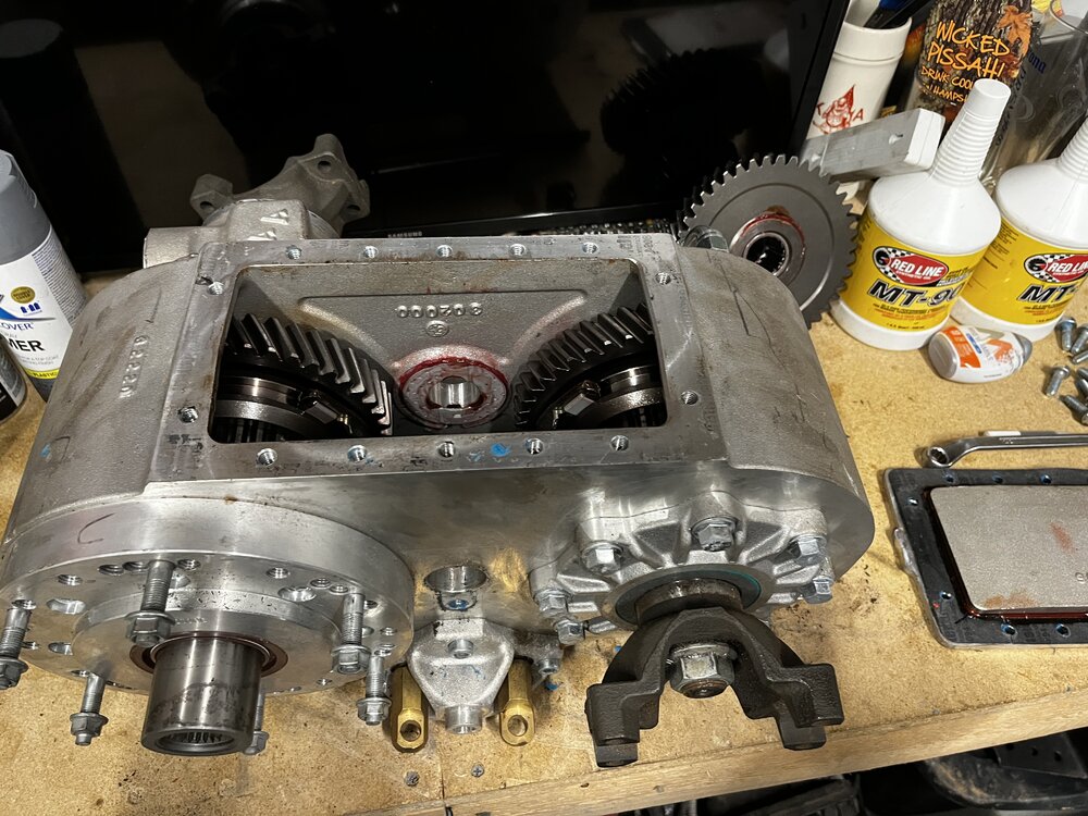

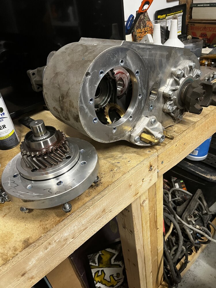

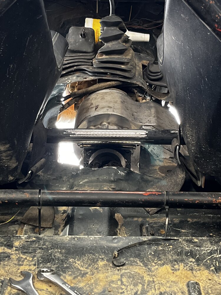

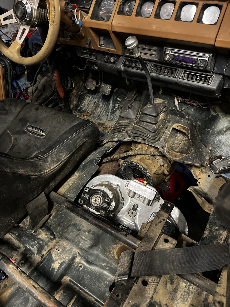

Swapped inputs, cut some more of the floor, weaseled the Atlas into place which was interesting given the location of all of the rear suspension mounts.
I used the TMR ring I had laying around to mount the case. This was a giant fail in the long run. It works great in a super stiff tube chassis but a caged frame rig is less than ideal. It would slowly walk off the back of the case and eventually stretched the bolts to the point where they were seized in the mount. I attribute it to chassis flex. I could drive it around all day without issue. A few good rock trails and it wouldn’t begin moving.
This eventually got changed to a stock style mount and has been fine since.

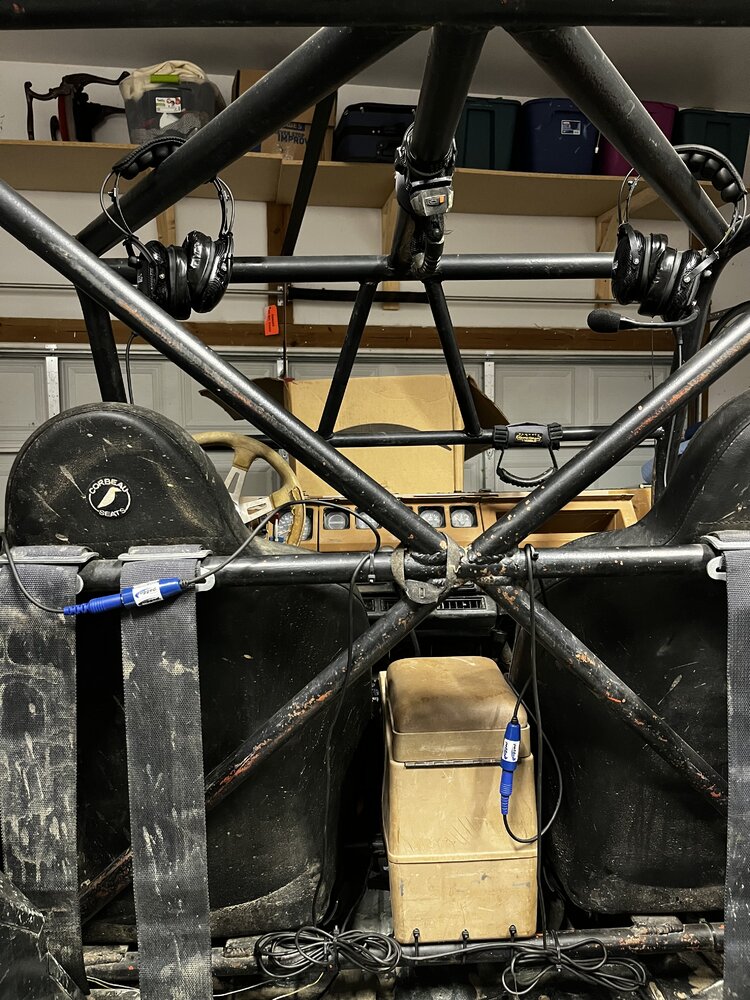

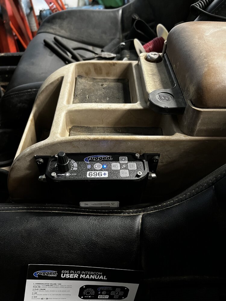

To make all day trail rides more comfortable I threw in a Rugged Radios headset and intercom. Dumb redneck tested, wife approved.

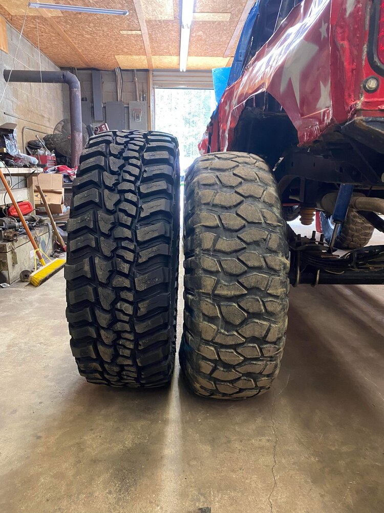

Brings us to now. I started to get pictures like this.

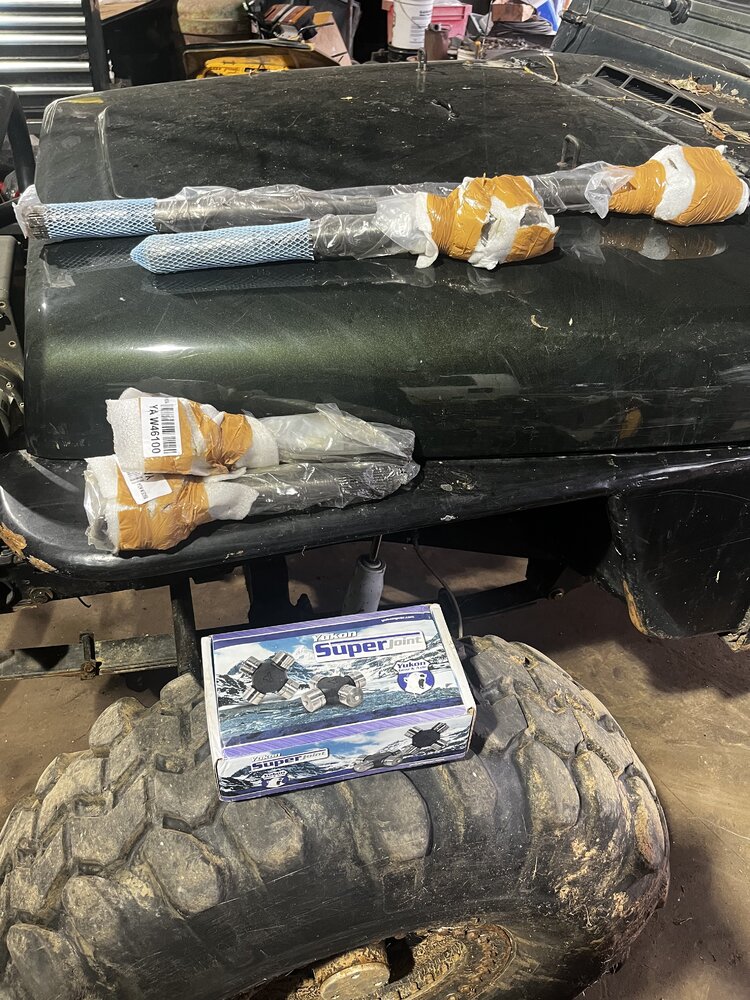

So I ordered some as well as a set of these:
Finally got some shop time and got the shafts and superjoints installed today as well as repacking the wheel bearings. The tires should be here this week.
Sometime this winter the plan is to rip out the poop pipe cage and make a new cage, dash, console etc. Other than that, just wheel and fix as needed.

Did you finally cave & get cheater tires!? Damn peer pressure 🙄 You're one of the only ones that can actually drive, the rest of us just give it hell & hope for the best 🤣
I did cave. And you give me too much credit, it’s usually the vitamins that keep me more mellow. The drive by Braille power shifts still happen.
Does that mean we should have our wages garnished by Goodyear for milking every bit of tread out of those slickie MTR’s?
Shoot probably. If they’d make those tires again I’d buy a set tho…
