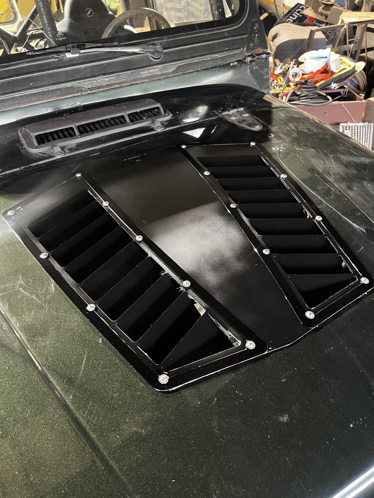

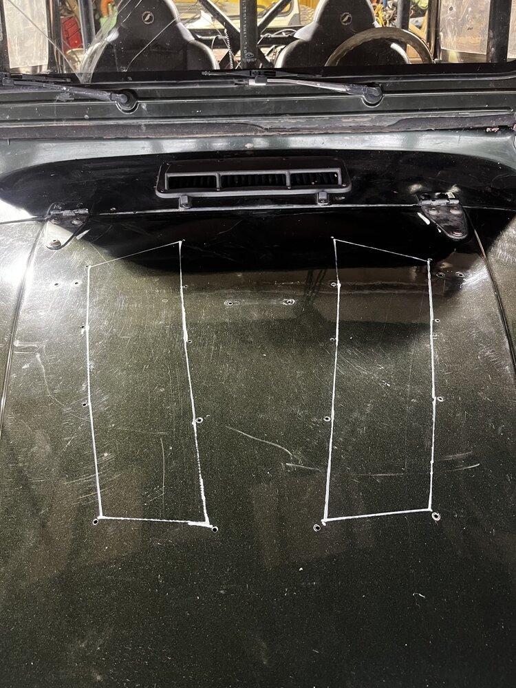

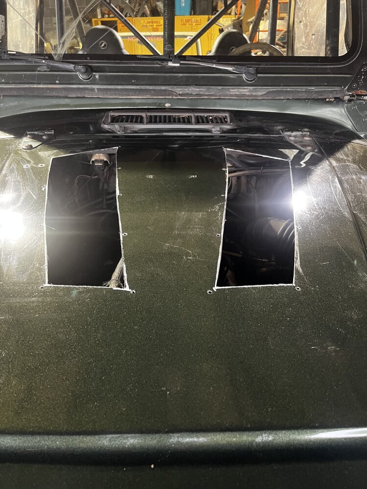

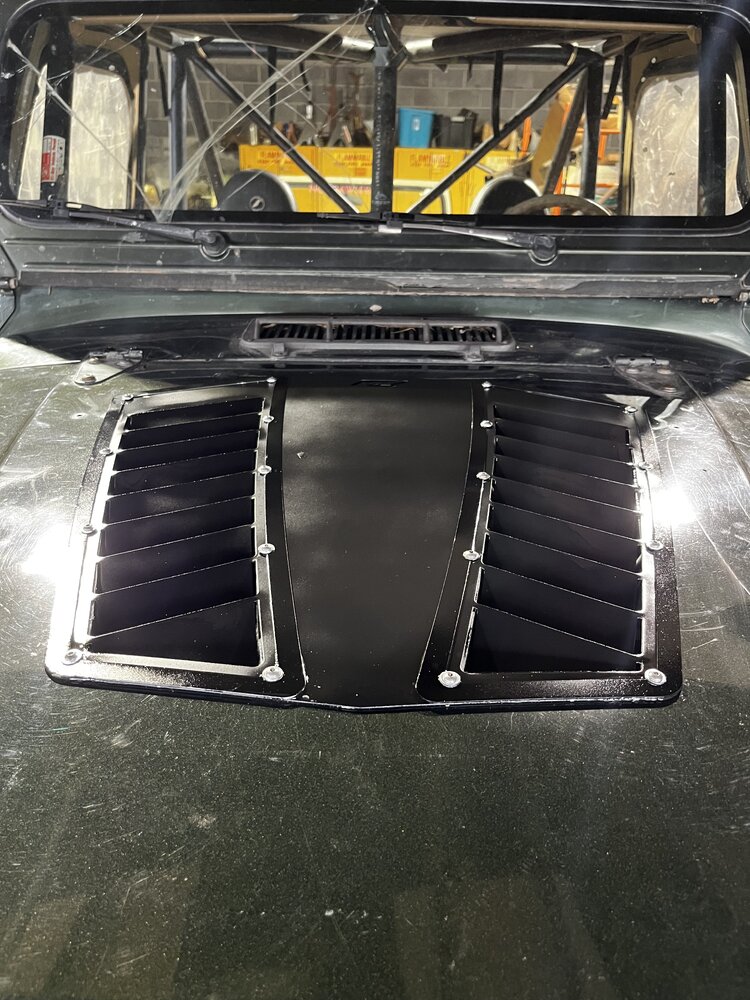

Let’s see if this help air flow under the hood. If anything it looks mildly cool and adds 10HP because it came with two stickers.

Got ya, I rarely overheat but I’m not running fenders at all. Was thinking about doing the vents too to help with the heat. Mine sits outside most of the time so idk that I wanna do it.
Yeah this hasn’t been an overheating issue. Mechanical fan and oem shroud works great. Just have had issues with vapor lock due to all the heat trapped in the engine bay.

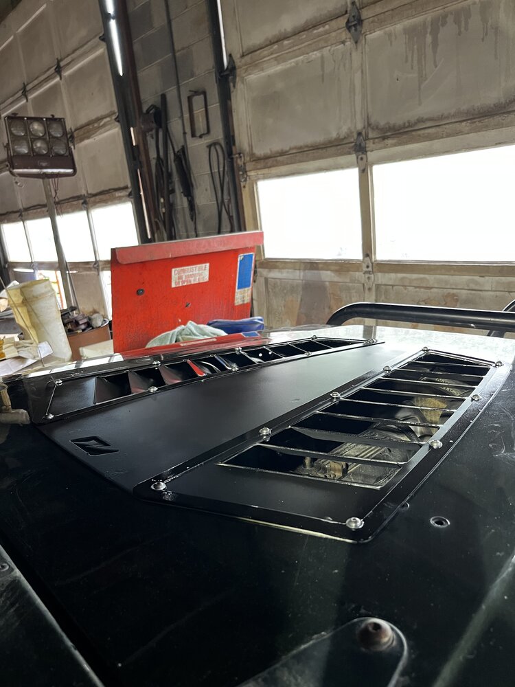

I did mount these further back than the instructions specify so that the louvers were right over the engine and I left the drip trays out since it stays in the shop. But the motobilt kit does have them to keep water off the engine if it sits outside a lot.
Yea, I’ve seen your heat soak problems. Surely it will fix that. Had the same happen with a wj before. Simply popping the hood and leaving it on the safety latch while wheeling would solve it. The v8 in mine stays pretty good. Just a few times it got hot. But probably need a cooler thermostat to start with

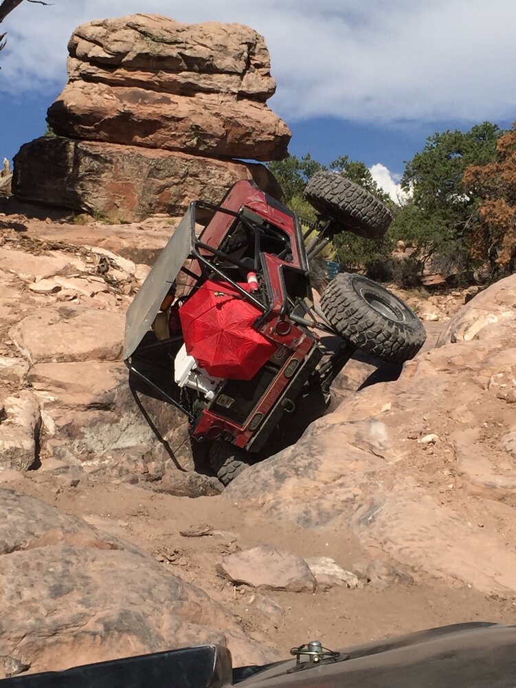

Correct. I ended up soaking the fuel cell in ice bags and cold hotel towels with an umbrella and carried on Mary Poppins style until I got home. Once I got back, MarsFab built an awesome aluminum enclosure lined with insulation to keep it from baking in the sun (there was an air gap between them also). Fixed my issue entirely and I ran and E2000 under the tub. No inner fenders. Fuel rail wasn't wrapped and no hood vent for what its worth.

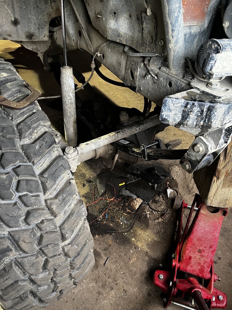

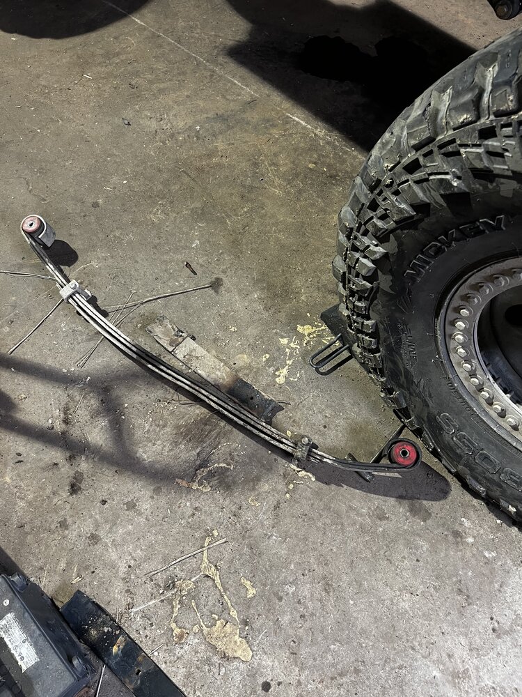

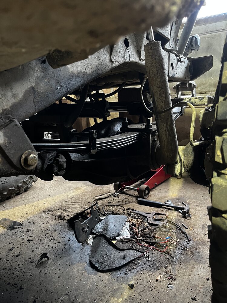

Recycling parts off the CYJ build since they’re still laying around. The front leafs on this thing were bent and pretty clapped out. Some RE1444’s with the bottom leaf removed worked great to fix that issue and not raise the front much as it sits maybe 3/4-1” higher now so it’s pretty level with the back.
