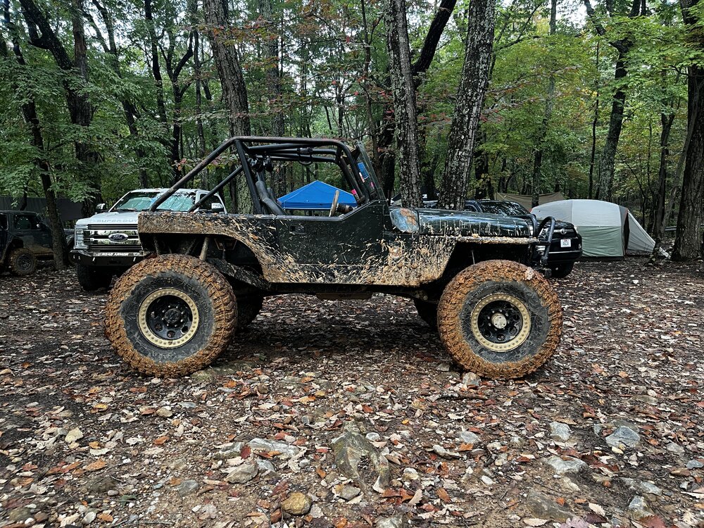

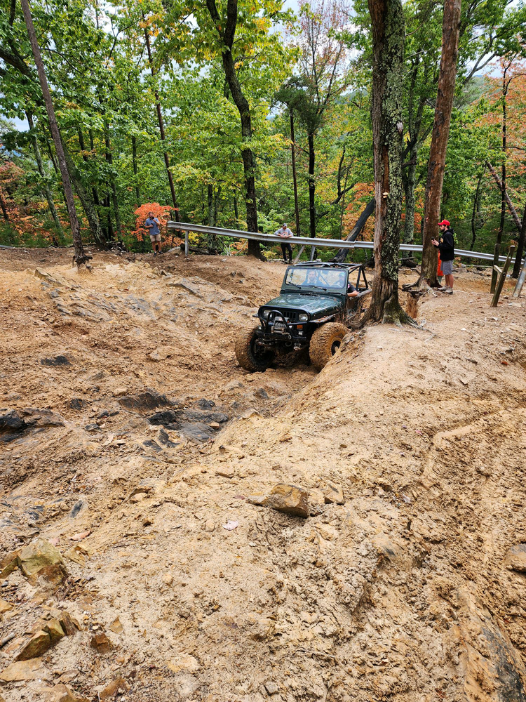

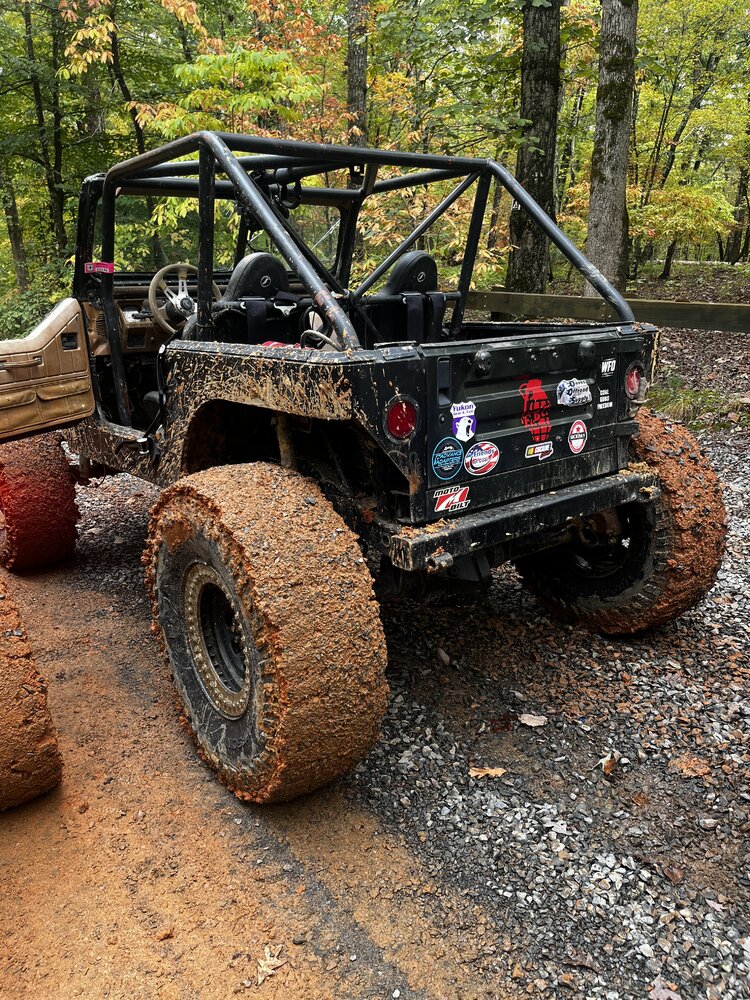

Got down to Uwharrie a couple of weeks ago for an annual camping trip with some friends. New tires did great given the typical Uwharrie mud.

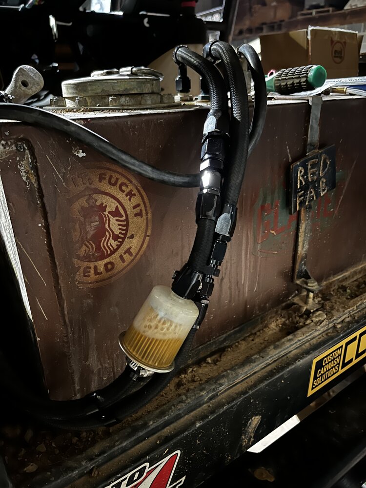

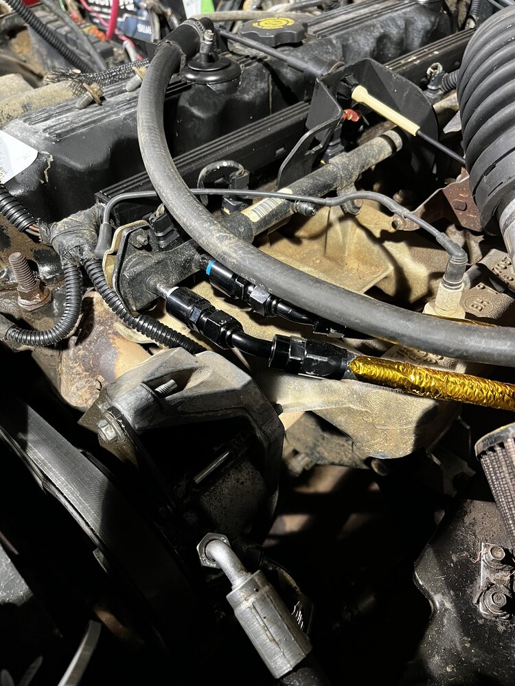

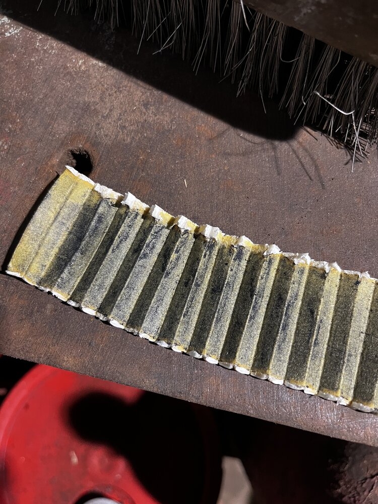

Of course during a night run and on Daniel it started getting slow to start and cutting out around 3500rpm. Having been through this before with it I knew the pre filter was clogging. Limped it back to camp, brought it home and started ordering fuel lines and fittings to replace everything from the cell to the rail.
Pre filter was clogged with black oily rubber media. Guts of the OEM fuel lines like I suspected. Only about 8 hours of run time on this filter.

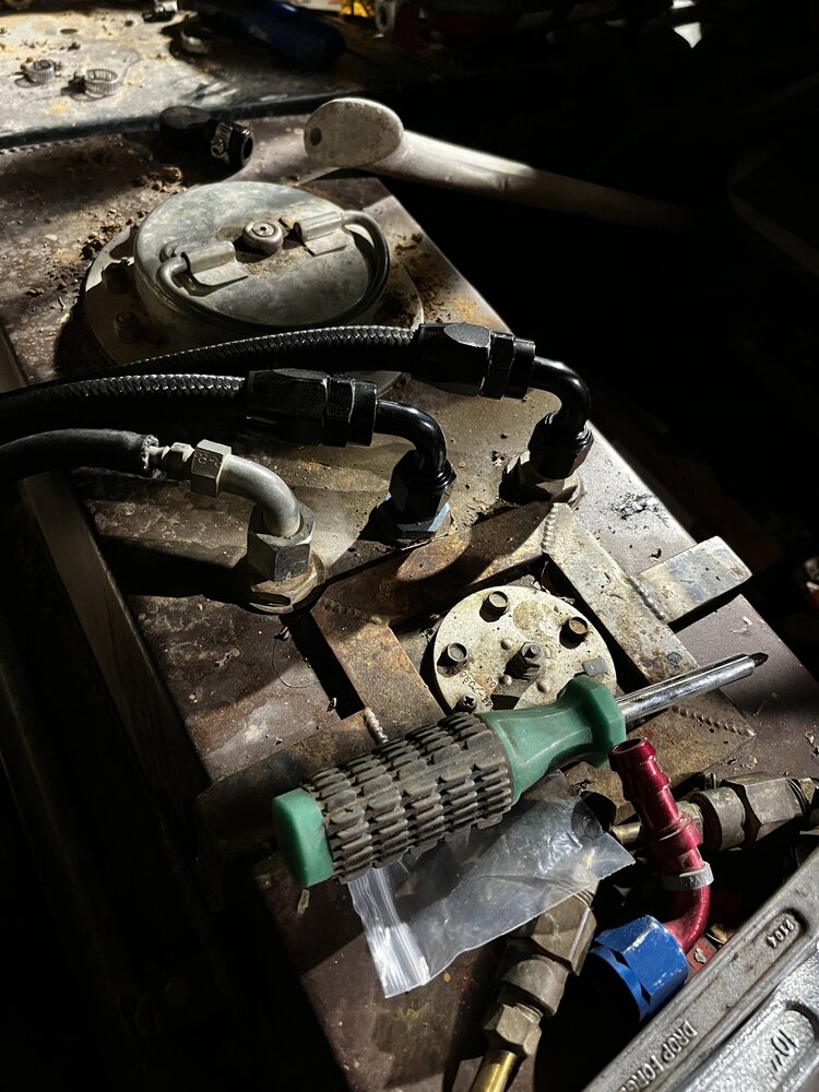

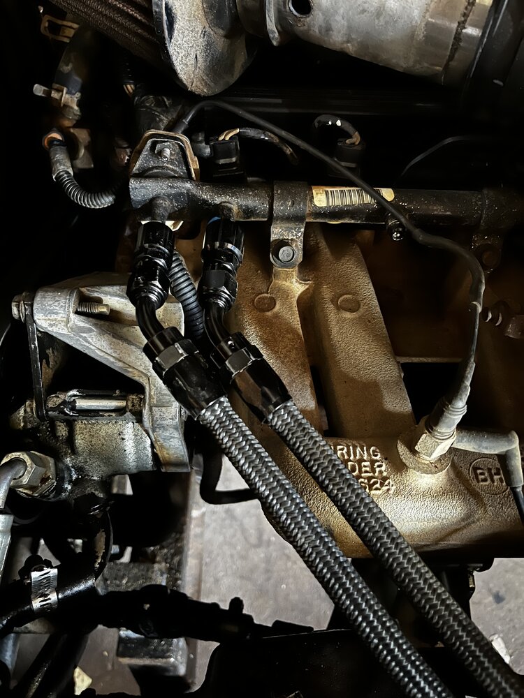

Ripped out all the lines last night and got to work making new lines with -6an line and Russell fittings. Need some -10 to tie into the cell and a couple small fittings to button things back up. The lines in the engine bay will get wrapped to lessen the chance of heat soak.
View attachment 406016View attachment 406017View attachment 406018
Seems this corn fuel is hurting all kinds of fuel lines. Even ones “safe” for it

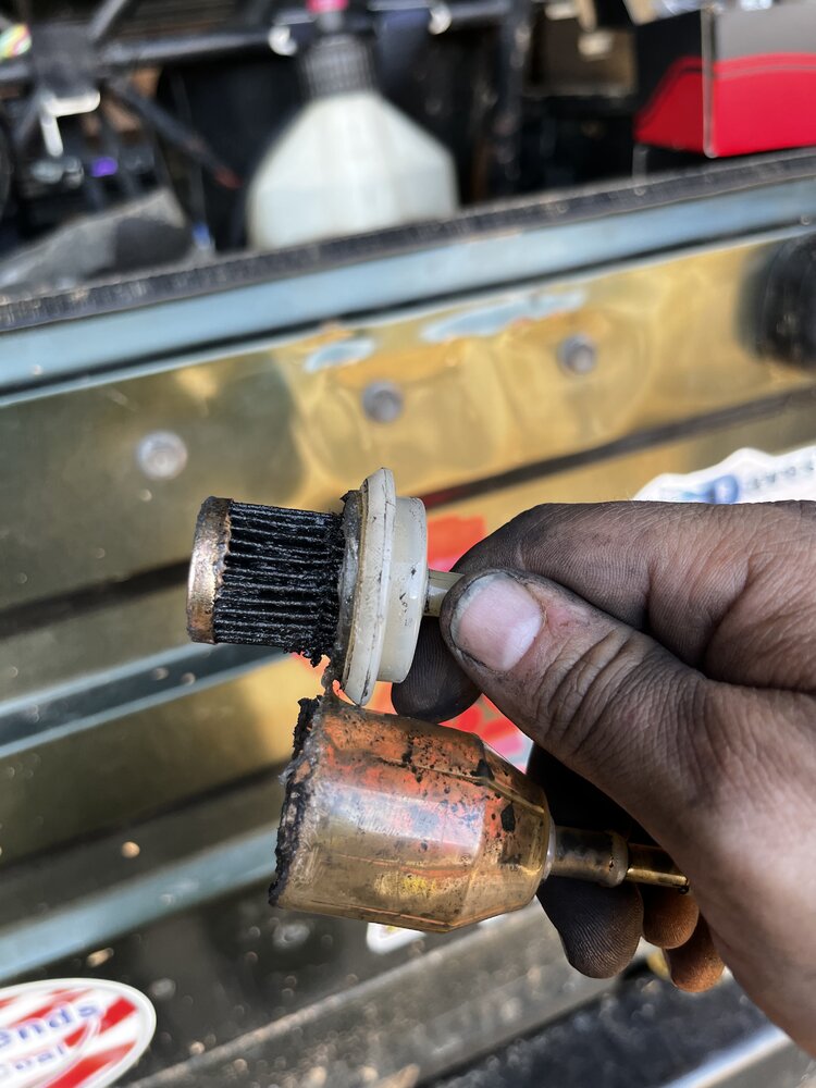

Shooting to make a day trip to the ranch for New Years, I decided I better give this thing a once over. Went to fire it up today, crank, no start. No fuel pressure. Dead E2000. Curiosity got me and I cut open the pre filter. I forgot my intention was to drain and clean the fuel cell after replacing the lines. This was after maybe 3 hours of run time cruising around the farm.
Popped the return line off the cell, pinched the breather shut, ran the feed line into a 5g bucket and stuffed the air gun into the return fitting. Very fast way to pump out old dirty fuel.
A few rounds of this and turning blue shop towels black wiping the inside of the cell out and it was probably 95% clean. At least way better than before. Swapped in my spare pump and done.

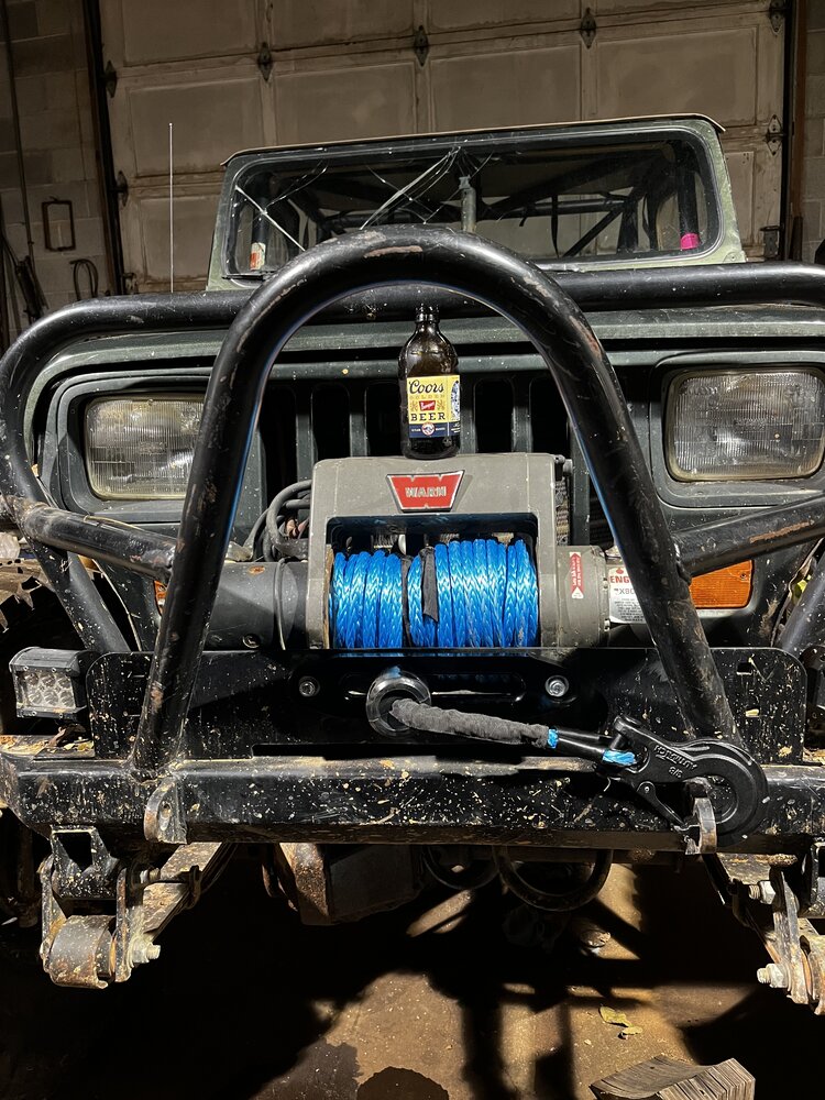

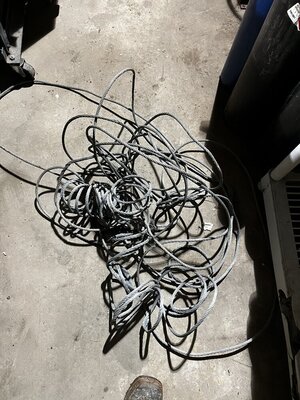

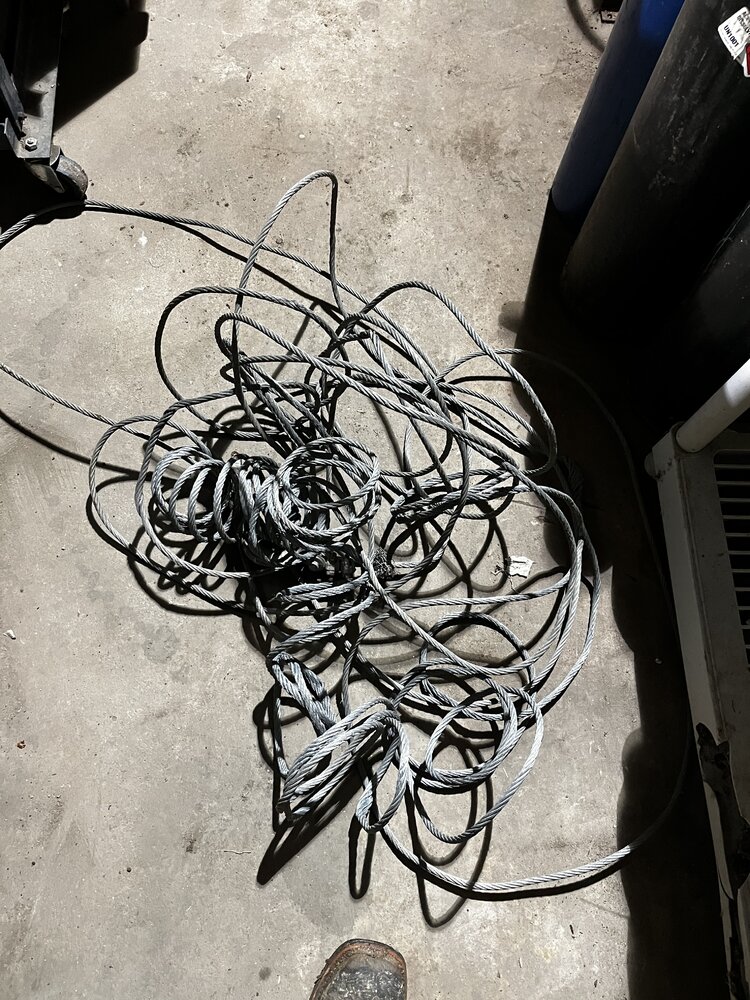

Fluid check, cleaned up the spare parts and tools in the action packer and put the cab back in winter mode aka a bikini top and soft upper doors. I’ve been meaning to get rid of the steel cable winch line so some synthetic will be here Friday.

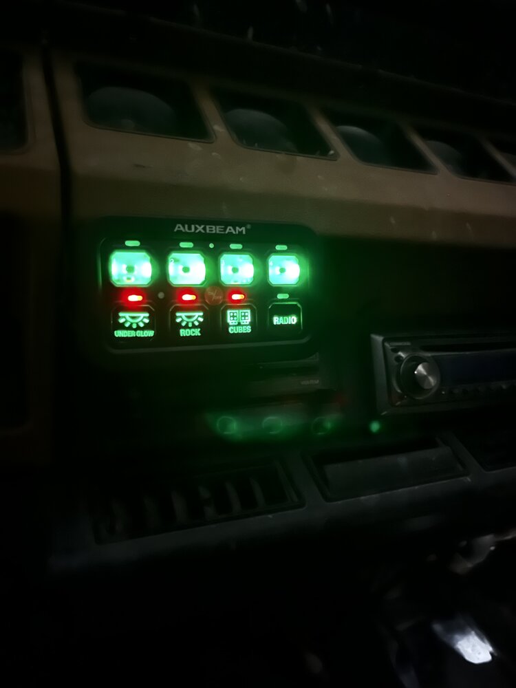

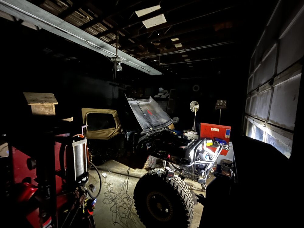

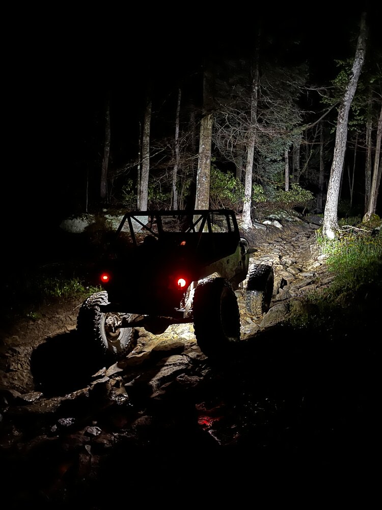

It wouldn’t be the week before a trip without tackling some project. All of the auxiliary lights on this thing were controlled by random toggle switches and I could never remember which one was which. I was like a cholo at a parking lot party flipping switches any time we went for a night ride. Finally got around to cleaning that up with a whole mess of China parts and threw in some LED headlights while I was at it. All controlled off an Auxbeam controller like I threw in the TJ. They seem to work well for what they are.

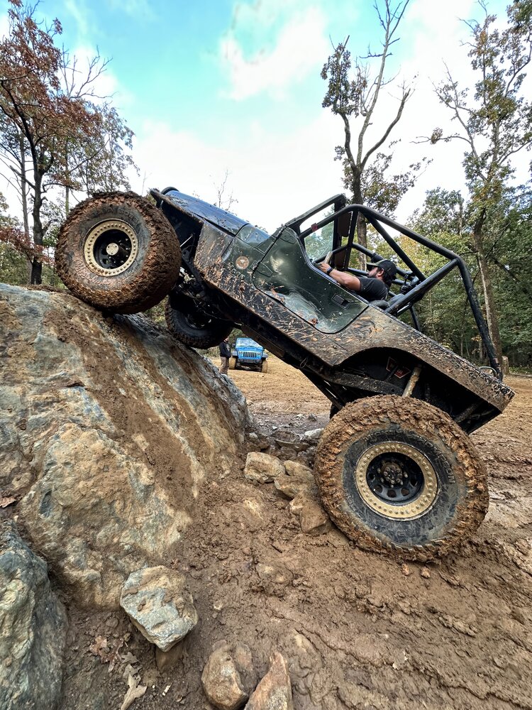

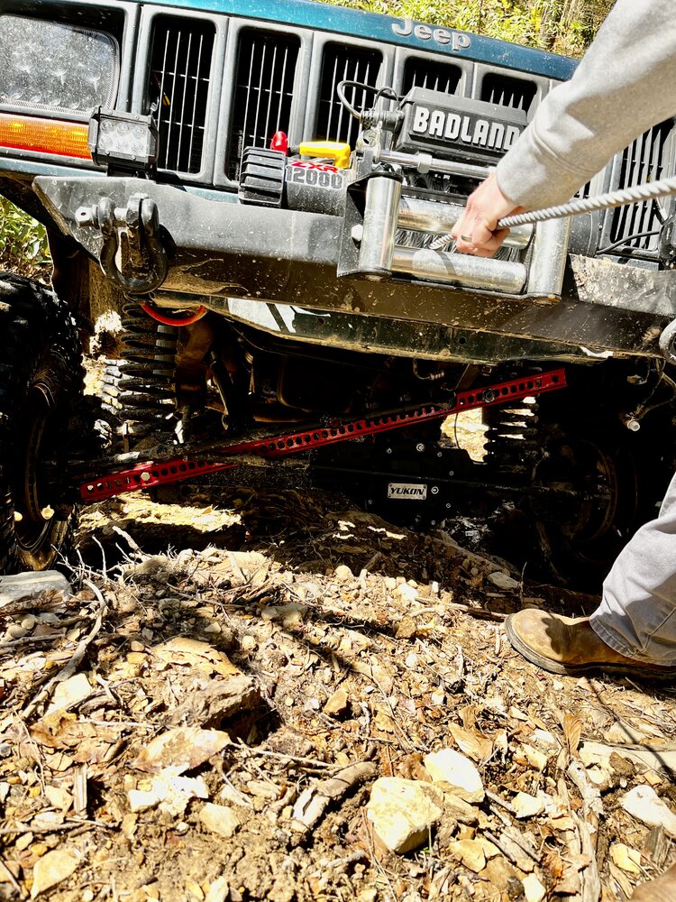

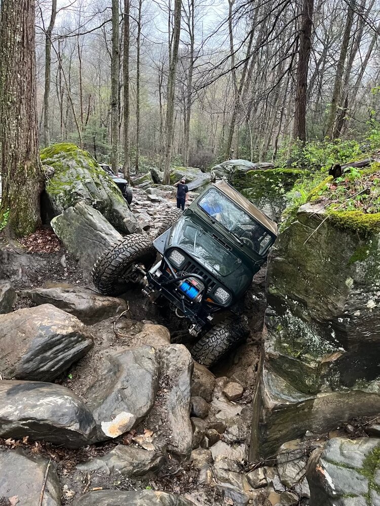

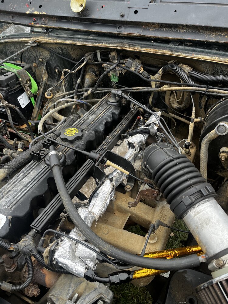

Solid weekend at the Ranch. YJ had some issues Friday afternoon with Vapor lock and the rail being super hot. Corrected it Saturday morning after a run to the parts store and ran all day Saturday without issue. Stickies are breaking in well. The poop Toyota did poop Toyota things and went up everything it was pointed at and only burped a tire in Wolverine. The XJ on the old rental stickies went like a mofo too. He burped a tire on Chadalack Friday night and deleted the trac bar Saturday on Cripple Creek. Relatively easy recovery after a trip back to the truck for tools and a high lift.
