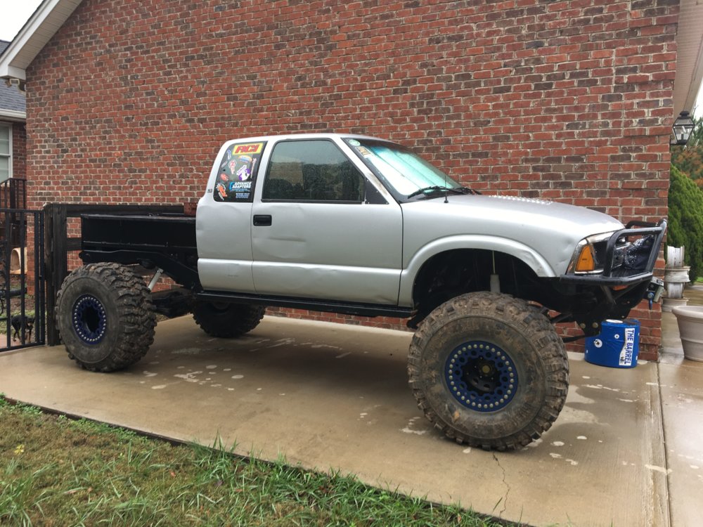

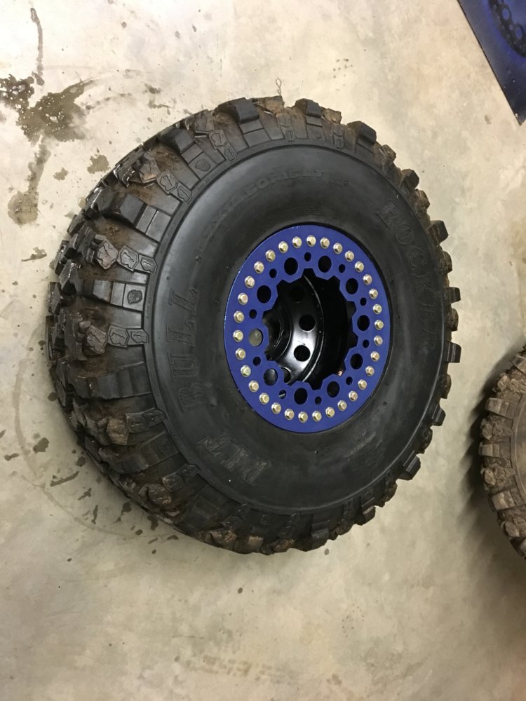

Finally got my chance to upgrade to some larger tires. Picked these up from a guy on here. 37X12.50R15 Pitbull Rockers. Kids were more than willing to help the old man out.

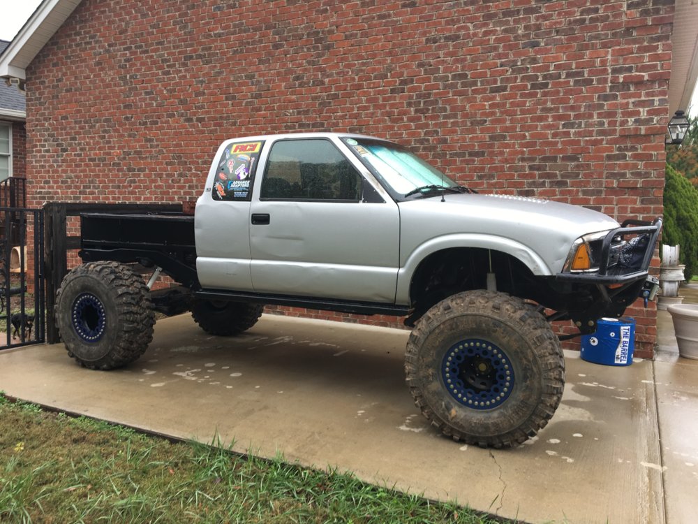

I opted to ditch those stupid aluminum "bolt protectors" I had on the wheels originally. They did their job and no bolts were damaged, however, it took me almost 4 hours cussing with a screwdriver to get the bolts inside the aluminum out. At $30 per wheel to replace, I'll pass. Fresh coat of paint and some plain old stainless washers for that subtle BLING.

Looks meaner I think and the kids approve. Next week I'll get it inside and trim the rear corners of the front fenders to make them fit. I'm still waiting on my one new tire I bought to make a full set. One of this set had a repaired sidewall that will make a nice spare.
Those give it a good stance. They got my approval [emoji106]
I like it! ( Also, it's subtle :D )

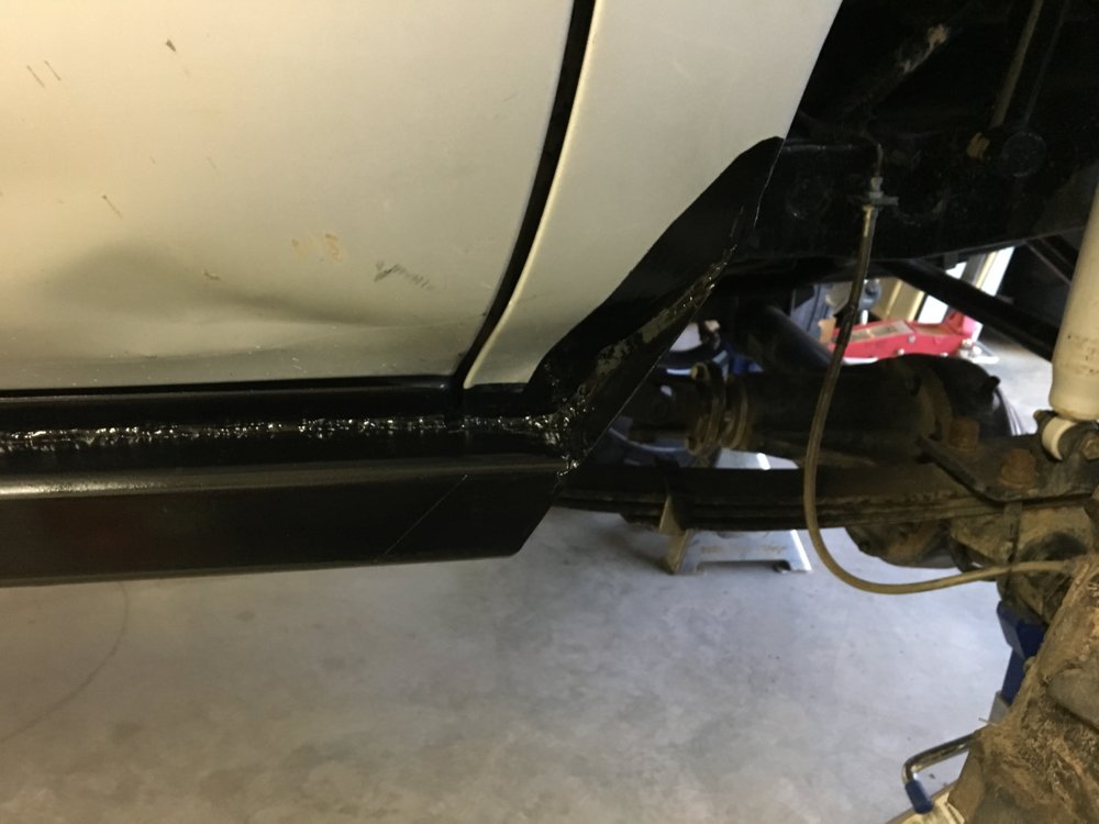

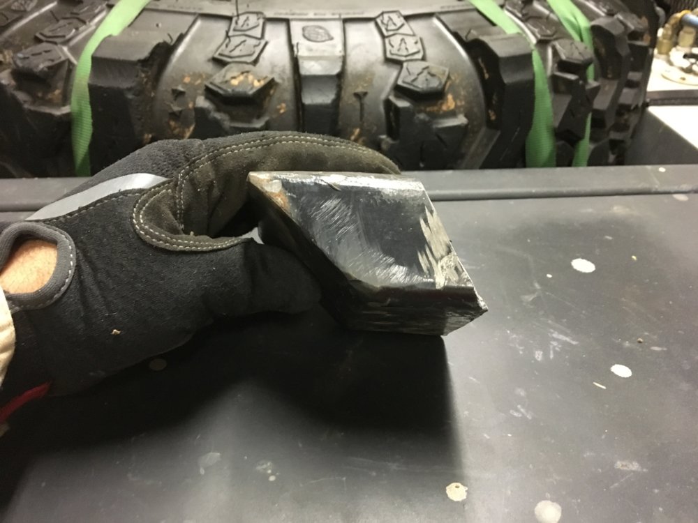

Took this much off the rock rails. You can see where the 35’s were rubbing just on that top edge so I figured a different angle was in order.

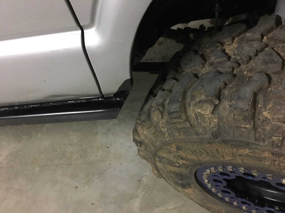

Slight trim to the rear of the fender. Added a skin of 16 gauge to cover all the metal edges and give the tire something smooth to rub on.
Just shy of 3” clearance with the tires at the lock sitting at ride height.

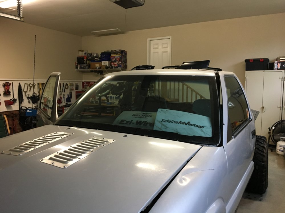

Safelite put a brand new windshield in this morning in preps for that exocage. Stay tuned...
