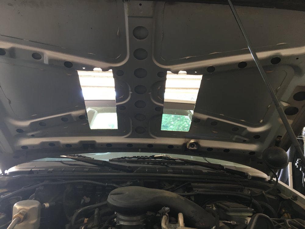

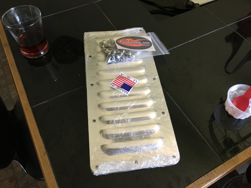

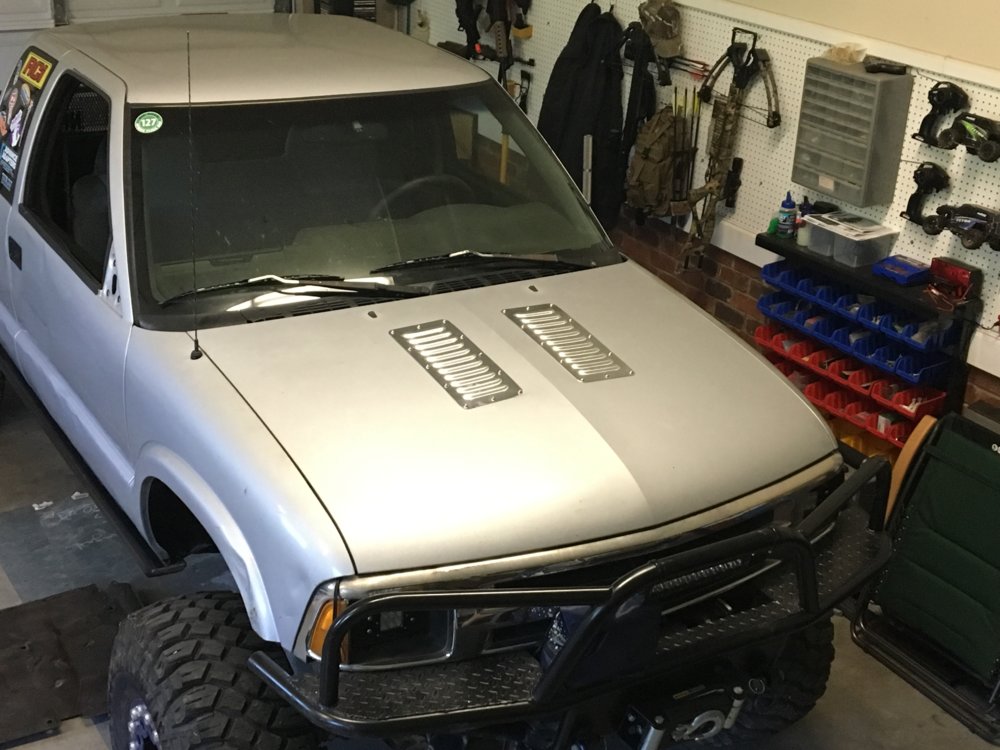

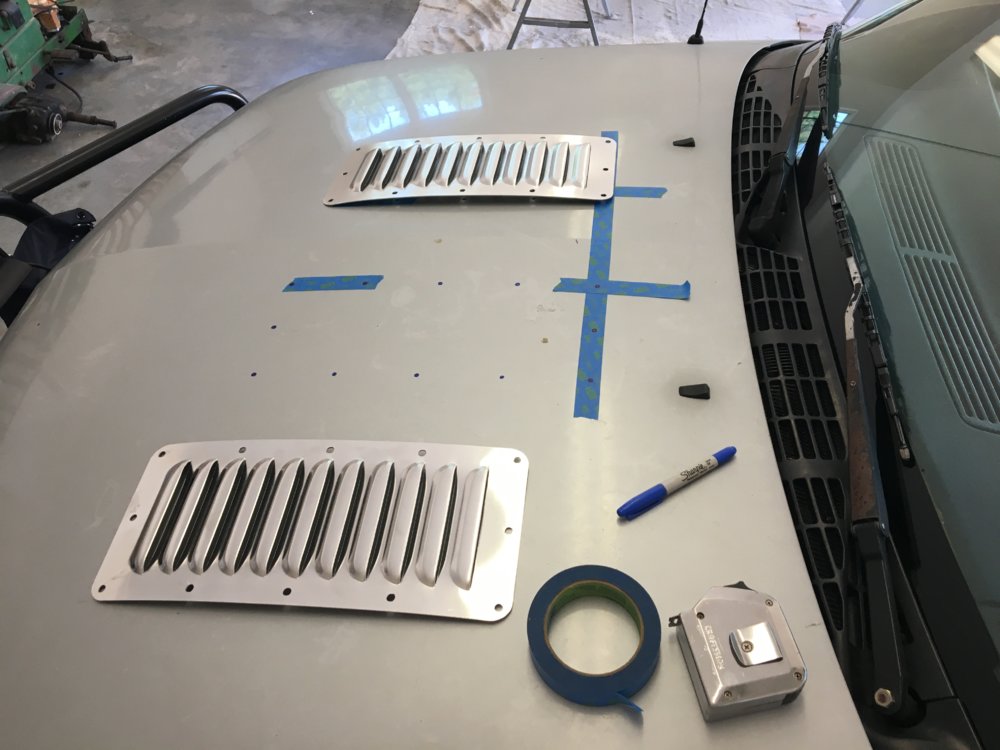

Noticed a few Jeeps on my last trip had these louvers on the center section of the hood. Bound to make a significant difference in under hood heat. I bought these from a place called RodLouvers out in CA. Came with the aluminum louvers and all the stainless hardware.
I ain't no professional fabricator, but I think they'll do the trick.

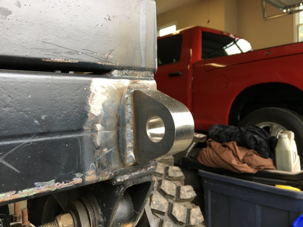

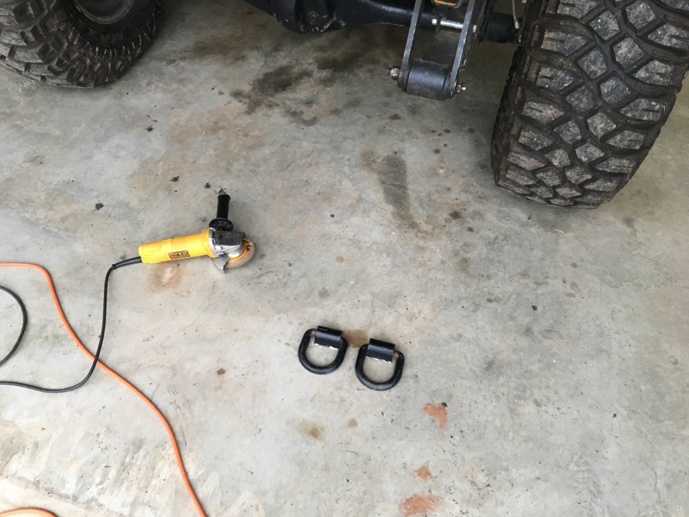

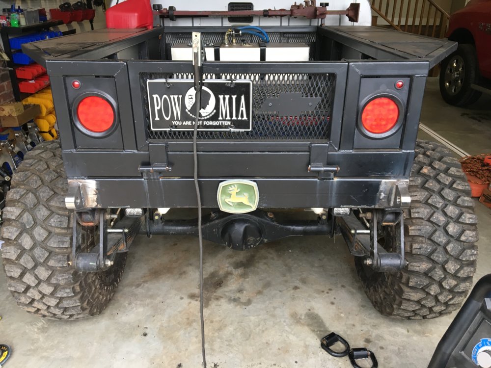

Bought a pair of these HD 1" clevis mounts from @Barnes 4wd
I'm feeling pretty good about my welds, but if somebody on here smarter than me thinks it's unsafe, I'd like to hear it.
I would have just put a heatshrink on the rings to quite it down, but the new mounts look good.
I appreciate the vote of confidence. I'm still lacking 100% confidence in my welding ability. Just proudly saying "it ain't broke yet" and knocking on wood.

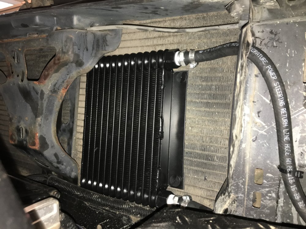

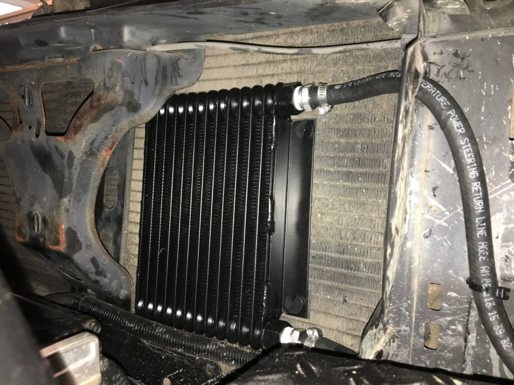

@Loganwayne I didn't have room for that cooler you recommended. There's a brace that runs vertically halfway across my radiator. Forced me into a smaller square version. Derale, $40 from Summit.
View attachment 253691 @Loganwayne I didn't have room for that cooler you recommended. There's a brace that runs vertically halfway across my radiator. Forced me into a smaller square version. Derale, $40 from Summit.
Just make sure there is a decent air gap between them. Otherwise they will heat each other up.
That cooler is mounted to the A/C condenser and the A/C doesn't currently work. There's an inch gap between it and the radiator. Should be fine until I decide to get all fancy and repair the A/C.
Is that for the power steering? I need to add a power steering cooler to my 2500HD. The hydroboost gets hotter than hell just during normal operation and when I tow something heavy for any decent distance, I can feel the heat on my legs and feet coming in through the hyrdoboost. The pushrod and brake pedal will get hot too! It's a little ridiculous, I think, that my 1500 Silverado with a vacuum booster has a power steering cooler, but the 2500 with hydroboost doesn't have a cooler.
It's actually a trans cooler, but I'm using mine with the power steering.
