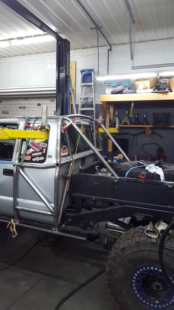

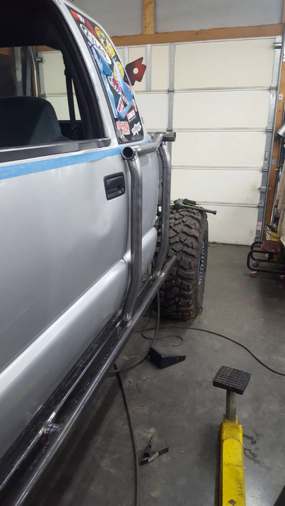

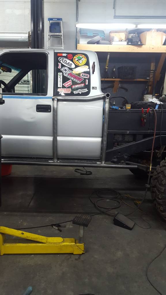

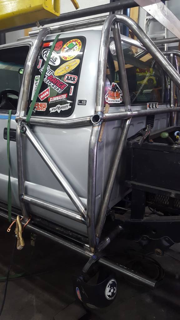

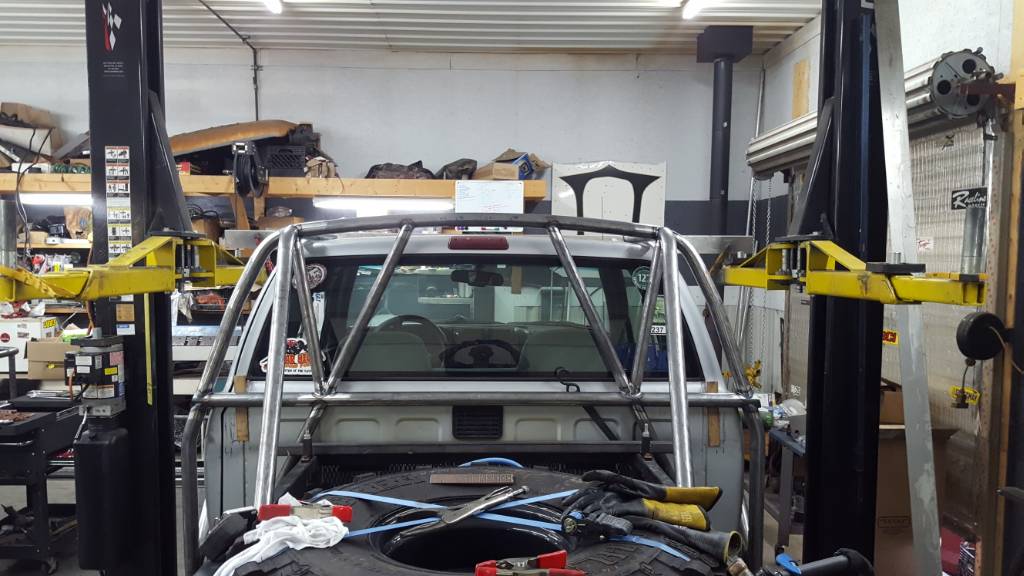

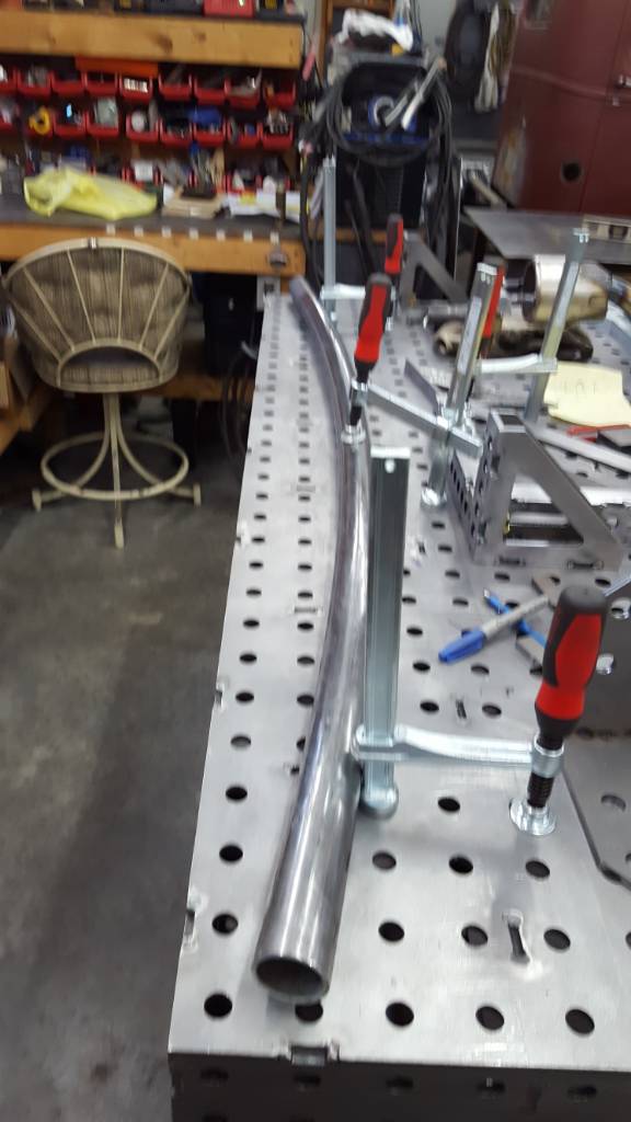

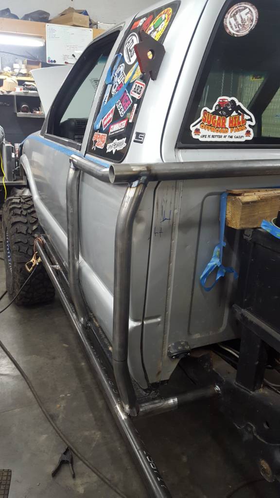

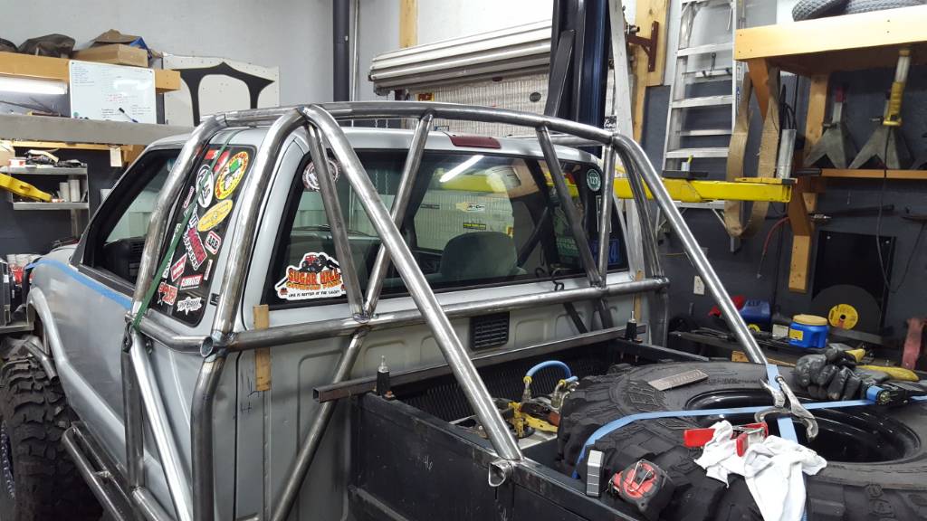

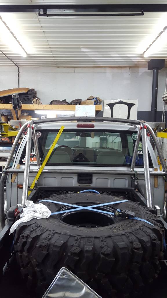

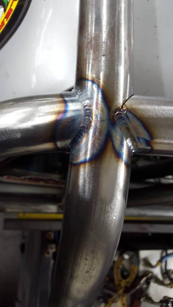

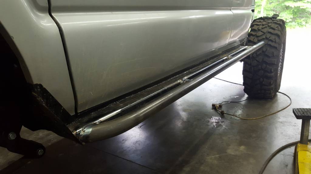

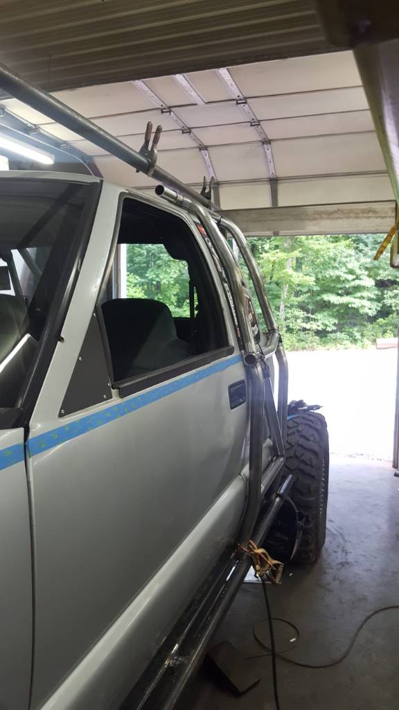

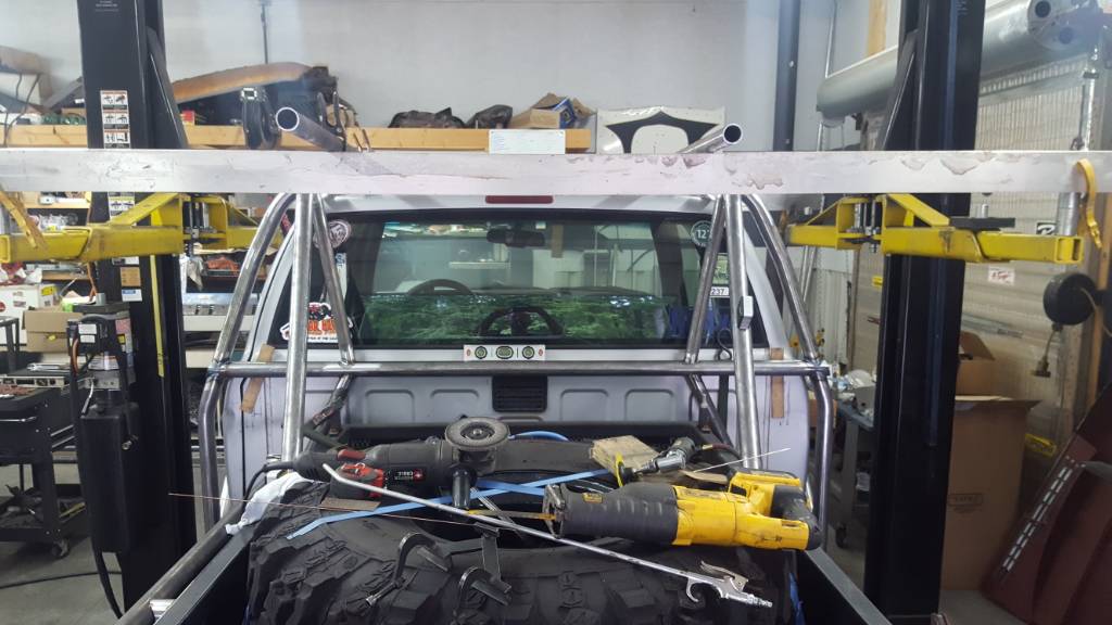

Looks like it so far, but are you planning to be able to pull it off to weld up, once all the bars are bent? Or you going to weld it on the truck?
Looks like what so far...?

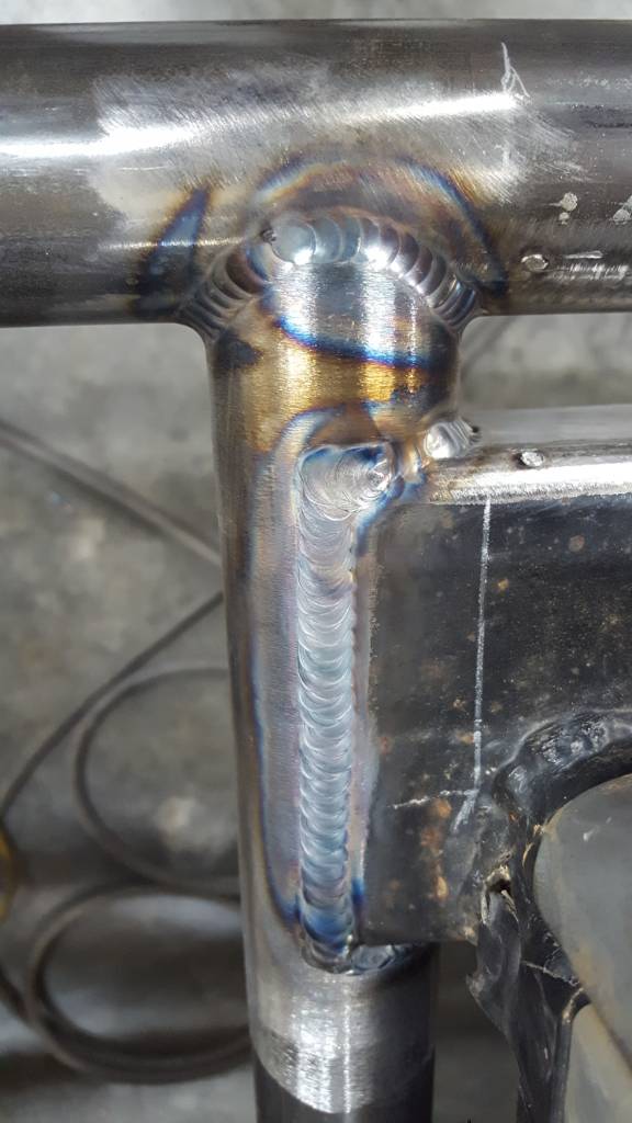

Of course it will be fully welded. I wouldn't design something I couldn't weld out.
The entirety of the cab coverage will slide out toward the bed, once the door post clears the cab it will be removed. The A post (which will be the last pieces installed - the front fender areas can be welded on the bench before final install of the A post) will not be welded in until the bottom side is welded... I only need 1.5" of clearance for the tig torch to weld the bottom side of the post copes...
Think modular...
... Roto head tig torch takes much less room than a mig gun, and I don't have to cover any glass or paint.
Think modular...
Sent from my SM-G925R4 using Tapatalk
I was saying it looked like what you've done so far would easily come back off the truck.
I didn't know if you were thinking to remove it, or had a way to fully weld without pulling.
I never had a question if you would weld it fully.
Looks awesome so far!!
