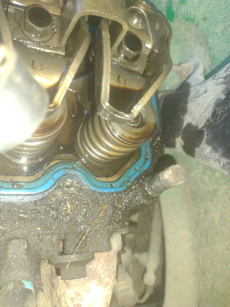

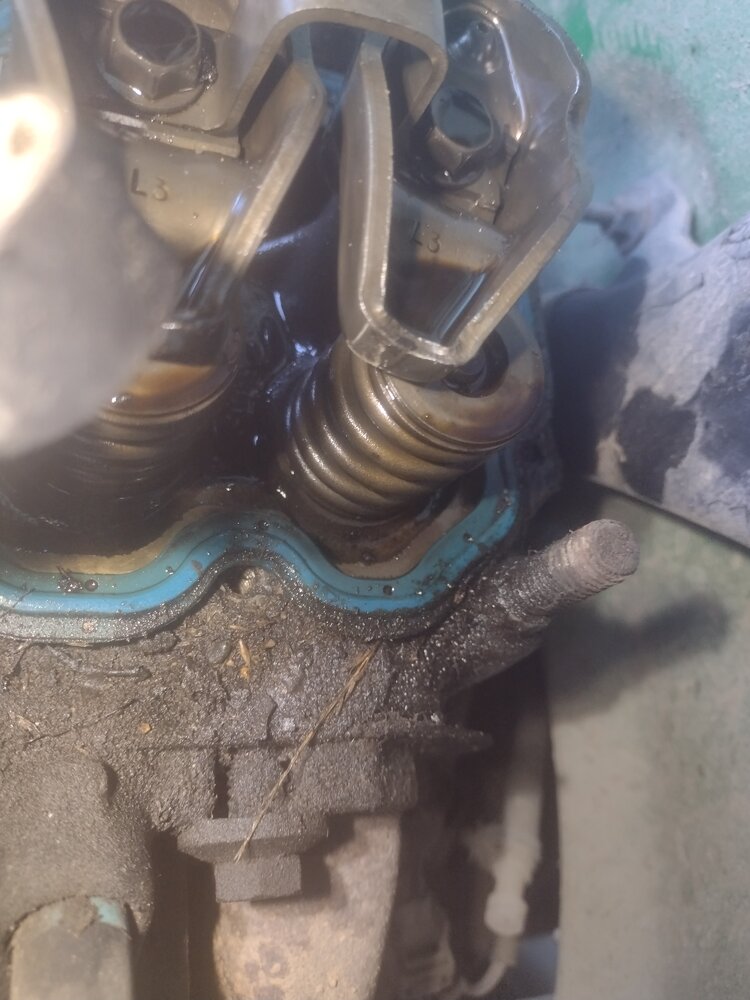

Jeeps fixed it was a loose bolt on the rocker that had it off center of the valve spring everything else checked out good I started it let it idle for 10min knocking is gone so far
Thanks everyone for your help I really do appreciate it
We Did It !!
That inspection camera I bought this morning was well worth the money saved time and unnecessary work taking things apart that didn't need to be good investment is recommend getting one if you don't have one
Thanks again
