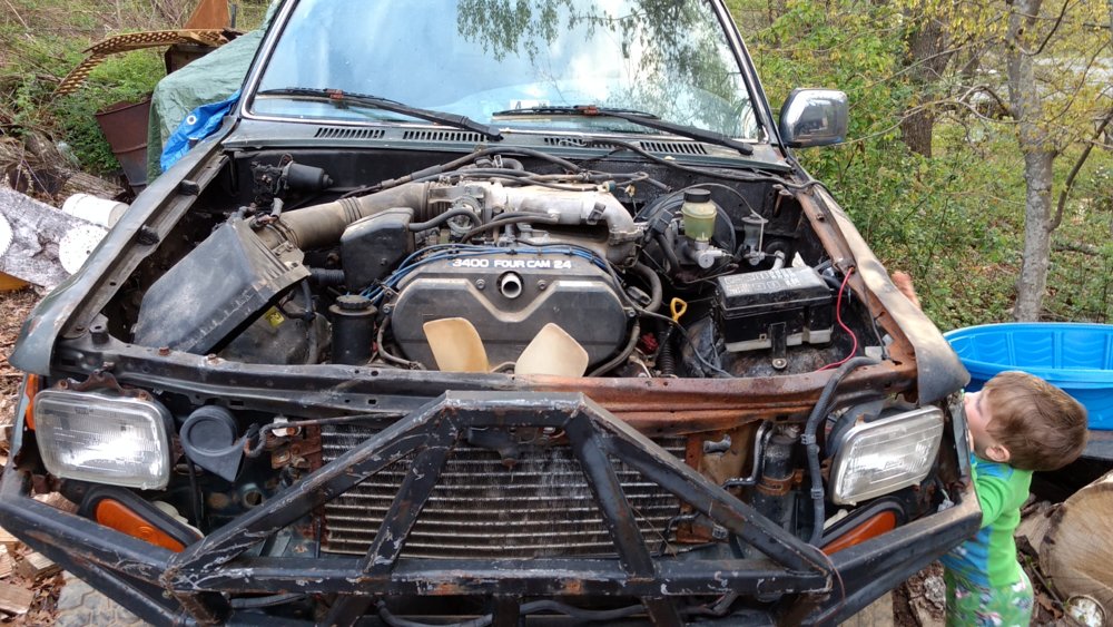

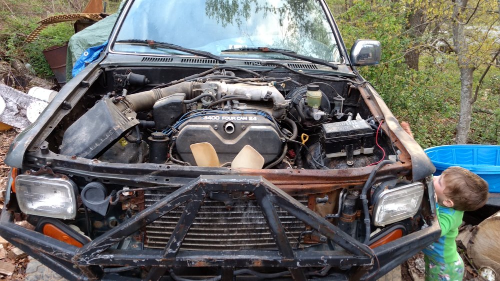

I had to take another look. From what I've read either a body lift or a big hood trim is required for the hood to shut on a gen 3 with a 3.4
What are you going with the high steer
Sent from my XT1635-01 using Tapatalk
Not letting go of anything right now. If I do, I don't want to split up axles air axle parts.
I my end up building two trucks.
Custom Marsfab cowl induction hood?
If @MarsFab wants to donate one and use the truck as advertising that would be great. I don't have Mars Fab cowl money, I've been buying parts like crazy.
I've considered finding a trd hood to graft a scoop on. A small body lift would help with attaining a flat belly and help with engine packaging.
I'm more concerned with packaging the exhaust crossover.

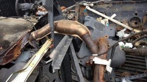

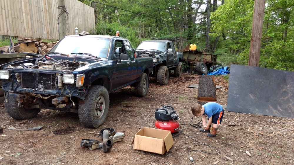

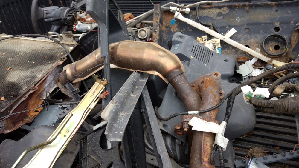

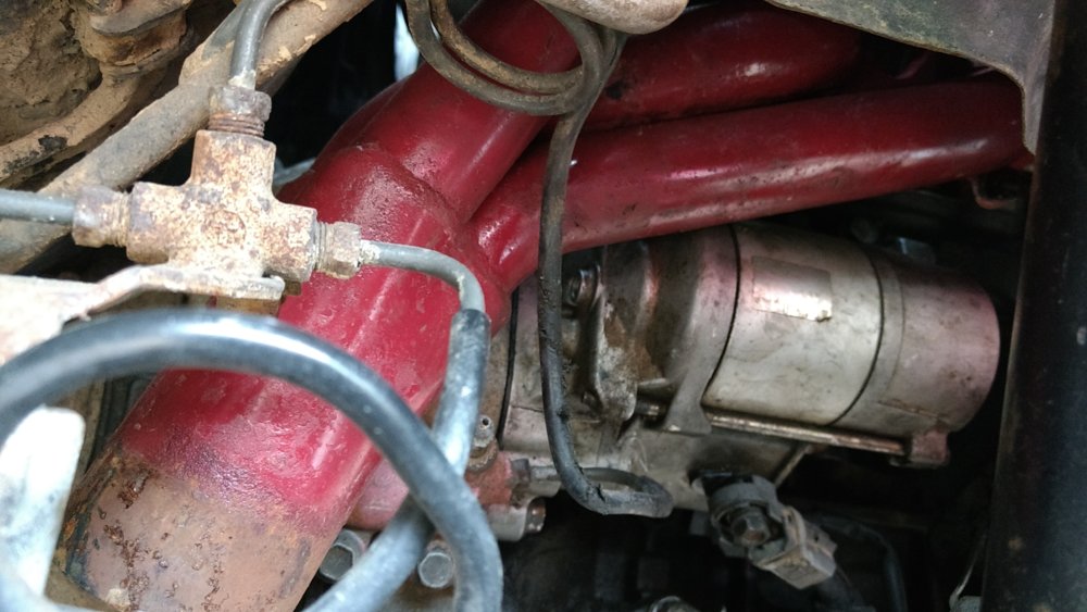

Took a second look at the new motor exhaust
I think this is the factory one sitting in the bed
Along with the ac parts for the 3.4, extra 3.0 radiator, the 3.4 radiator, 92 dash with extras and the original steering column.

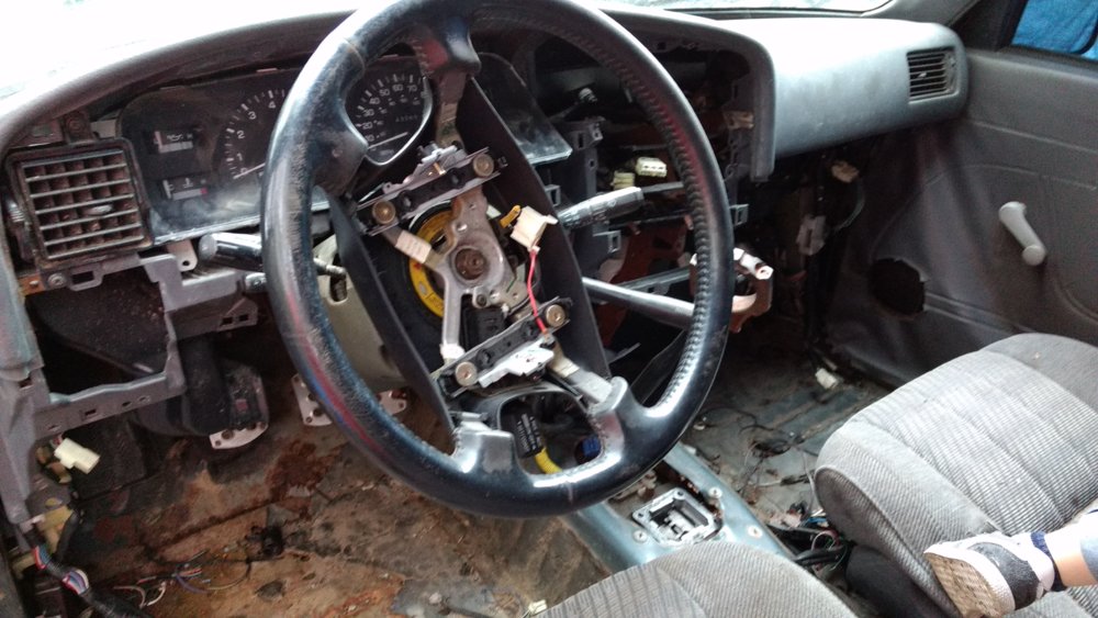

Engine is from a 97 T100 and the 92 has the steering column and the guage cluster off it
I think the newer guages with original interior for blue is where it's at.
Took a second look at the new motor exhaust View attachment 245742
That is deffinately the original exhaust in the bed of the truck. Those headers you have are high dollar.
I have all my part less some fluids, a clutch, and some new spring perches for the rear.

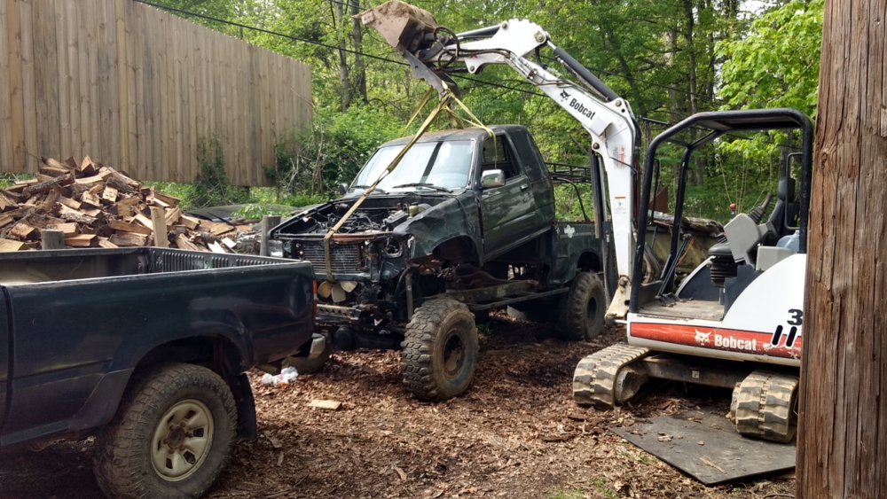

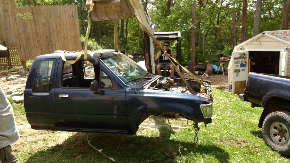

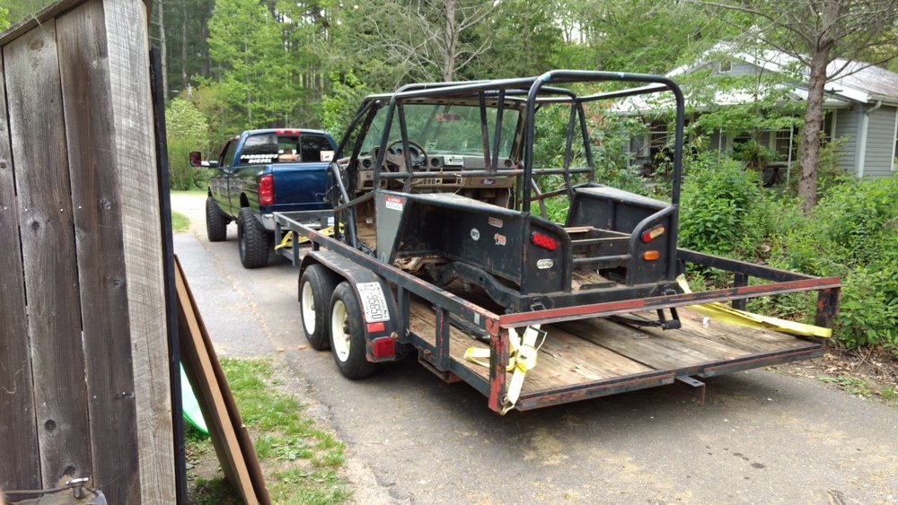

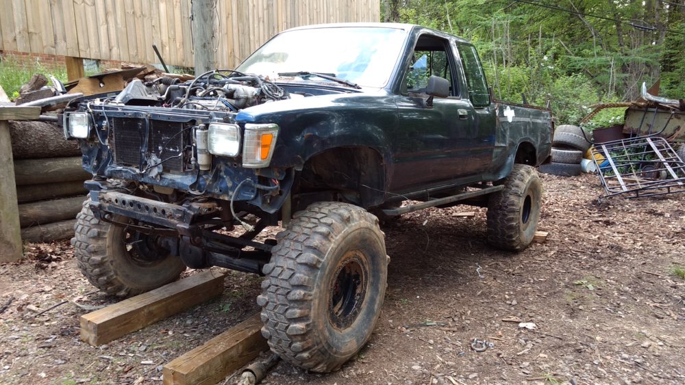

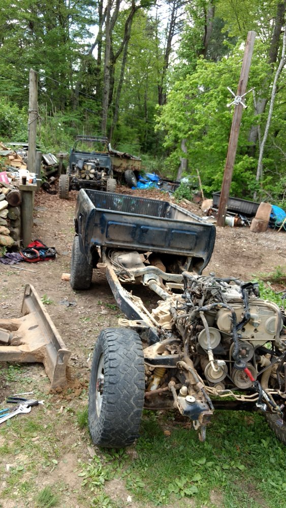

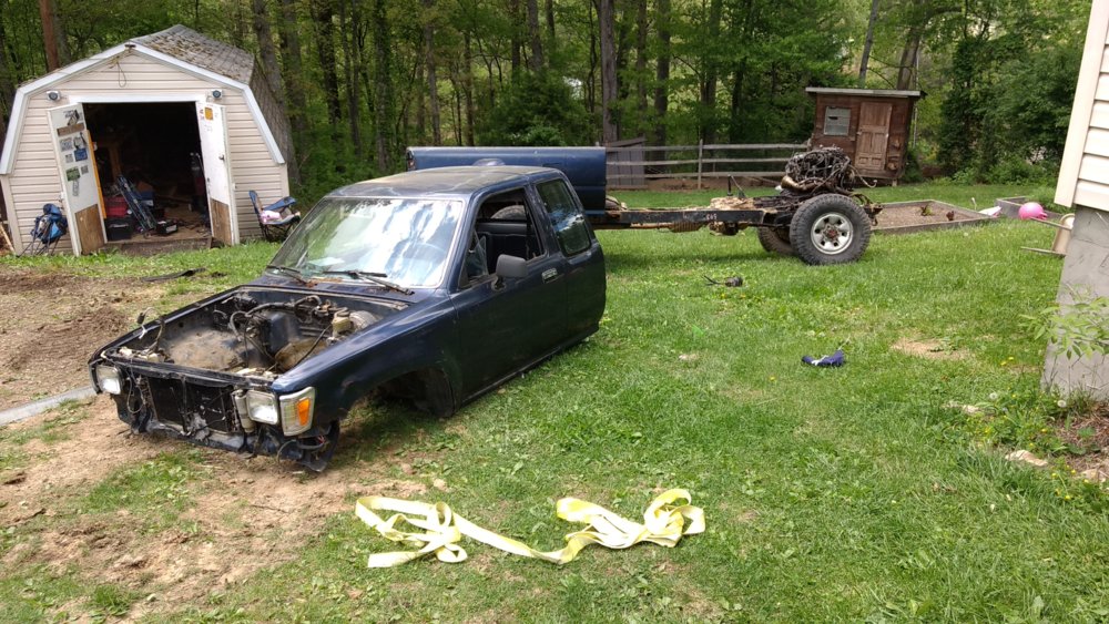

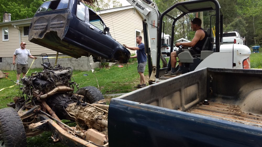

Preparing for cab swap with a mini ex tomorrow.
Blues 3.0 is disconnected and working on body mounts while the egg heats up for dinner.
Going to be a late one getting everything loose.

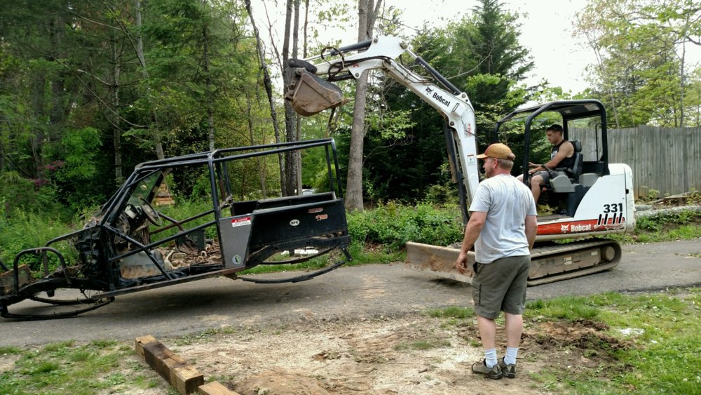

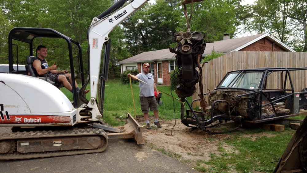

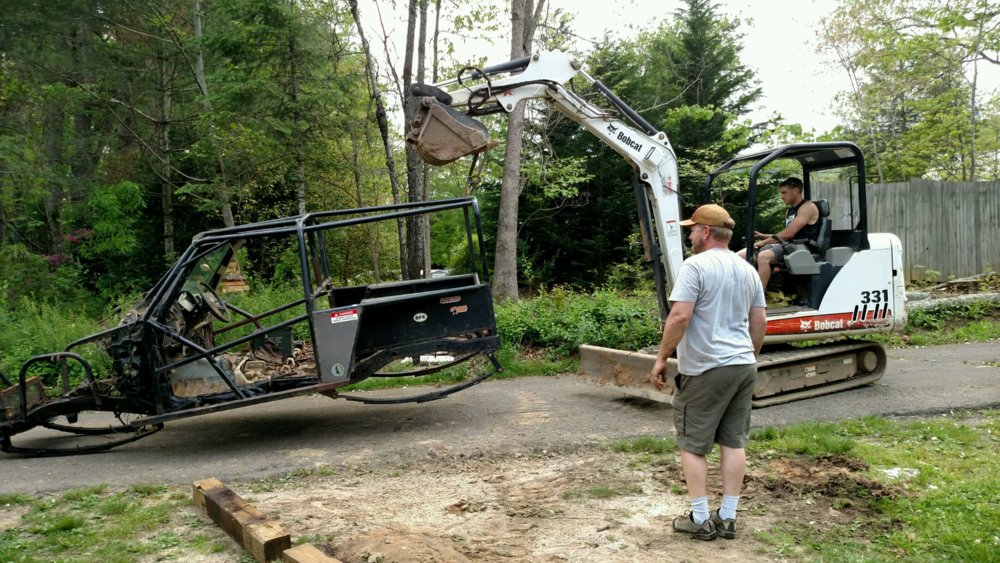

Motor and trans went to a friend who is putting in a FJ40.
And almost immediately a NC4x4 member pulled up for the chassis
So we loaded it up with mini ex
Probably keep the beat up bed for now and keep blues bed off to the side and work towards a bob when time allows.

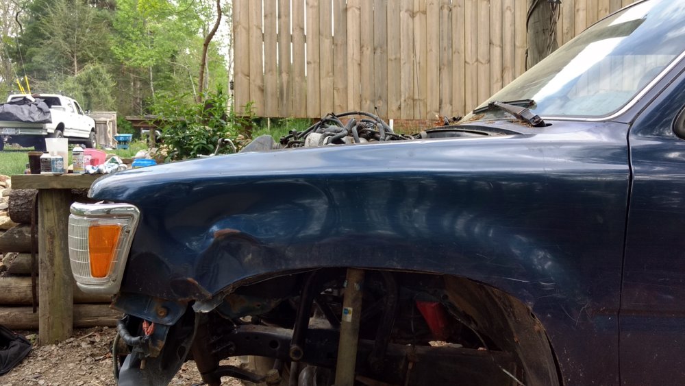

Good thing I have an extra hood to practice the cut because she's not getting a body lift.
It's approved

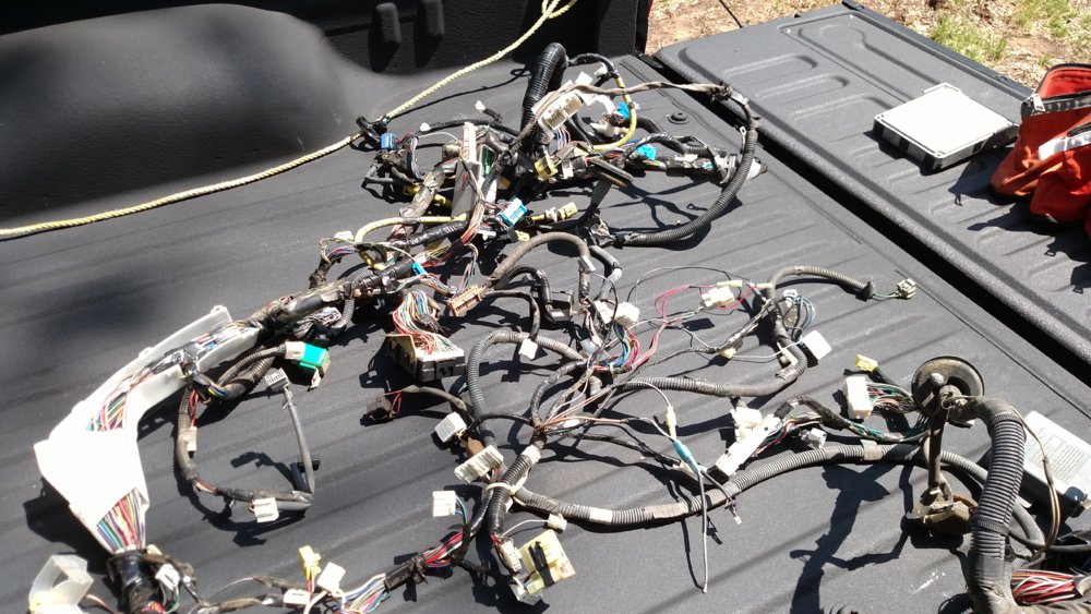

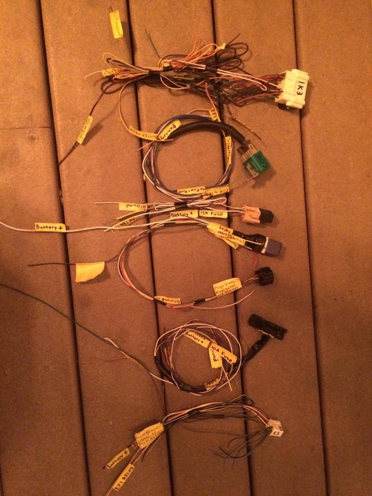

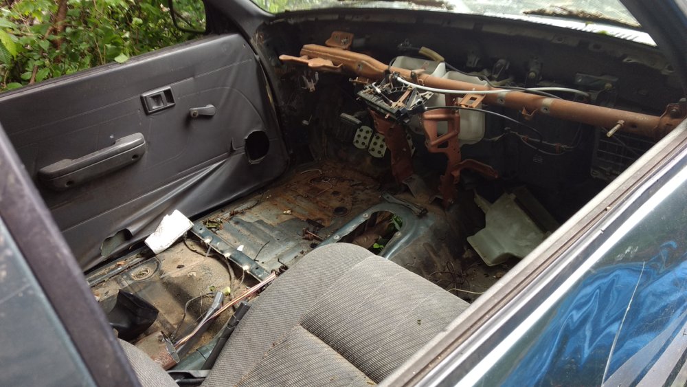

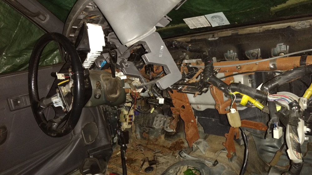

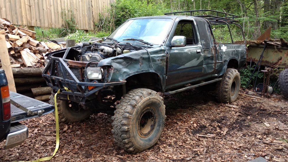

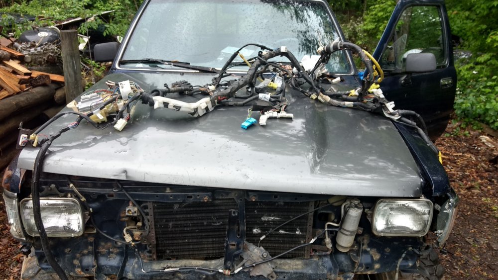

Finally have the dash harness pulled from the doner truck.
This crap kinda makes the overpriced conversion harness appealing. I really don't want to dismantle blue as far as it's going to take to get this harness back in.
