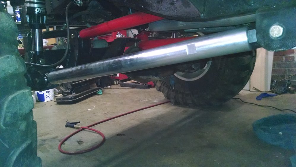

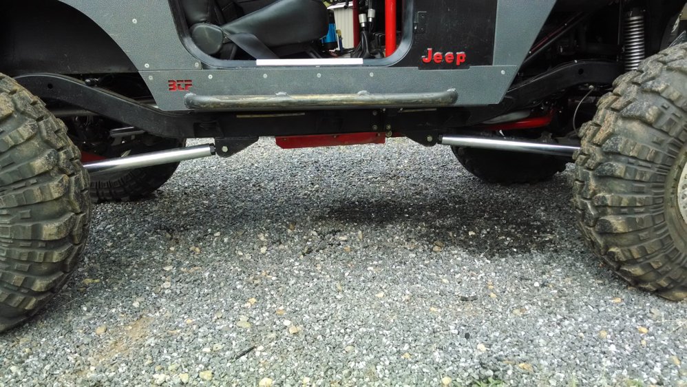

Also installed my front two new links. They look a lot better being bigger proportion wise to the jeep. I also won't have to worry so much about breaking a heim joint.
I woulda had the rears installed but they are about a half inch to long. I will have them turned down some in the morning and have them on tomorrow. I want it to be the exact same other wise my ORIs will hit the frame where it is frenched and I definitely don't want to have to re do that.
