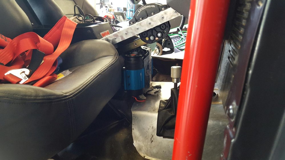

Air compressor is mounted! Was tough finding a good place for it. This was the best we could come up with.

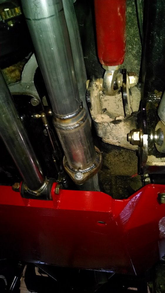

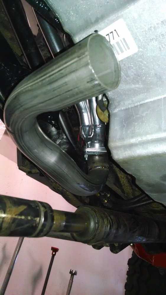

Exhaust is done! Loving the sound of it already! I thinks it's definitely different from everyone else's and that makes me happy.
Start of passenger side.
Drivers side. It Ys into the three inch before the connector flange on top. Just hard to see.

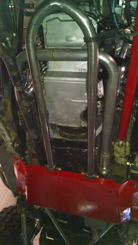

If you're wondering what the hoop is it is the soon to be finished oil pan skid.

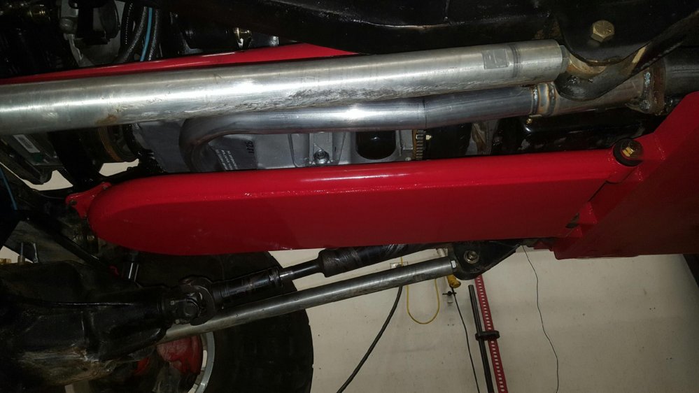

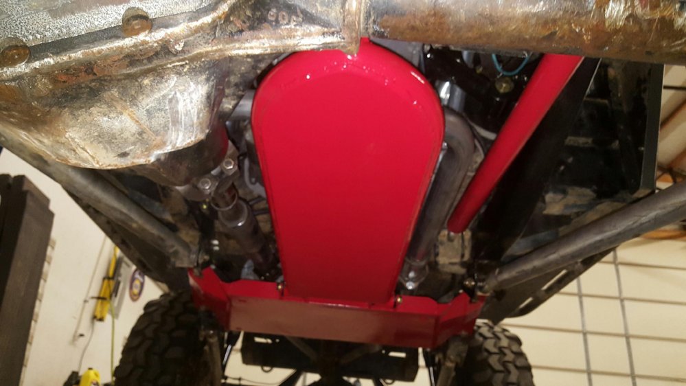

The oil pan skid turned out awesome!

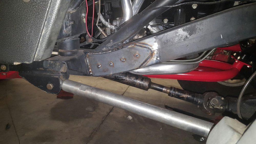

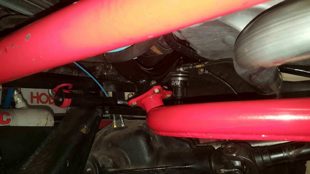

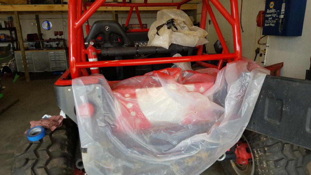

We figured since I'll have a little more power we might should stiffen the frame a little for some insurance. YJ frames have crush points just in front of the tub.
Hopefully a 1/4" plate on each side will help prevent the "crush"

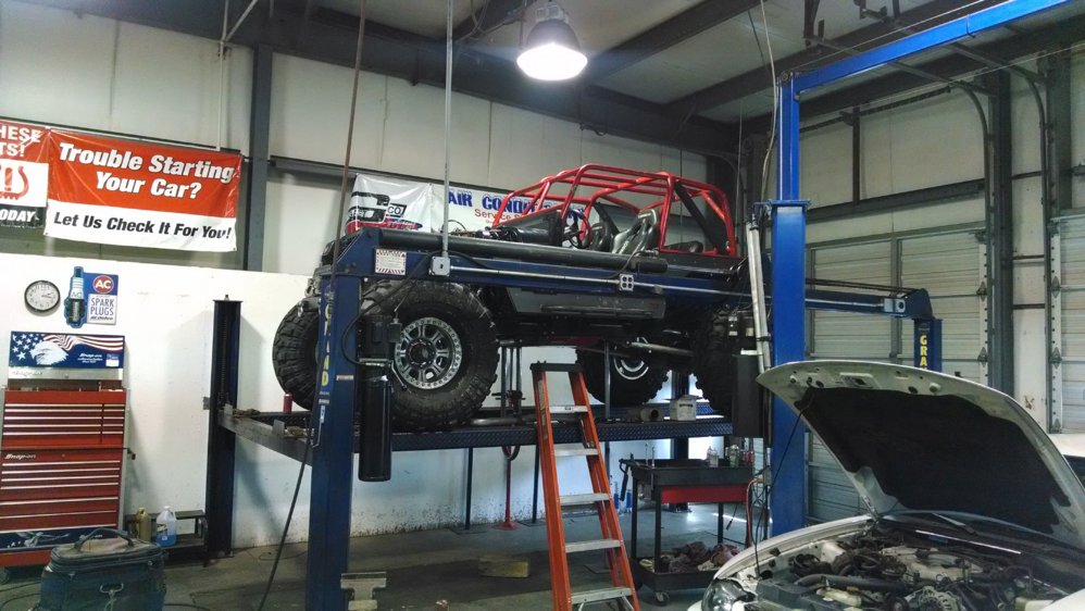

The "Pit" made it home today! A little more computer work and she will be right engine wise!
I also have to mount the rear seat, seatbelts, and wire up the front led light.
Oh yeah I also have to change out my lower links. Im going w 7075 2-1/4" aluminum and 1-1/4" heims.

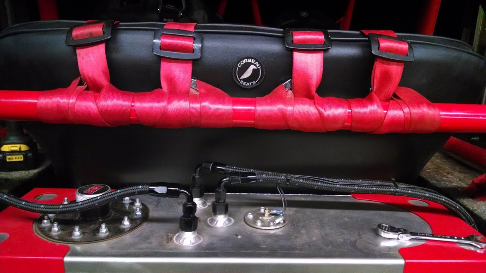

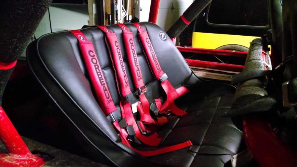

Well I think I will feel a little better wheeling with the kids now. Got the new Corbeau suspension bench seat installed and Corbeau easy release four point harnesses installed for the kids. This combined with cage padding and them wearing helmets full time should make them as safe as I possibly can short of sitting them out. They're getting old enough now they want to hit all the hard stuff with me. I'll still set them out on the real crazy stuff but maybe they won't have to walk as much now.
The harnesses were so long. Instead of cutting and sewing I opted to just wrap them around the bar and the ends are bolted.

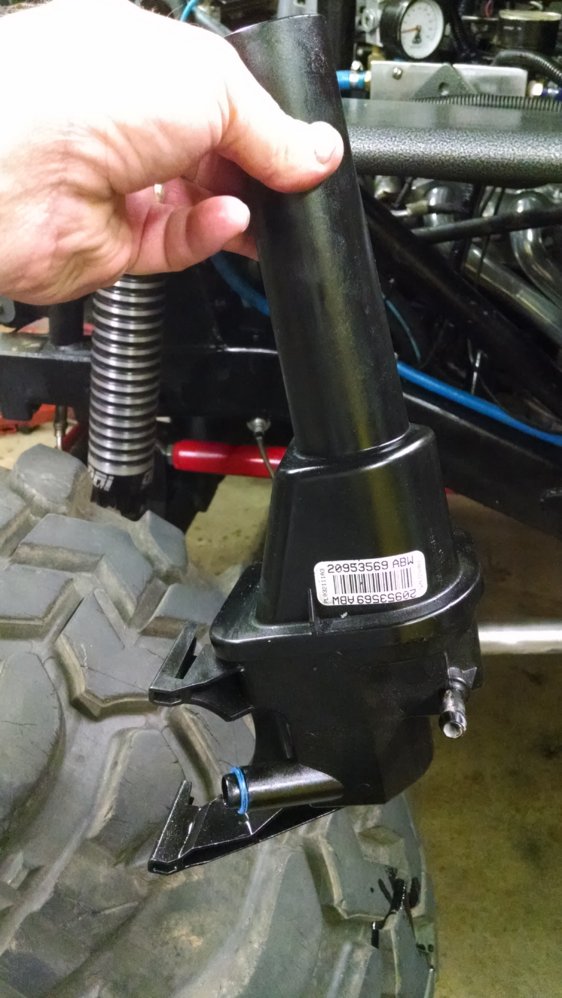

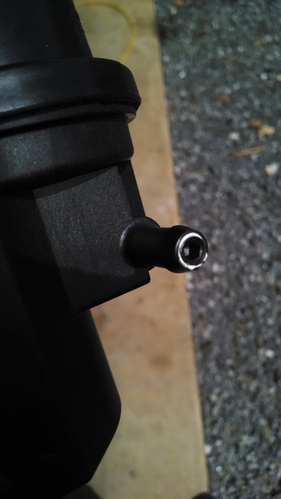

In the mean time I've had to install a new PS reservoir due to a small hairline crack that leaked just enough to piss me off. Between all the moving around and taking in and out of vehicles I'm surprised that's the only problem I've had.
I also installed a new lower steering column bearing that has been bad forever. No banging and clanging anymore!
Old reservoir
It being a hydroboost pump I only needed one return so I had to tap the bottom return and installed a set screw.

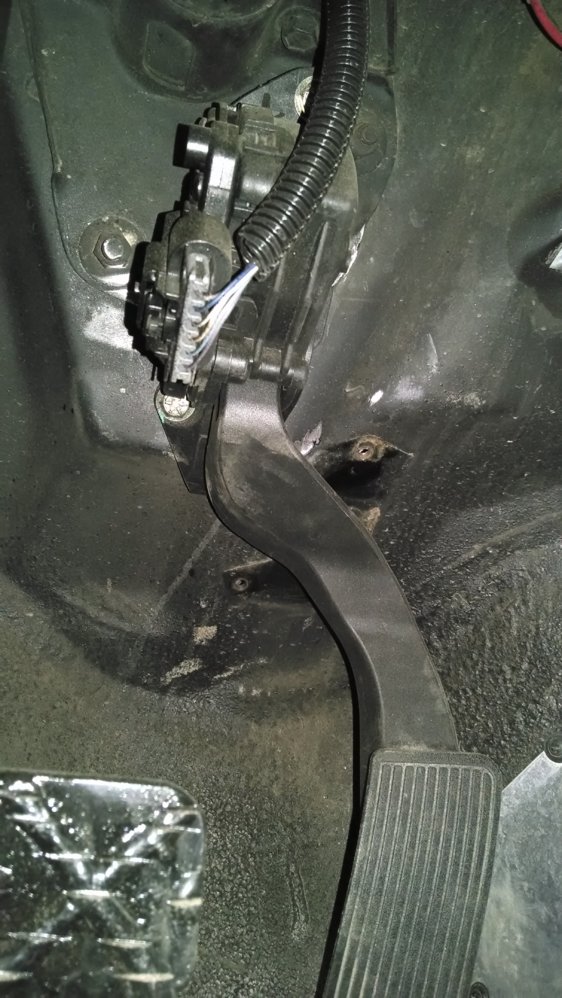

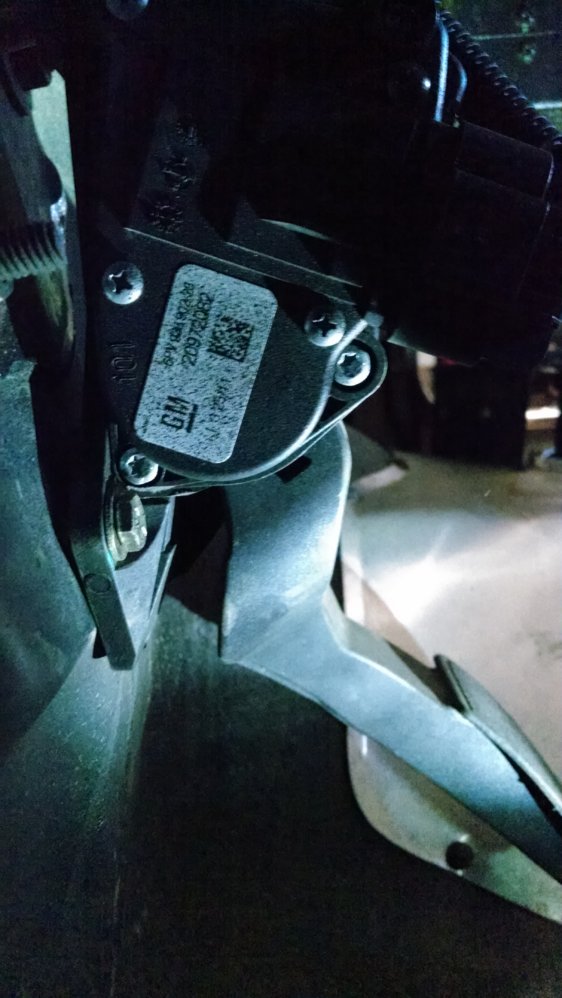

Never thought about that. Will double check. Thanks. This one has the control built in the pedal.
TAC module, IIRC. I greatly prefer a cable drive over a DBW for reasons such as these. There's also no chance of having your gas pedal stop working on you!
However, it should be an easy fix.

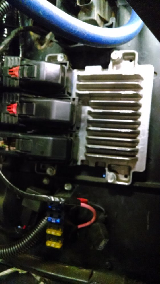

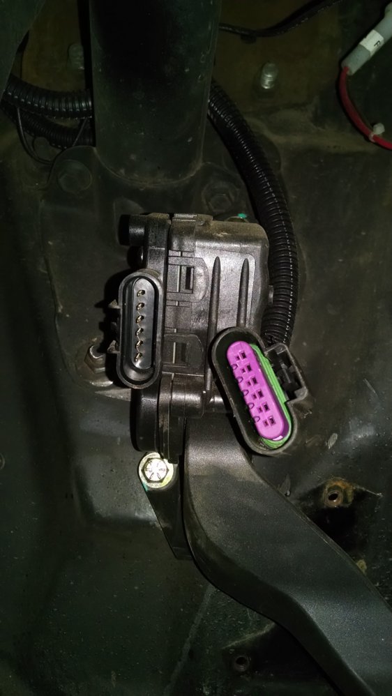

Yes the TAC module, pedal and Ecm all have to be out of the same year/ be compatible. There are a number of different tac modules and a couple different pedals. If you have a chance, post up a pic of the pedal and connector, tac module and connector and what year the ECM is from. Run in to this problem all the time on the fly by wires. I may have a couple extra modules and or pedals lying around. I had a good link bookmarked on my old computer that showed a couple of the different modules and pedals and made identification with part numbers pretty simple. I will see if I can dig it up. 04 different from 05/06 are different than 07+ etc

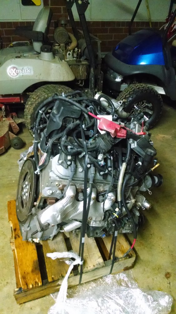

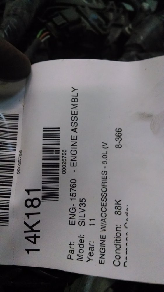

-2011 L96 gen IV 6.0 w/ 88k miles from 3500 silverado (already bought for my b-day)
-Jim's Performance tune and harness

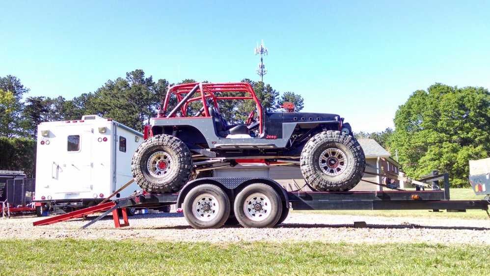

I also bought a new tow pig w/ sleeping quarters yesterday I'm hoping to have finished by spring also. I may start a build thread on it shortly.

This is a new beast to some of the programmers. It's a 2011 model L96. Most haven't done the newer stuff. It has an E78 ecm.

I'm not sure what the TAC module really does but if it's what I'm thinking it is built into the pedal on this swap.
This what you need?
2011 L96 6.0 E78 ECM
