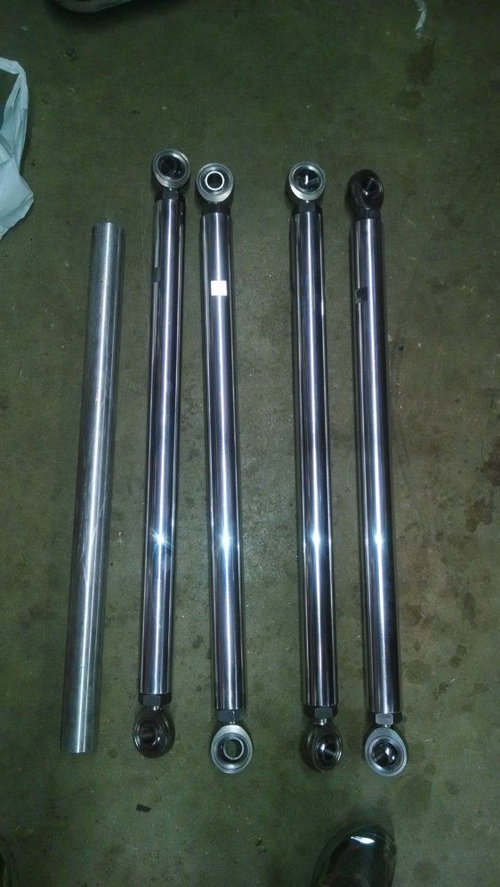

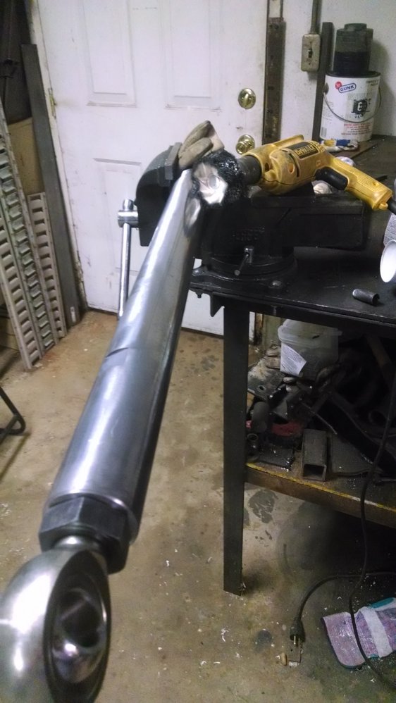

In the mean time I got my new links built. 2-1/4" 7075 w/ 1-1/4" heims.
A wise man once told me if you polish you links and put tire shine on your tires it will crawl better. Guess we will see. Reminds me I need to buy tire shine tomorrow
I figure if it won't run right might as well make it purdy.
The far left piece is for comparison. The pic still doesn't show the polish real well.
BTW the far left piece is for sale. 2-1/4" 7075. About 30" long.
