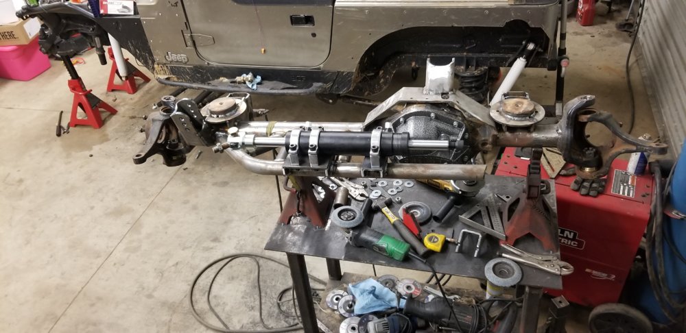

Finally had time last week to get the axle cleaned up and in process of building. Shop is a disaster right now due, been busy ever since AOP with other projects. Hoping to do a deep clean after Harlan in August. Can however see one of the new wheels in the back seat of the Jeep.
cqQHvMUsqp_TpZiU5-mf1CJbXQ5bYH-XsBIwuIfSWutJqwaVGhRzMDjj9IiPn8elBLHGI-vd6gyGa5yrdyjq3DI0_zidYnwqXtH6Qiti4FKwO8T3xwSaU77u3hGNt7TMlJCtKt6r8MeXlMV0bhlm3fdNpUF9BMjSGEtlgkAQY7LOIel7lcVW0iR25clAYOV4v87b7VbDCM8FUnlyhb2KRtyJ_DFcmMBuYQL2mt0Nlpe3jUSHndCBLAxhs0LhG8qxjMCIkk_i8Eo_avGoAEa4JO1BlwF3sSOftNM-hjaxcjudLgTET_T77s4NwrwRDnRrZ64BzqDhBOp6XaD_6Zbkpj9GsMxlhUsQ7gvx3V26CSNBsPA2riTuMJ9Vb4V1677vTaFlyf2d4zABi6WLPtz_skiyROOGcqIH2FSOpPWQ9TEBd1n-OvQaUEWbuQwQ8aaP1DrUEO35Nnz-RRKptk8nsrhbXyZgdhQXK9Ne68RtehuQFUgWwwqruhI5TUHc_Z8HK8eiWQ1f7iObBzI8aCNJ1GQC74tC_zr8PFnDHw1i52IMAArGD0YqdPBT99H5DYIY3fg_1a3621CO6FP3qnK97RQBQlJ0d-L2dtvodQxa6o0-M63w5iTccHNCYOBQJCYqorAIAbBW0-U9pVYe5of4P8qxpdRsabg=w1284-h625-no

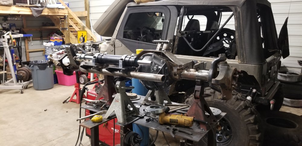

Gonna chop the shock brackets off and use tabs. Since I'm going full hydro I decided to try and stretch the front out as much as I could. Mock up right now has me at 105.5", previously was 103" Picked up some knuckles from @amcjeepman this weekend (old ones were trash) so hopefully I can get this thing as a driver in the next couple weeks. After the front is done I'm gonna pull it out so the rear can get some 5.38's swapped in.

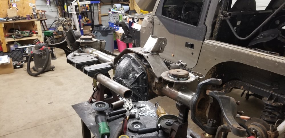

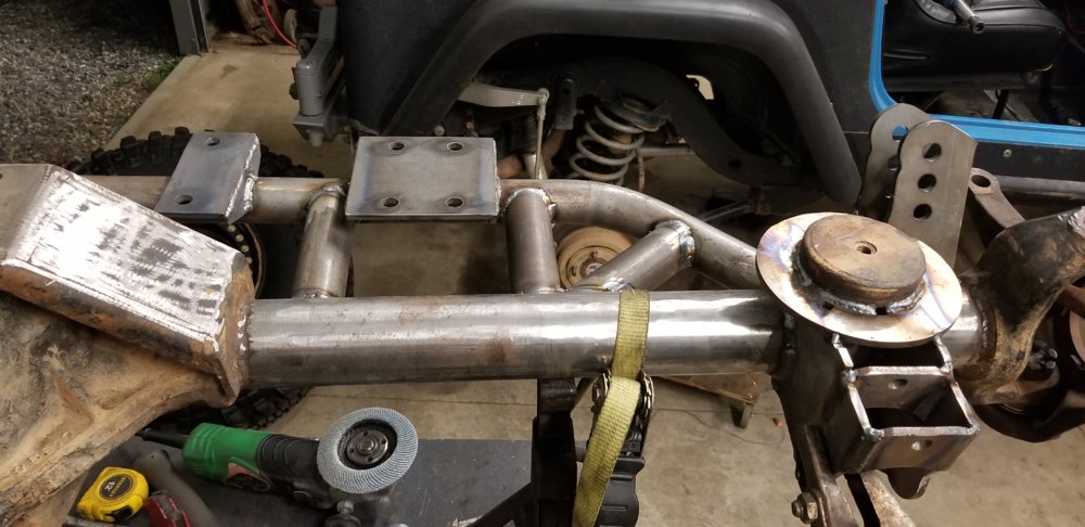

@adamk and I made a little more progress tonight. Got the shock mounts figured out and then pulled the axle to get the ram mount worked on. Didn't take a pic of the first try, had the main tube way low. Knocked the tacks off and now its ~3/4" higher than the bottom of the axle tube. Have to work on the ram pads later this week. Only gonna run 3 clamps so i can get the ram more centered. Lots of grinding and fitment left, then tons of welding.
Chris_Keziah
Joe Dirt @ Rev Limit Fab
Dec 1, 2010
Winston-Salem
Lots of welding, then some fab time, then more welding. Could definitely tell I was out of practice and couldn't ever get in a good rhythm till I was almost done. However I got the ram mount about 90% done, gonna add some gussets to the tubes tomorrow, cut off and cap the excess and hopefully get some primer and paint on it.
