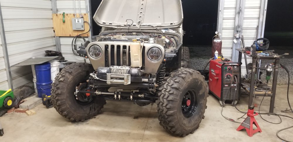

Productive night in the shop today. Been at it since about 5:30 with two parts store runs. @77GreenMachine came over to help out some and to stupidvise our senior shop bitch @adamk
The front is pretty much done, still have some tidying up to do and figure out an actual coolant overflow. Steering is freaking awesome, just under 3 turns lock to lock.

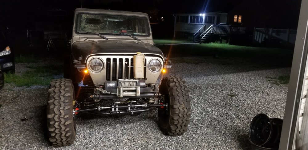

Closer and closer to being ready to wheel again. Really happy with the front suspension travel for only a 10" shock and who knows what springs. Full Bump on Driver front and Passenger rear, gonna have to be careful at full bump and steering lock, sway bar is gonna be all up in the tire.

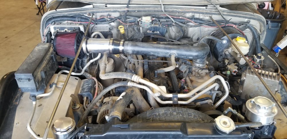

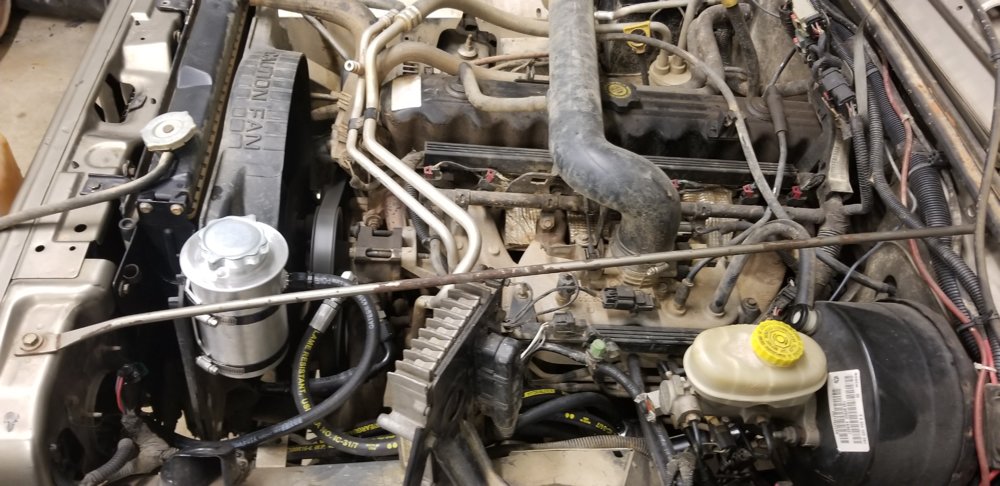

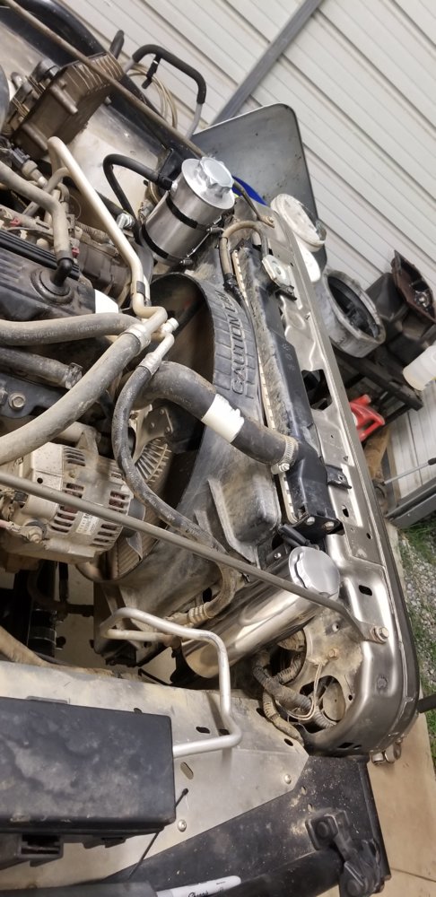

Ordered a air filter and prefilter plus the stuff to adapt it to a TJ intake tube, not gonna have enough room for the stock intake box and a coolant over flow. It'll be in Friday and I'll get that buttoned up. Gonna take a break from it tonight and get the rear 5.38's tossed in Thursday or Friday night after it cools off some.
Got the shop mostly cleaned up tonight and the Jeep backed in. The coolant overflow fit nicely on the passenger side, popped some holes in the rad flange and mounted to it.

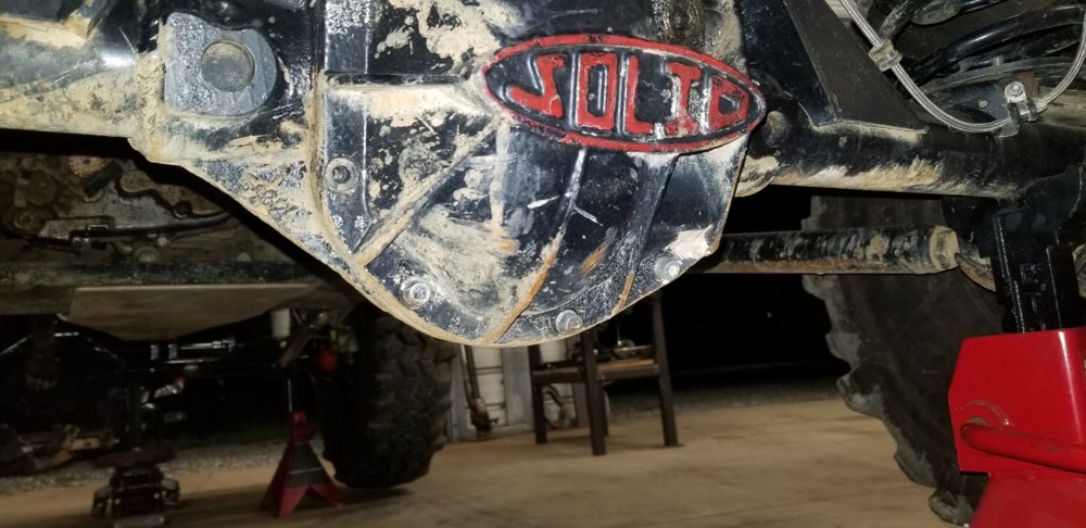

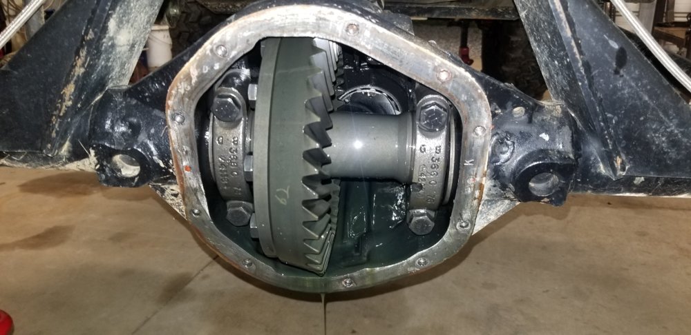

Went ahead and got the Jeep up on jack stands to nut and bolt everything and get the rear gears done. Got the rear cover cover pulled, bottom 3 bolts were fuckered had to use the good Irwin channel locks to get them out. Opening the cover exposed a little surprise, I'd say the carrier preload is a touch light.

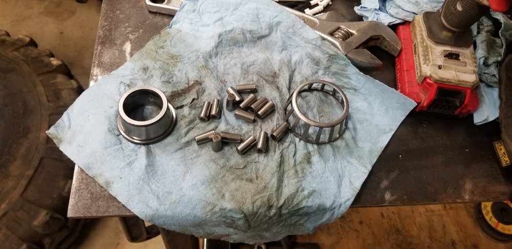

Plan for Friday night got fuckered early after I fubared the pinion bearing with the bearing puller. Then got sent into a panic because I couldn't find it in stock anywhere. I mean how the hell do you not keep an inner pinion bearing for a 44 in stock.
Ended up searching a little more and found one at the Auto Zone in Winston off Silas Creek. Being it was after 10 I just did an online order for the bearing and a few other supplies I needed.
Woke up this morning with full intention to go to the parts store early, which did not happen. Got there at 9:30, spent way to long in that store because the employees there a fucking idiot's.
After that painful experience got back to the house, loaded up the 4.0 out of Corner Jeep to take @Lankford for a YJ he bought and dropped by David's to pick my battery charger up. All this running put me back home around 3:30-4 which meant it was 10,000°Frankenstein with 500% Humidity. Said fuck working in the shop I'll hang out in the a/c till dark.

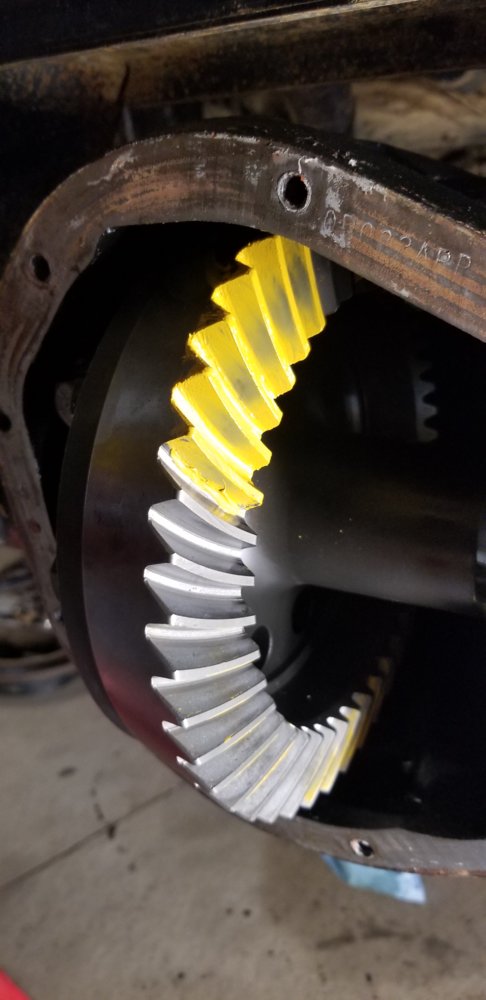

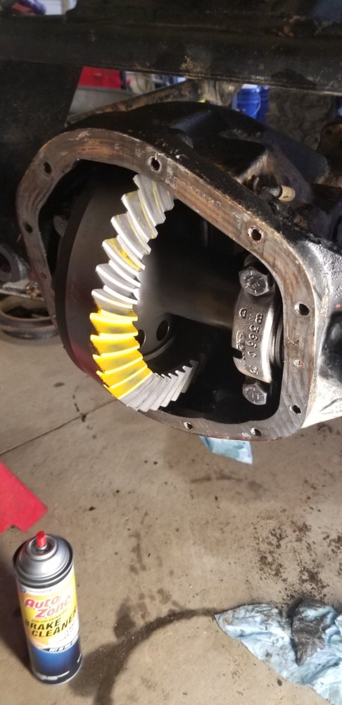

Got out to the shop around 9 after I got motivated to move and got her about 98% done and ready for Potts. Got the gears in. Putting the axle shafts back in I got pissed off trying to fish that damn plate on the studs so I did a parking brake delete since my e-brake cables are long gone.

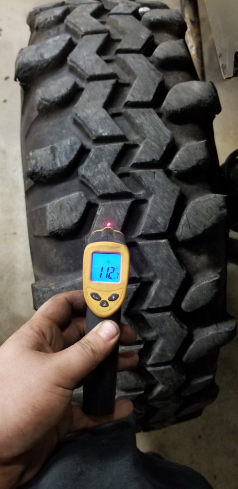

Got everything back together after a parts store run for one more qt of gear oil and some diff cover bolts I was ready for a late night sketchy test drive.

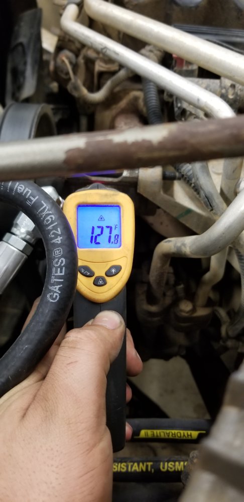

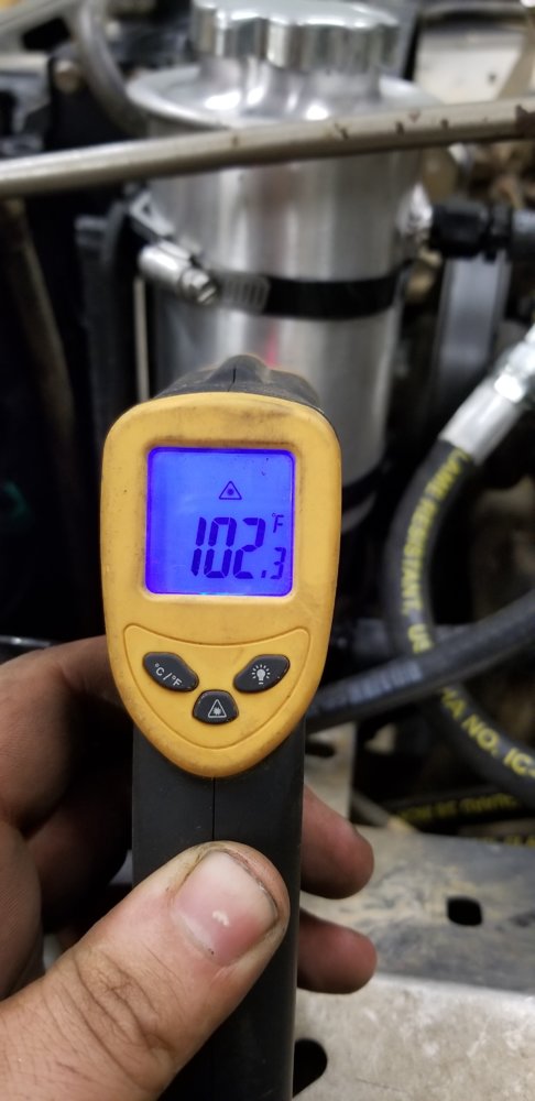

Put about ~15 miles down, about 20 mins of drive time. Jeep drove surprisingly well, still a slow gutless turd with 5.38 but marginally better than before. Holyshit did I forget how loud and drony this bastard is on the road. That Borla sounds great but with the TSL's singing the song of their loud ass people and the exhaust drone in the mid 2k rpms I'm really glad this isn't a daily. The full hydro and play within the steering column coupled with the ever changing steering center was a bit odd to get used too. Was easy to control up till 50, any thing after that could get twitchy easy if you put to much steering input in.
Amazing how warm these got, this was a few mins after I got back.
Steering stayed cool and didn't puke any fluid, cooler read mid 90° on the temp gun. Pump and resi were a touch warmer. Both axles stayed cool as well, front pinion was at 150° and rear at 175°
I over filled the front diff so now there's some gear oil sprayed on the all over the frame and coil on the drivers side. May have to put a catch can on it till she decides she is done puking. Only bad thing to report from the test drive is the passenger rear shaft is leaking, probably just got some dirt in the seal. Hopefully it'll push out and stop leaking soon.

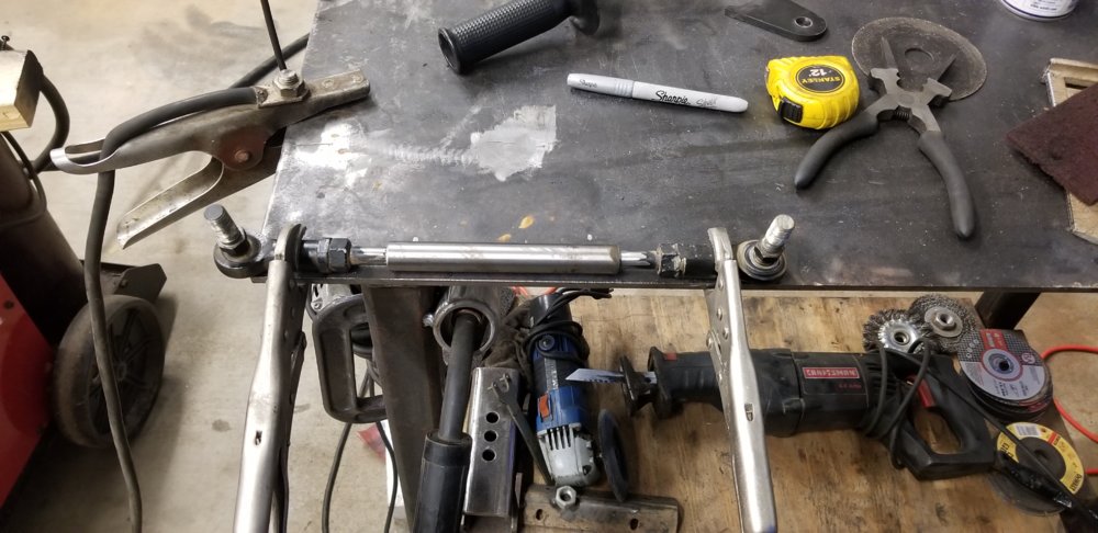

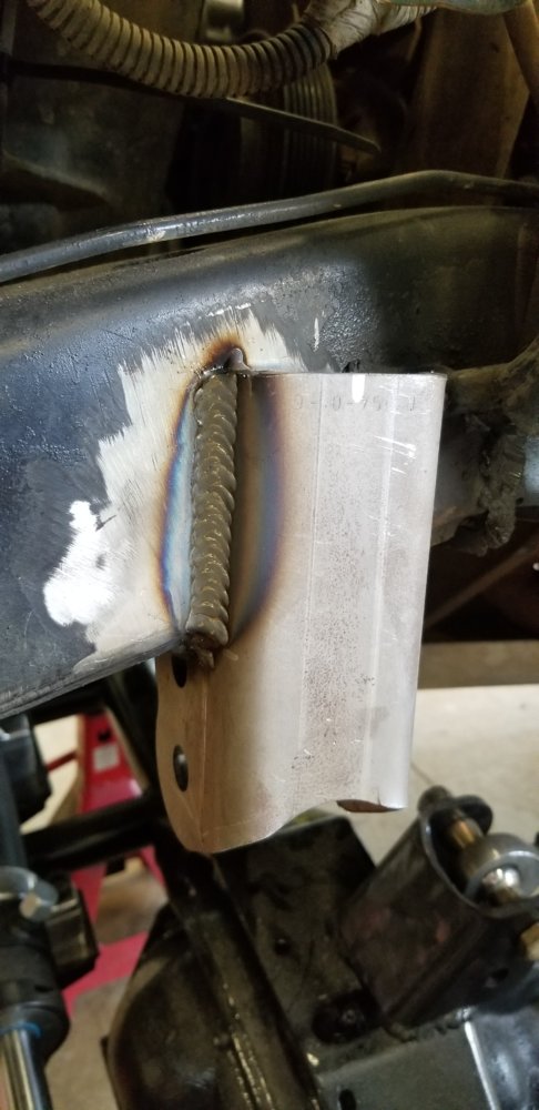

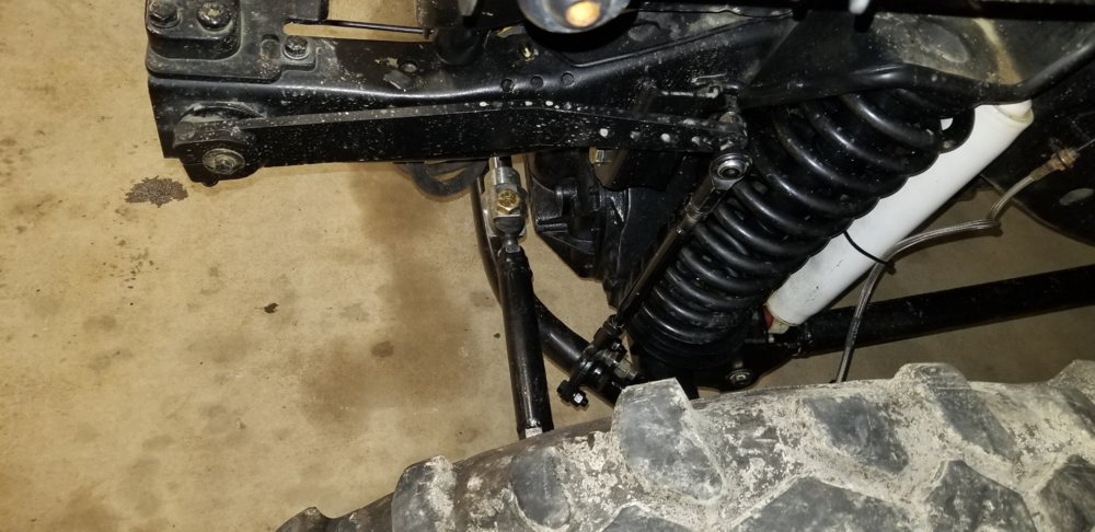

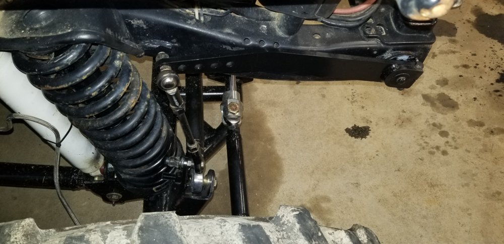

Got the sway bar finished up and installed. Really wish I did the mounts when I was still in the "fab" stage. Weld prep sucked, positioning was meh, so the welds reflect that. Easy fix, just take the pictures further back.
Had to extend one side since it was mounting much lower than the other.
Yes, that is a lug nut on the bottom joint. I dropped that nut and it took off and flew to china never to be seen again.

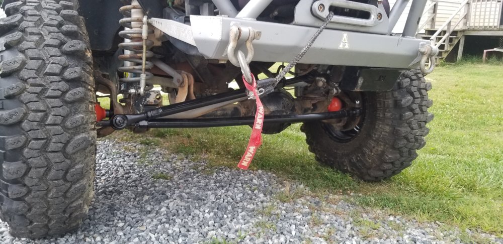

Still have to fix this mangled mess, lesson learned on sway bar links at an angle. Shit will work, but only once.
8pqvRvv0dyKzpezqlCIfbSokaFQ_k0G3MyZA60OJJ53ul4ua-ULqBMAMUdZdwsODSWNrjm0hvF6kDkIj0z0mWHV1_P_rlpTqJOXG33ffUQcHlvxWoN2cC6H9puwkHQO9HN9JDFhp1IkKABAOnJWXEQbZNnpdYiQ18GIRacjng2NzV-fYdFAC_GxEjk4ueXuTDkyDRarhXAcya08VJOOIgDUfQfYo7pzCiDeKX5RWNb7_neaZCTuZvCA5PXWvQadVbvGRLS17HLcbA1C_K0Oo6zguAJseLWSqfzbmHFTsnX-UhFXEze6IGjVzNl5CtKv2ClYZI3KKInf56wX0stC0-DnZBWYXTmSGpKqvJZQEs6LasdpBFLN-xzLOVYQLJTx25ALvS6GWp0LLdNUXRWM3FHSS1BS7ILQgX4f-b7DBXwBgBjGRcFY-3iXMqMzUCBdmLXMwoEfDRphXSu5-Sck54QPfEWRomtT3bicFDN-fL189toG6e3T8-IczrZUfWHtyMGkfcpcRuTpfm1XQH9h7TdlL54FE7c7bSDG3ObYtrIIzDm-fS8qj25DkgJyUNGeOg3cuwebluVkvMTEs9gjM0YYYOa3TEcVBS7m6-6HfAlcjGDZzYNnU2PgCU0Yc5GHj2q_VSxa7M8_Dbf8-TfkhLJ1Ewxx7sXA=w434-h890-no

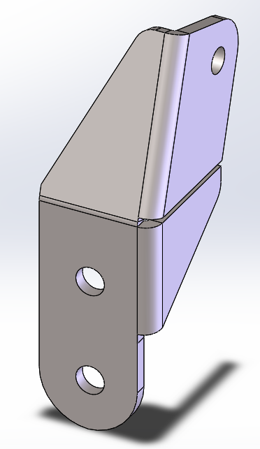

Planning to make a bracket to bolt to the front of the track bar bracket and move the mount inbound after I get the arm back flat/straight. Made this crazy drawing last night that hopefully I can decipher this morning.
