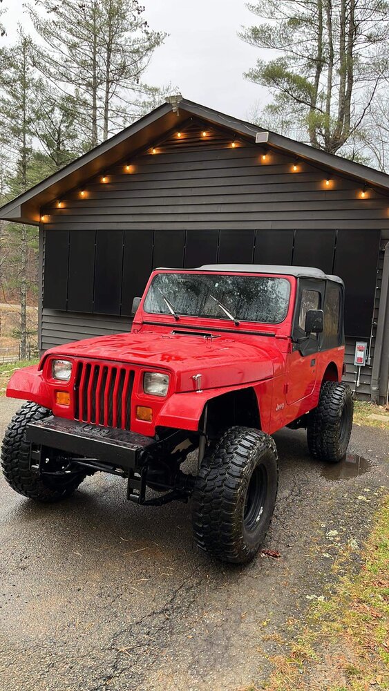

Just an update about the jeep, but no pictures.

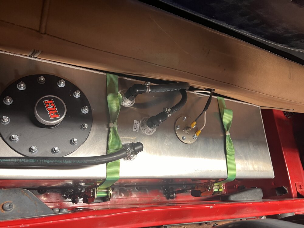

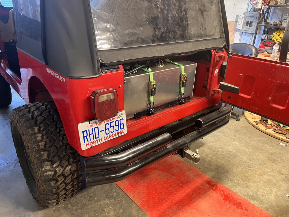

-I'm running a RCI 2161 fuel cell with a E8248 pump now < loving it.

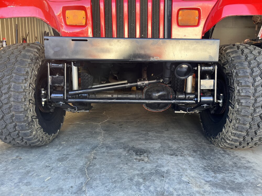

-Had Will @ Rightside build me a full skid from the back of the Atlas to about 4" short of the front axle tube with 1/4" plate, and cover it with 5/8" HDPE cutting board material. No more crumpling the stock skid and exhaust (or oil pan).

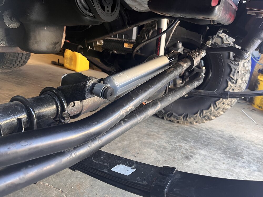

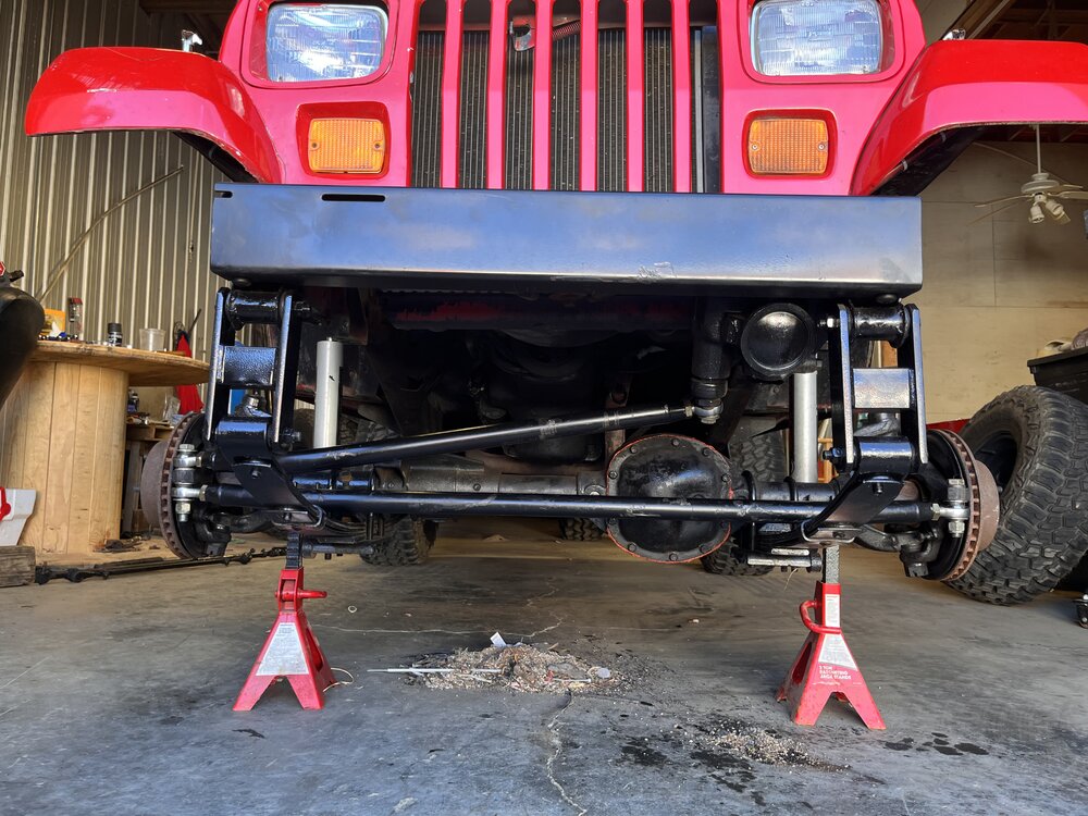

-Time before last at DPG I bent the stock steering, and then replaced it with the Ruffstuff Y-link steering kit that uses 1.5" DOM, .25" wall with 1 ton tie rod and drag link ends. Had to ream out my pitman arm and knuckles and then adjust my steering stops, but it's all in now and works very well. I'm happy with the new steering set up.
It will get wheeled like this until I need to do something else with it, but right now I'm loving the set up.
