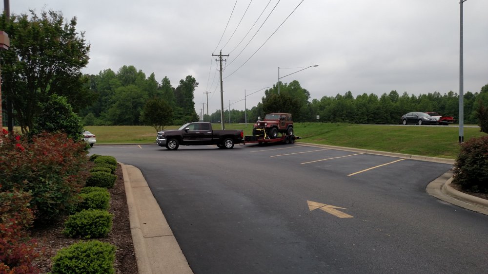

Put two nice new straps up front so the Jeep doesn't fall off the back when you neutral drop it at the red light in Troy:
And put one old shitty strap in the back to keep the jeep from rear ending the truck if you have to hit the brakes.
@ol'Jeeps reminded me I had these.
:flipoff2:
Wow...
I didn't mean to make an example out of this particular guy, BTW. I have no idea whose rig it is. But if you walk through the outpost parking lot on any given Saturday afternoon, you'll see this and worse.

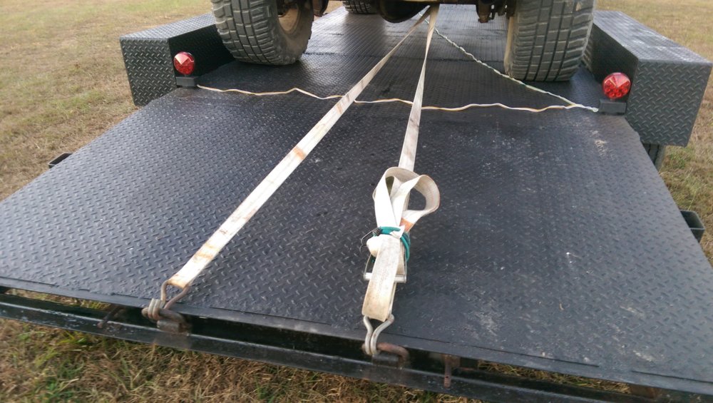

My front is similar to that, but I do have a front bed rail. Two straps on the front [used to run 1] & 2 chains on rear [used to be 1 centered]. So, at least I've doubled my tie downs.
Parked in 4 wheel low, 1st gear, & micro-locked.
[Only pic I got; doesn't show much]
