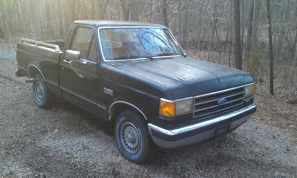

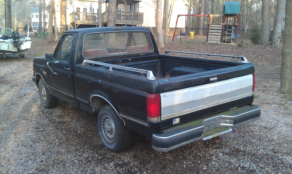

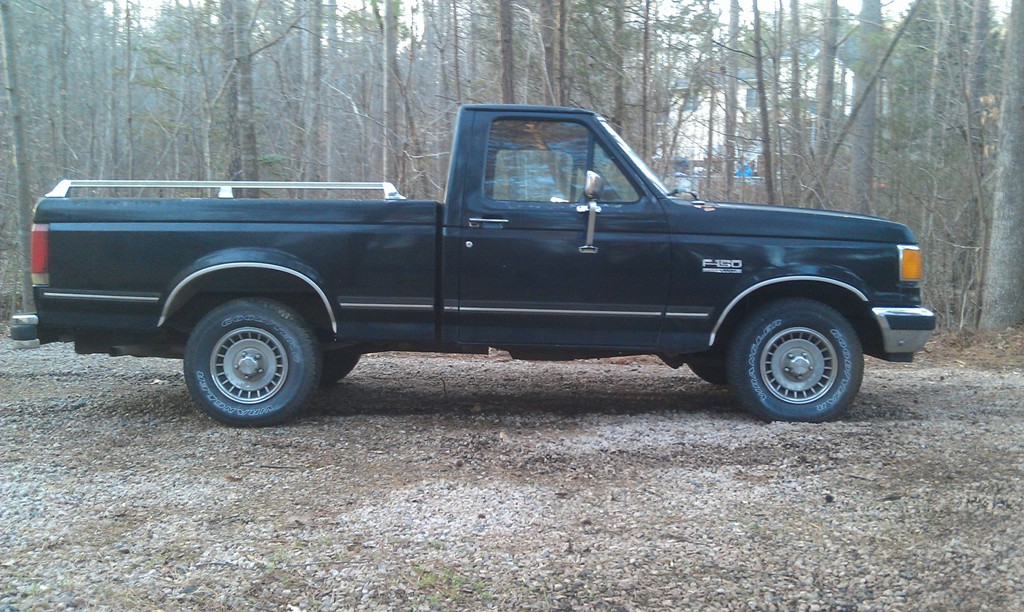

So here it is: 89 shortbed, standard cab F150 with an EFI 5.0L and AOD trans. Not crazy about the AOD, but will stick with it for now. The best part is that it is rust free and the bosy is perfectly straight.
Plans are to repaint it hot rod black, red steelies, red bedliner. It hasn't run in a couple of years, so I'll work on getting it running and then see what else it needs. Someone stole the cat off of it a couple years ago, so it needs that.....or not.....
Here it is in all its beauty.

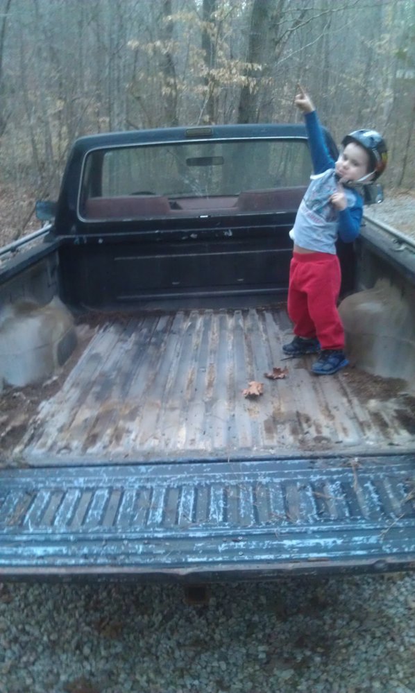

Oh, my son and I did get the drop-in bedliner pulled out. Surprisingly, the bed is in PERFECT shape. Couldn't believe it. Back when I did spray-in bedliners I saw new trucks that had worse beds due to drop-ins. Was pleasantly surprised.
And yes, he is wearing a bike helmet and his pants are on backwards. :lol:
