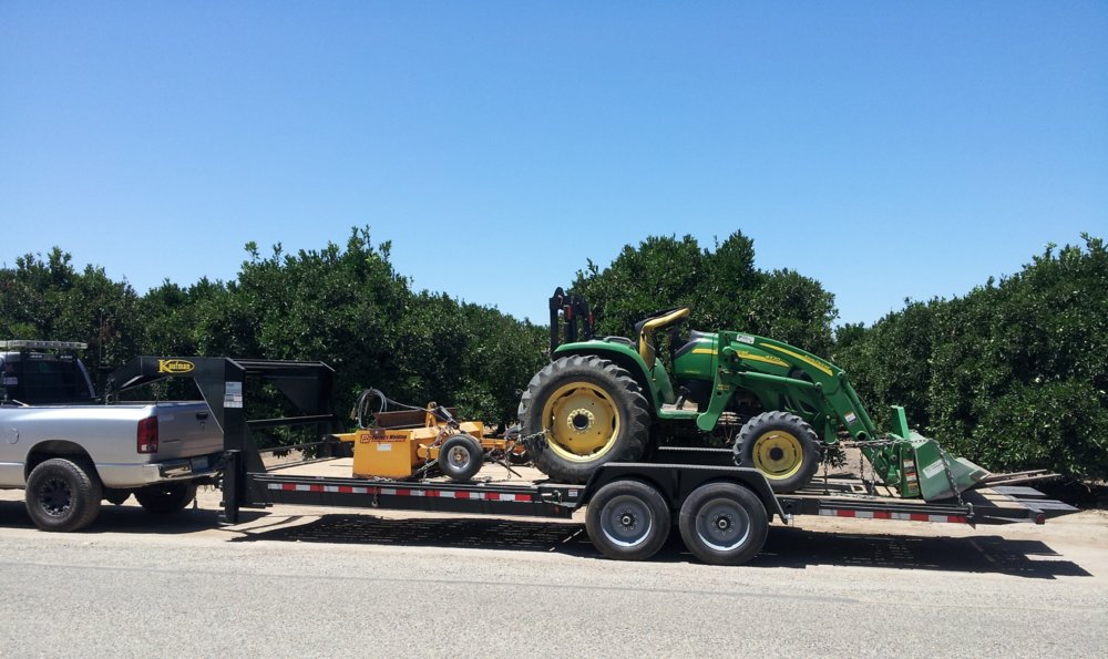

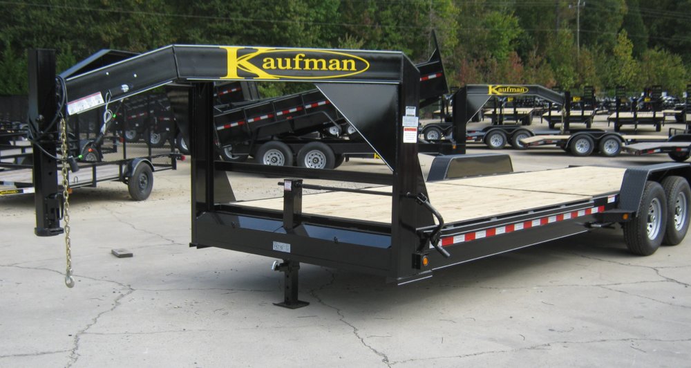

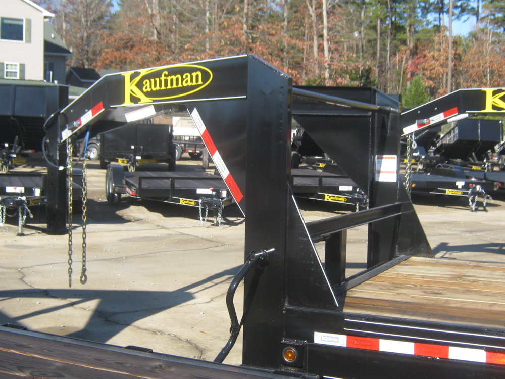

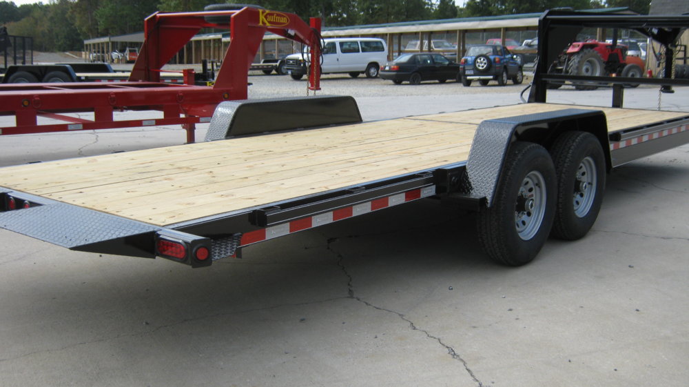

This is the trailer I'm looking at. The sales rep sent me the pictures. The one loaded with the JD is also an option with 8k axles and 17.5s, but I'd probably just roll with the 7ks and 16s. The extra capacity would be nice, but I think it's 1300ish more.
